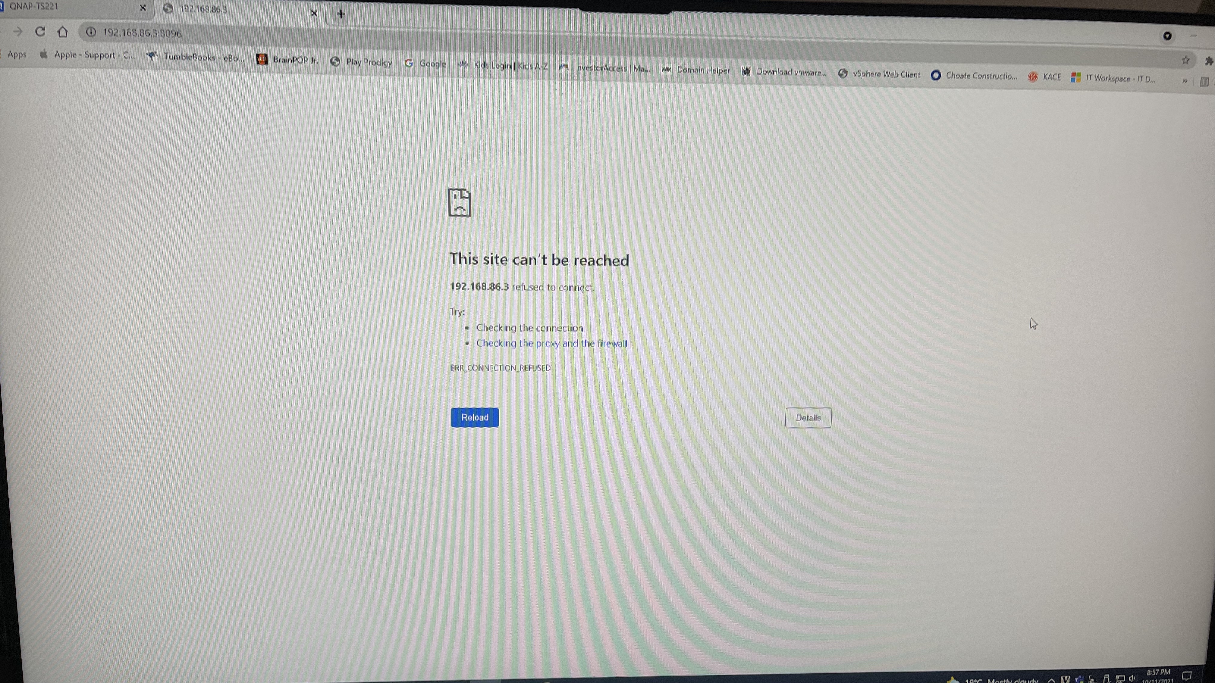

jsa288 0 Posted October 12, 2021 Posted October 12, 2021 Hi Luke, I have Qnap TS-221 running on ver. 4.3.3.1693 I installed emby-server-qnap-mono_4.6.4.0_arm-x19.qpkg. Emby server is installed successfully and running when I click on Emby server it’s open on another browser but it doesn’t load anything. Please see screen shot. How do I fix it? Thank you

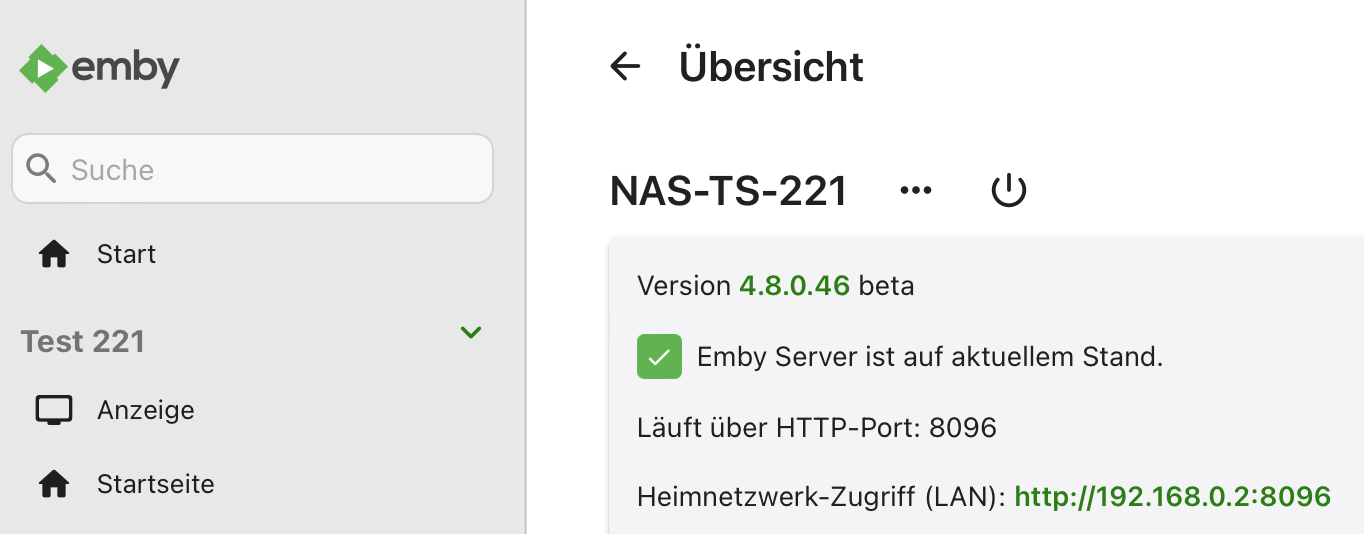

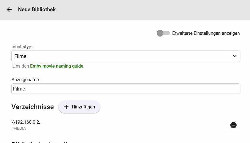

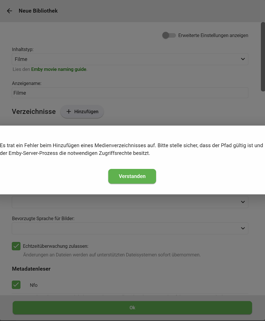

Anderella 13 Posted September 16, 2023 Author Posted September 16, 2023 Hi, yesterday I managed to undust my old qnap TS-221, reformated and installed from scratch latest firmware: 4.3.3.2420 Installed beta emby server: emby-server-qnap-mono_4.8.0.46_arm-x19.qpkg The good news: it's the first time, the server responded and I basically could get through the settings. And I can start emby and see the start page. Maybe I'm missing something, but I couldn't manage to add a valid media-directory to the server. As far as I remember, on my current qnap TS-451D2 the setting, add directory, immediately shows different folders and sub-folders to select, after connecting with ip and user/name & pw. On the TS-221 I couldn't get that far: Trying to connect to my server didn't succeed, mounted the media-drive to my mac-studio with the same settings worked. (so the folder is accessable) Enclosed some screenshots..... maybe you could point me in the right direction to continue:)
Anderella 13 Posted September 16, 2023 Author Posted September 16, 2023 Additional info: I also tried to add my media directory on my windows computer, same problem.

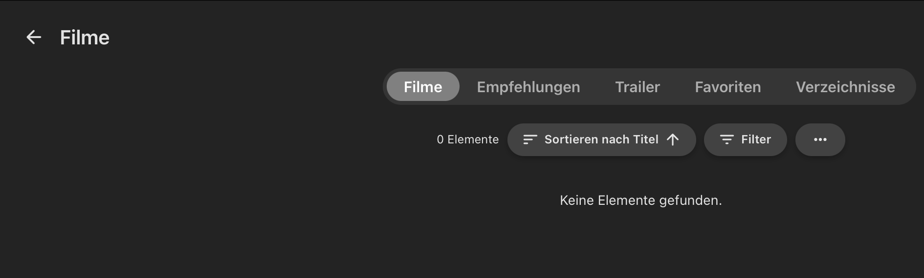

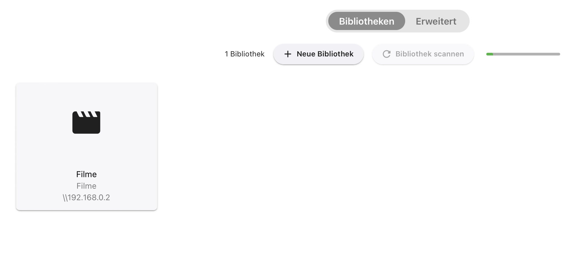

Anderella 13 Posted September 18, 2023 Author Posted September 18, 2023 Thx for your input, I also tried this attempt right now. No error message when adding the folder as source, but library still stays empty.
Luke 42239 Posted September 18, 2023 Posted September 18, 2023 23 minutes ago, Anderella said: Thx for your input, I also tried this attempt right now. No error message when adding the folder as source, but library still stays empty. What exactly did you do? Can you please show a screenshot? Did you run a library scan in Emby Server after doing that?

alucryd 318 Posted September 18, 2023 Posted September 18, 2023 (edited) It looks like your library is pointing to a samba share on 192.168.0.2, and not on a local folder, is that correct? The screenshot appears to confirm that, and the log is flooded with errors trying to access this very samba share. Also, this one's for @Luke, the log is full of error trying to create a port map, any idea what could cause that (probably a mono exception, in which case we won't have any choice but to disable it). Edited September 18, 2023 by alucryd
Luke 42239 Posted September 18, 2023 Posted September 18, 2023 22 minutes ago, Anderella said: Thx, hope this is the right one. (Besides I basically use the same settings and files-structure as on my other running qnap server) embyserver.txt 3.01 MB · 1 download Your samba share is returning this error: 2023-09-18 22:41:56.529 Error App: Error in GetFileSystemEntries for smb://192.168.0.2/_MEDIA *** Error Report *** Version: 4.8.0.46 Command line: /share/HDA_DATA/.qpkg/EmbyServer/system/EmbyServer.exe -programdata /share/HDA_DATA/.qpkg/EmbyServer/programdata -ffdetect /share/HDA_DATA/.qpkg/EmbyServer/bin/ffdetect -ffmpeg /share/HDA_DATA/.qpkg/EmbyServer/bin/ffmpeg -ffprobe /share/HDA_DATA/.qpkg/EmbyServer/bin/ffprobe -defaultdirectory /share/CACHEDEV1_DATA/Public -updatepackage emby-server-qnap-mono_{version}_arm-x19.qpkg -noskia -noautorunwebapp Operating system: Linux version 3.4.6 (root@U16BuildServer176) (gcc version 4.2.1) #1 Wed Jun 21 14:07:44 CST 2023 Framework: Mono: 6.12.0.182 (tarball Thu Jan 19 10:25:28 PM UTC 2023) OS/Process: X86/X86 Runtime: share/HDA_DATA/.qpkg/EmbyServer/lib/mono/4.5/mscorlib.dll Processor count: 1 Data path: /share/HDA_DATA/.qpkg/EmbyServer/programdata Application path: /share/HDA_DATA/.qpkg/EmbyServer/system System.IO.IOException: System.IO.IOException: Not connected to share. Status: STATUS_ACCESS_DENIED Perhaps it requires a username and password? Did you configure that in the dialog?
Anderella 13 Posted September 18, 2023 Author Posted September 18, 2023 Thats correct. The media folder is located on the qnap server (192.168.0.2), and it's the same address where the ember server is running. (On my other server 192.168.0.4 - if I add a library/folder to my library, the directory selections shows folders like: share/CACHEDEV1_DATA/..... for selection.)
Luke 42239 Posted September 18, 2023 Posted September 18, 2023 Just now, Anderella said: Thats correct. The media folder is located on the qnap server (192.168.0.2), and it's the same address where the ember server is running. (On my other server 192.168.0.4 - if I add a library/folder to my library, the directory selections shows folders like: share/CACHEDEV1_DATA/..... for selection.) If it's on the same QNAP machine then I would just use the direct local path to the folder rather than the network path.
Anderella 13 Posted September 18, 2023 Author Posted September 18, 2023 @Lukeyes, I configured user and password in the dialog.
Anderella 13 Posted September 18, 2023 Author Posted September 18, 2023 1 minute ago, Luke said: If it's on the same QNAP machine then I would just use the direct local path to the folder rather than the network path. Sorry, I'm not very familiar with that. How would it look like? (again: on my other qnap, I see folder suggestions and can click folders up and select the "right" media folder - here the field is empty)
