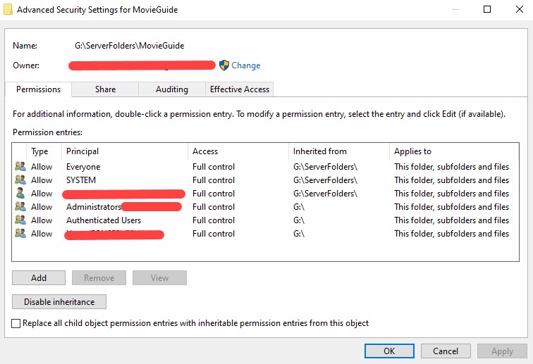

Carlo 4561 Posted October 5, 2021 Posted October 5, 2021 Hi, this would be a permission problem. Make sure the user running Emby has proper permissions at the root folder level and then have it cascade the permissions to all folders under it.
Skijackz 0 Posted October 5, 2021 Author Posted October 5, 2021 Hey Luke, Sorry, work is getting in the way of getting this resolved. I checked the permissions and they are the exact same as the folders that Emby is recognizing. What's crazy is that I haven't changed any of the permissions at the folder or file level. MovieGuide folder - Not recognized Music - Recognized I tried pointing the library directly to one of the movie folders and it recognized it when I did an individual folder but not at the main folder. Here is the structure I have the folders: ServerFolders (Main folder) MovieGuide - 12 Angry Men - 12 Angry Men.mkv The Abyss The Abyss.mkv Music - Main and sub folders recognized TV - Main and sub folders recognized HomeVideos - Main and sub folders recognized
Skijackz 0 Posted October 5, 2021 Author Posted October 5, 2021 I'm going to wipe the permissions from the folders and recreate them and see what I get.

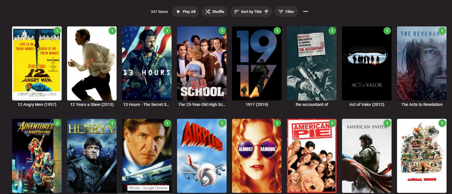

Skijackz 0 Posted October 6, 2021 Author Posted October 6, 2021 56 minutes ago, Happy2Play said: Unless you are using Mixed Content type you can not mix TV and Movies. So TV will only show TV ie no movies. In my experience, this isn't true. As you can see, this library is set to TV yet is showing all of my movies. See screenshot. Server logs added. Know that I deleted and rebuilt the libraries again just to make sure I wasn't crazy. Same situation as above. Just a note - I'm heading out on vacation until Oct 12th so I won't be able to respond but thank you very much for looking at this. embyserver.txt

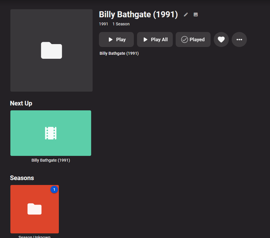

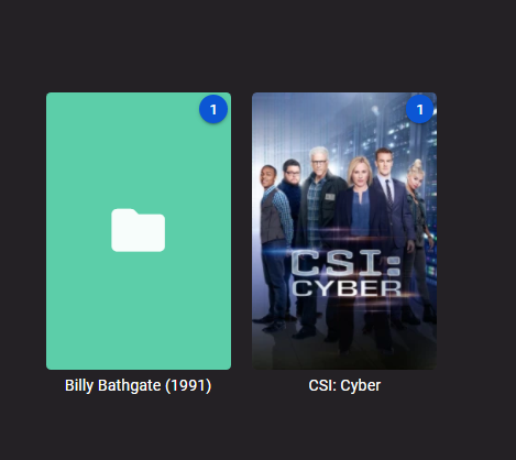

Happy2Play 9802 Posted October 7, 2021 Posted October 7, 2021 2 hours ago, Skijackz said: In my experience, this isn't true. As you can see, this library is set to TV yet is showing all of my movies. See screenshot. Server logs added. Know that I deleted and rebuilt the libraries again just to make sure I wasn't crazy. Same situation as above. Just a note - I'm heading out on vacation until Oct 12th so I won't be able to respond but thank you very much for looking at this. embyserver.txt 821.81 kB · 1 download I am also guessing these folders already had images in them but when I put a Movie and TV show in a TV library it is not identified as a movie. NO movie can ever be identified in a TV Show content type library. So give the images contain a Unplayed Episode indicator they are Mis-Identified just like my example below. So you can not mix media in a specific content type library. Or if you do there is no guarantee what will happen and not supported in any way.
