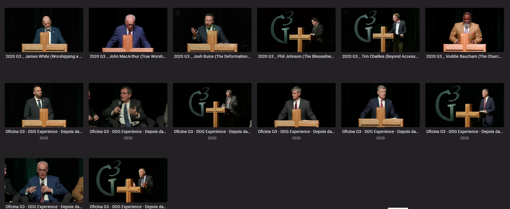

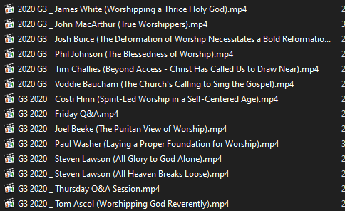

lightsout 156 Posted October 4, 2021 Posted October 4, 2021 (edited) I have a large collection of videos that are sermons that I do not want Emby to try and retrieve any external data for. I just want everything sorted by file name and folder structure. I recently removed the library and started over a couple times trying to get this right. I have unchecked every box for metadata sources in the settings for the specific library. Such as "TVDB", etc. Regardless Emby is still pulling info from an unrelated movie for many of my file. Is there a way to completely remove this, I have the library set to "Mixed Content" if that matters. Maybe I should set it to "home movies"? Here is a screen shot of my files and what Emby is doing with them. Really appreciate some help to get this sorted. I know this is the minority use scenario but I can't be the first one that has asked this. EDIT### I see that the naming in the files alternates, some are G3 2020 and some are 2020 G3. Regardless I would like Emby to completely ignore that and just spit out the file names. Edited October 4, 2021 by lightsout
