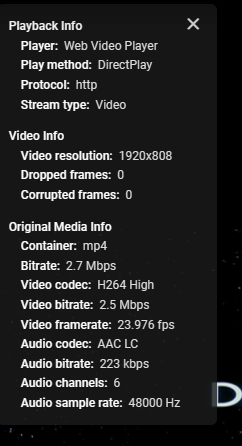

getack 4 Posted September 30, 2021 Posted September 30, 2021 Hello, Sometimes when I try to play back a movie or TV show, things remain stuck on the loading screen, where a green spinner spins indefinitely. I'm finding it difficult to identify exactly what is causing the issue, but 9/10 times when I go outside of Emby, and access the media file via a samba share, it plays back perfectly with VLC. This happens both on the Windows player and the web player for me. When looking at the network tab in inspect element, I think it's actually streaming the show, or at least downloading it, but nothing is playing. See the below screenshot, take note of the data transferred so far, and the ongoing `stream.mp4` call, that I guess is responsible for the actual streaming here: This particular movie is 2.9GB in size, so when I leave it to actually transfer the full movie's data across, then it starts playing. Is this the fault of the media file type or codec or something, and it's not possible to stream? I had to wait 8 minutes for this video to load before it could play. How long am I going to wait for a 40GB 4K video? See the stats for the video file information: Thank!
