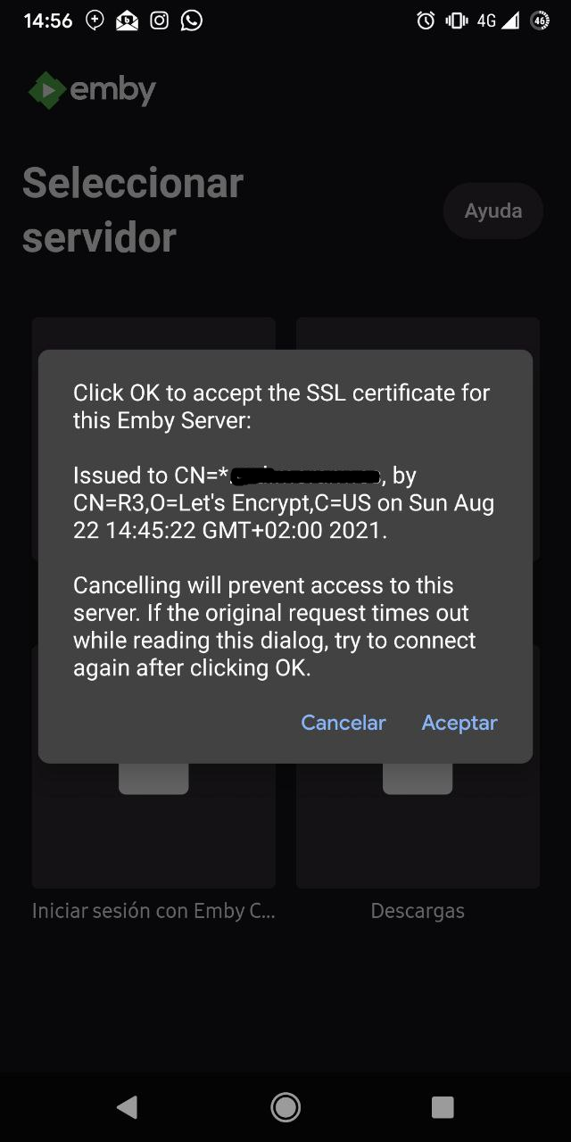

neik 874 Posted September 30, 2021 Posted September 30, 2021 (edited) Create a new one, I also saw some issues on Android Mobile using Chrome Browser with the cert today, creating a new one solved it. AFAIK Let's Encrypt made some changes today on their infrastructure which might be related to this. Edit: Need to revert what I said, there seem to be still issues with this. Just tried the Emby app for Mobile and it keeps asking me to accept the Let's Encrypt cert. On AndroidTV it's even worse, there I can't get my MiBoxS to connect anymore, it keeps telling me the server might be offline - which it isn't. Edited September 30, 2021 by neik
nague 5 Posted September 30, 2021 Author Posted September 30, 2021 I forced a certificate renew but the issue is still here on Emby for AndroidTV + AppleTV. Emby for Android Mobile noticed the new certificate and is working fine.

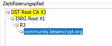

neik 874 Posted September 30, 2021 Posted September 30, 2021 I don't even get it fixed on Android Mobile, still seeing the message you posted in the screenshot above. I think it is somehow related to the certificates path, in my case the "DST Root CA X3" as parent is missing: The forum of Let's Encrypt looks like this: Interestingly if I use nginx as reverse proxy it does work fine, so I'm wondering if I am doing anything wrong in the conversion from pem to pfx. This is the command I am using: openssl pkcs12 -export -out certificate.pfx -inkey privkey.pem -in cert.pem -certfile chain.pem Any hint is appreciated!
nague 5 Posted September 30, 2021 Author Posted September 30, 2021 @neik I'm using acme.sh to renew my let's encrypt certificate, and this command to convert to pfx: acme.sh --toPkcs -d <domain> [--password pfx-password] In the meantime, same behavior in my side, Emby for Android Mobile keeps asking me that to accept the certificate, but it's working fine then.
Q-Droid 1002 Posted September 30, 2021 Posted September 30, 2021 I just renewed my cert to test and I think this might be an Emby problem, @Luke. The new full chain from LetsEncrypt includes the ISGR Root X1 cert used in cross signing but Emby is not presenting the full chain depth during the authentication handshake. So the client is trying to complete the chain using the DST Root CA X3. It appears the browsers are able to handle the expired root properly but not the Android clients if the chain cert is missing. subject=/CN=myembycn issuer=/C=US/O=Let's Encrypt/CN=R3 subject=/C=US/O=Let's Encrypt/CN=R3 issuer=/C=US/O=Internet Security Research Group/CN=ISRG Root X1 subject=/C=US/O=Internet Security Research Group/CN=ISRG Root X1 issuer=/O=Digital Signature Trust Co./CN=DST Root CA X3 My cert store has the full chain of three certs but Emby is only presenting two (depth=1). $ openssl s_client -connect myembycn:8920 CONNECTED(00000003) depth=1 C = US, O = Let's Encrypt, CN = R3 verify error:num=20:unable to get local issuer certificate --- Certificate chain 0 s:/CN=myembycn i:/C=US/O=Let's Encrypt/CN=R3 1 s:/C=US/O=Let's Encrypt/CN=R3 i:/O=Digital Signature Trust Co./CN=DST Root CA X3 --- 1
Q-Droid 1002 Posted September 30, 2021 Posted September 30, 2021 This is weirder than I though and now I'm convinced it's an issue in Emby. The LE R3 cert presented during the handshake IS NOT the LE R3 cert stored in the pfx. Also note that the one from Emby is expired. From Emby: Owner: CN=R3, O=Let's Encrypt, C=US Issuer: CN=DST Root CA X3, O=Digital Signature Trust Co. Serial number: 400175048314a4c8218c84a90c16cddf Valid from: Wed Oct 07 15:21:40 EDT 2020 until: Wed Sep 29 15:21:40 EDT 2021 Certificate fingerprints: MD5: 31:21:28:F5:A0:ED:7B:A5:4B:65:82:92:87:56:BA:83 SHA1: 48:50:4E:97:4C:0D:AC:5B:5C:D4:76:C8:20:22:74:B2:4C:8C:71:72 SHA256: 73:0C:1B:DC:D8:5F:57:CE:5D:C0:BB:A7:33:E5:F1:BA:5A:92:5B:2A:77:1D:64:0A:26:F7:A4:54:22:4D:AD:3B In PFX: Owner: CN=R3, O=Let's Encrypt, C=US Issuer: CN=ISRG Root X1, O=Internet Security Research Group, C=US Serial number: 912b084acf0c18a753f6d62e25a75f5a Valid from: Thu Sep 03 20:00:00 EDT 2020 until: Mon Sep 15 12:00:00 EDT 2025 Certificate fingerprints: MD5: E8:29:E6:5D:7C:43:07:D6:FB:C1:3C:17:9E:03:7A:36 SHA1: A0:53:37:5B:FE:84:E8:B7:48:78:2C:7C:EE:15:82:7A:6A:F5:A4:05 SHA256: 67:AD:D1:16:6B:02:0A:E6:1B:8F:5F:C9:68:13:C0:4C:2A:A5:89:96:07:96:86:55:72:A3:C7:E7:37:61:3D:FD

SOz92 8 Posted September 30, 2021 Posted September 30, 2021 I have problems too with the certificate in different android devices...I forced renew certificate but nothing solves.
jant90 15 Posted September 30, 2021 Posted September 30, 2021 Same issue here. Also got the notification in the mobile Android app to accept the new certificate shortly after midnight, after accepting it's working fine again. However I have several friends that can't play anything now. Most are running CoreELEC 9.2.8 (Kodi Leia) and the legacy Emby addon. One friend is running the Android TV app on a Mi Box. My own CoreELEC 19.2 (Kodi Matrix) box is not affected and browsers are fine as well. Who knows what to do? Should we generate the *.pfx differently? Maybe use fullchain.pem instead of chain.pem?
