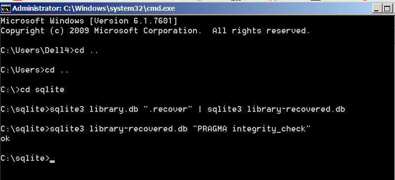

SteveCartman54 4 Posted September 29, 2021 Author Posted September 29, 2021 Ok So I was able to recover the database. I used PRAGMA integrity_check in SQlLite and DB Browser on the Recovery.db and everything was ok.(see attached screen shots) I rename Library.db to Library.old. I renamed library-recovered.db to library.db and copied it to my docker folder. Started up docker. Tried identify and same problem. I looked at the log and database is malformed (see attached log). I have also attached library.db (zipped) embyserver (5).txt library.zip
Happy2Play 9802 Posted September 29, 2021 Posted September 29, 2021 You will need to Reset the database per the KB as Recovery did not correct the issue. Since you have the Server Configuration Backup plugin you will be able to restore your userdata.
