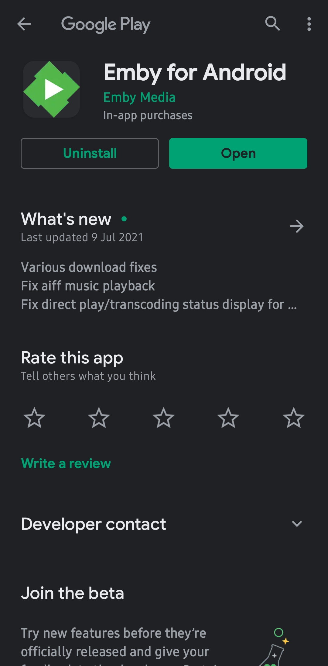

GoodOleHarold 3 Posted September 26, 2021 Author Posted September 26, 2021 So I have no update to do on the app on both phones An interesting thing, this plays on the other phone (andriod as well, Samsung). I hit play on 1 works fine the other at the same time..... Nope The phones are Samsung s21 ultra (working) and an s20 ultra (not working) we have different Emby users signed in I tried another film with the same quality not as many subtitles.. Same issue On my android it seems to transcode from 4k to 1080p which should be okay for the server I haven't had an issue with transcoding 4k before The server is not on my network it is a dedicated server that lives with Hetzner. Just installed with the Windows platform after Ubuntu had the same issue. Emby doesn't run on hyper-v I installed it on the host.

GoodOleHarold 3 Posted September 26, 2021 Author Posted September 26, 2021 After noticing you were on about the apk download rather than the play store button. I installed that apk and same issue

GoodOleHarold 3 Posted September 28, 2021 Author Posted September 28, 2021 3.2.14 is what I have installed currently
