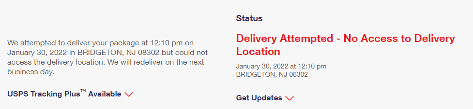

Carlo 4561 Posted January 30, 2022 Posted January 30, 2022 Hang tough another week Bert and I'll have a guide for how to do this and possibly more. I ordered some additional things to try and manipulate the NAS as much as possible while still being pretty easy to do. I've got everything but 2 pieces which were delayed. They were scheduled for delivery yesterday but we had a snow storm. Got rescheduled for delivery today and USPS pulled up out front. I walk out the front door walking toward the vehicle, get waved at and it drives off. I then walk in the house and get an Alexa notification (and email) message in a few minutes "Delivery Attempted - No Access to Delivery Location" which is quite annoying as the driver even waved at me as I was walking down the front steps. Tried to reschedule delivery but turns out that's not possible for Sundays. So hopefully tomorrow evening I'll be able to test these other items and see if needed drivers can be loaded. Then I'll be able to write up how to accomplish a few of these things the easiest way. Carlo 4
Carlo 4561 Posted January 31, 2022 Posted January 31, 2022 In total there was 4 packages like the above. Sucks most because my daughter feels bad as one of them was a birthday gift tied to one of the NFL games today. Should have been delivered on Friday but instead looks like the 40 miles via USPS will take 5 days. When she called this morning to wish me HB and found out it was actually being delivered today before 2pm she was happy as it was perfect timing (or so it seemed), but now she feels bad, but still won't tell me what it is. No doubt it's some type of gag gift that was tied to us watching the the two games together as a family over video chat.
usnscpo 24 Posted January 31, 2022 Posted January 31, 2022 Yea, I've had this happen too. Expected delivery by USPS, walk out to greet them only to have them look right at me and drive off. Rural USPS drivers can be jerks sometimes... she doesn't like to get out of her warm jeep in the winter.
Carlo 4561 Posted February 1, 2022 Posted February 1, 2022 I was expecting 3 packages via USPS yesterday and saw the truck pull up and met the driver half way as I wanted to make sure it was 3 packages I was expecting! Inside, I noticed one was for my dad. Err.... 2 of 3 packages, and still didn't get everything I was waiting on. I'm not usually the complaining type but had enough so a phone call to the local post speaking to the post master got me another delivery later in the day with the final piece I've been waiting on. What I'd really love to know is with their computerized tracking they use in the truck, does it not tell them all packages haven't been delivered for the address? Or does it and the driver just ignores it?
