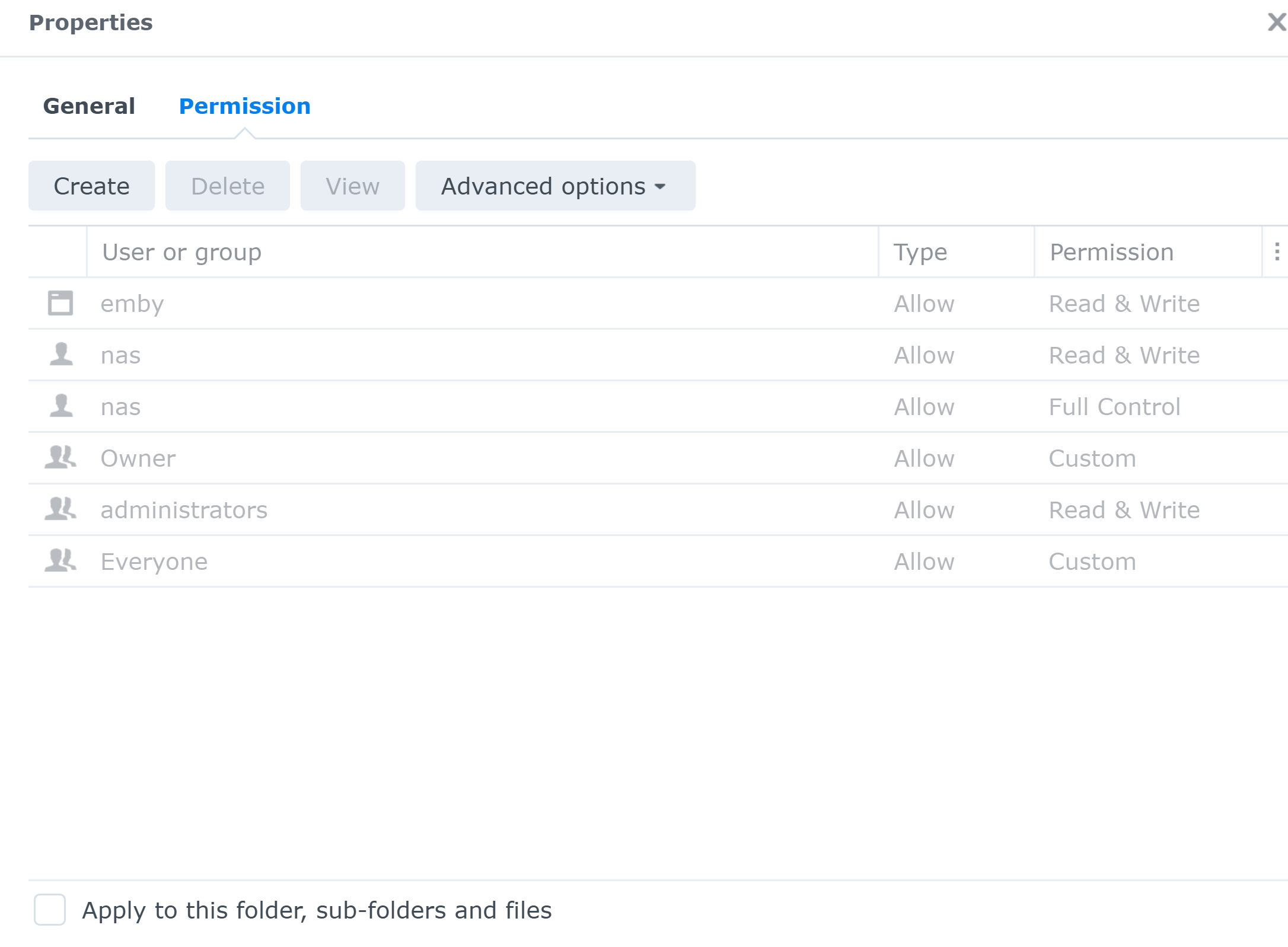

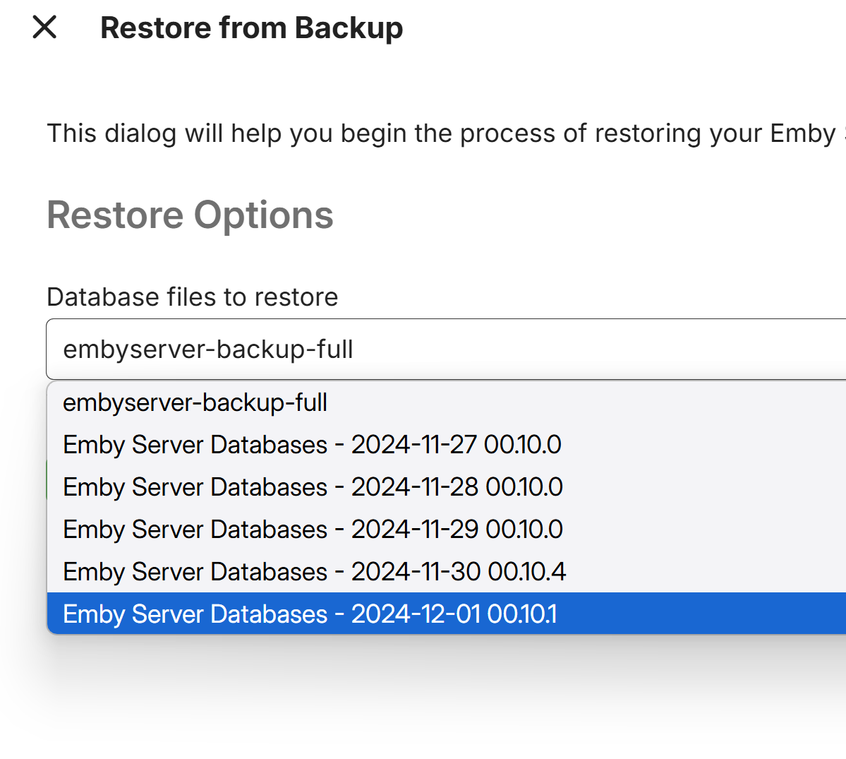

razclud 5 Posted November 24, 2024 Posted November 24, 2024 Sorry to revive an old topic but i am in the same situation. Backed up emby PC, managed to mount it and hit restore using that backup. It restarts the emby server but nothing changes. No users, no thing... i gave it permissions to the backup folder as well. embyserver.txt
razclud 5 Posted November 24, 2024 Posted November 24, 2024 Access to the path '/volume1/embyserver-backup-full' is denied. at System.IO.FileSystem.CreateDirectory(String fullPath) at System.IO.Directory.CreateDirectory(String path) at Emby.Server.Implementations.IO.ManagedFileSystem.CreateDirectory(String path) at MBBackup.ServerEntryPoint.ExecuteBackup(PluginConfiguration configuration, CancellationToken cancellationToken, IProgress`1 progress) at Emby.Server.Implementations.ScheduledTasks.ScheduledTaskWorker.ExecuteInternal(TaskOptions options) I am struggling with permissions it seems. I have giveth everything it wants to my admin, still does not work.
Carlo 4561 Posted November 25, 2024 Posted November 25, 2024 Hi, You will need to set permissions to the backup area for the internal emby user. Have you done that? Carlo
Luke 42241 Posted December 1, 2024 Posted December 1, 2024 On 11/29/2024 at 11:26 PM, razclud said: Yes, all subfolders too @razclud Hi, how exactly did you do that?
Luke 42241 Posted December 1, 2024 Posted December 1, 2024 4 hours ago, razclud said: For what folder is that?
razclud 5 Posted December 1, 2024 Posted December 1, 2024 (edited) The folder where i put the restore backup from the PC and where it saves the new backups on my nas Edited December 1, 2024 by razclud
Luke 42241 Posted December 3, 2024 Posted December 3, 2024 On 12/1/2024 at 5:31 PM, razclud said: The folder where i put the restore backup from the PC and where it saves the new backups on my nas Hi, apologies. At this point we don't recommend restoring backups across different platforms. There is still more work to be done with the backup and restore process in order to fully support that.
razclud 5 Posted December 6, 2024 Posted December 6, 2024 i just wanted the playback history and favorites to be remembered. Any way i can do that?
Luke 42241 Posted December 11, 2024 Posted December 11, 2024 On 12/6/2024 at 3:38 PM, razclud said: i just wanted the playback history and favorites to be remembered. Any way i can do that? Hi, the restore process also has a button to just extract user data if that's what you want.
