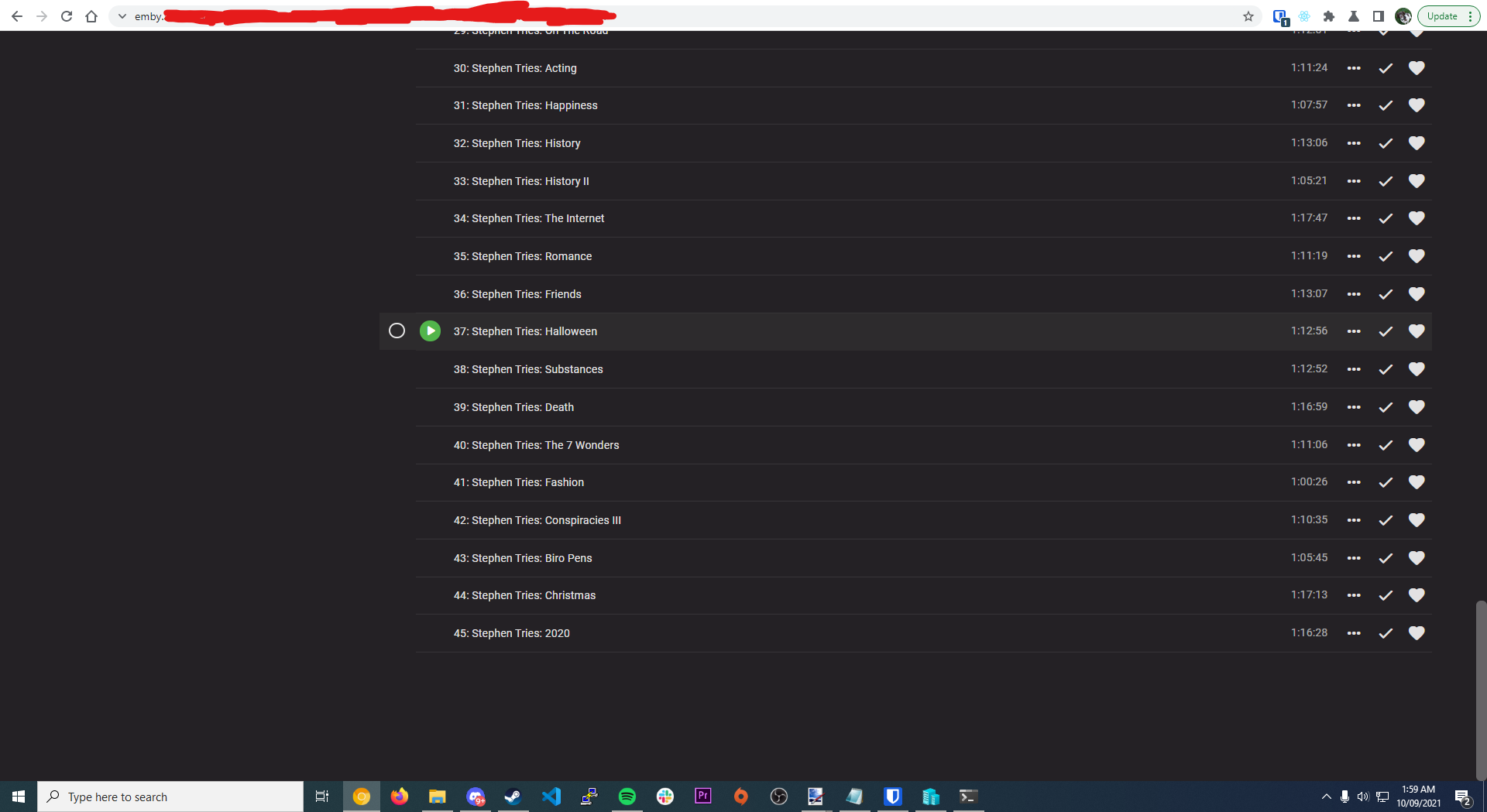

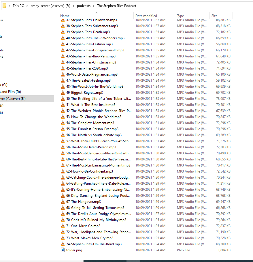

Adam_Kearn 1 Posted September 10, 2021 Author Posted September 10, 2021 Hey guys thanks for the advice. I have decided to take a diffrent approch to this now. Someone recommended to me to install podgrab https://github.com/akhilrex/podgrab And use that instead. I have installed the docker image and got every setup correctly. After it had finished downloading I had just over 70 mp3 files. When I did a libary scan I could only see 45 "songs" in the "audio book" libary I had created. I then decided to remake a new libary but this time with the type of "music" this also seemed to only show 45 items.... Is there a way to get emby to show all items that are in the album? (see screenshots below)

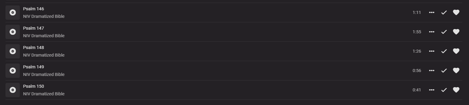

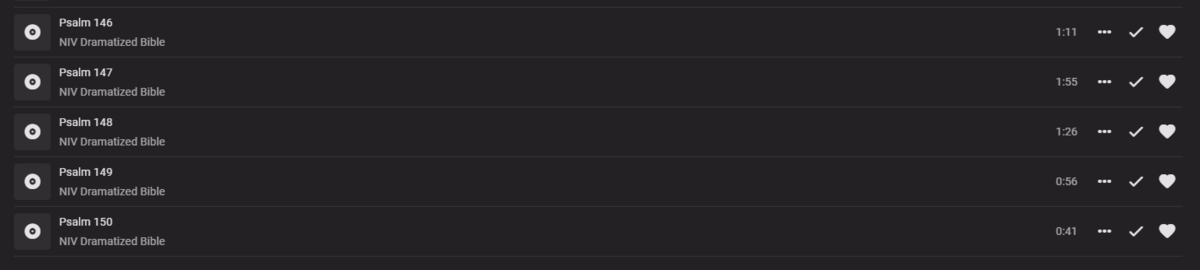

Happy2Play 9802 Posted September 10, 2021 Posted September 10, 2021 What view is that? Possibly a tagging issue as the views are tag driven except folder view. Do you see the same in folder view? I have a test copy of the bible and can see 150 mp3 in that book/folder (audiobook library). Have not tested in a Music library. snippet from the bottom

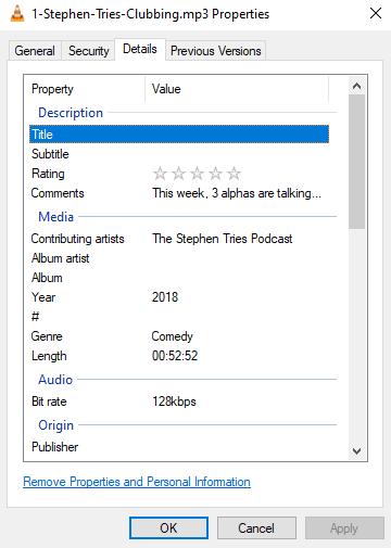

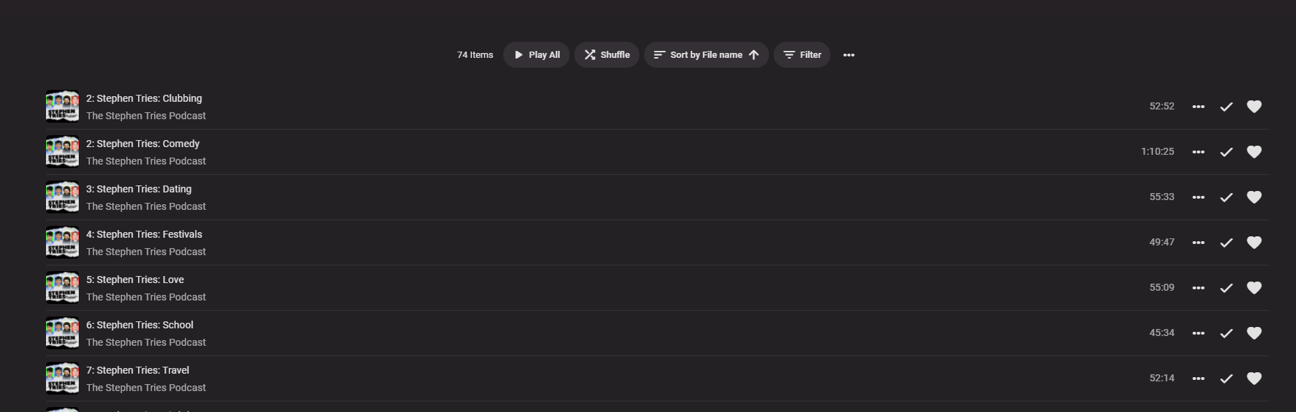

Adam_Kearn 1 Posted September 10, 2021 Author Posted September 10, 2021 When I go into folder view I can see all 74 items. How ever when I change the view to "list" it shows random names for some of the audio files. Some of the names have duplicated numbers (which are not on the origional file name) when I checked the metadata for that file it was completly fine apart from the title... Any ideas? See below:
Happy2Play 9802 Posted September 10, 2021 Posted September 10, 2021 (edited) I would think Filename should be correct, but would need to see embedded tags also as Emby is tag driven. With you stating Album is only showing 45, I am guessing items are getting multi-versioned or not shown in said album do to embedded tags since folder view is showing all items. Edited September 10, 2021 by Happy2Play

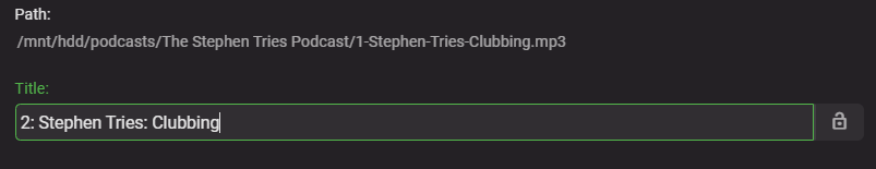

Solution Adam_Kearn 1 Posted September 10, 2021 Author Solution Posted September 10, 2021 (edited) Managed to solve the issue in the end... I checked and the metadata for the file had dupilicated episode numbers for some reason.... don't ask me why.... I was able to remove this from the files fairly easly in bulk (within windows) (See title feild) After doing this I rebooted emby and did a refresh but it was still showing the wrong names. It wasn't until I changed /var/lib/emby/cache to /var/lib/emby/cache.old it started to work. Looks like it was caching the wrong data. Thanks anyway. I'll see if there is an option to not include metadata in my podgrab config. Edited September 10, 2021 by Adam_Kearn

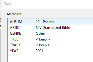

Happy2Play 9802 Posted September 10, 2021 Posted September 10, 2021 Glad you figured it out. You should run all mp3 media thru something like mp3 tag to verify all embedded tags. Have not verified audiobooks but all tracks should have same Album and Album Artist name to shown as one album, otherwise they can be split out into single track albums. Looks like I have my audiobooks tagged with Album and Artist.
