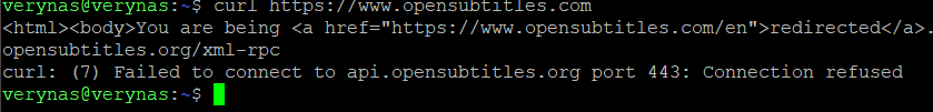

CerebroPower 2 Posted September 6, 2021 Author Posted September 6, 2021 I can use putty to run commands on the synology. curl like this?

rbjtech 5335 Posted September 6, 2021 Posted September 6, 2021 try the API I get - curl https://api.opensubtitles.org/xml-rpc <?xml version="1.0" encoding="utf-8"?><methodResponse><params><param><value><struct><member><name>status</name><value><string>parse error. not well formed</string></value></member><member><name>seconds</name><value><double>0.001</double></value></member></struct></value></param></params></methodResponse> It's junk - but it's a response.

rbjtech 5335 Posted September 6, 2021 Posted September 6, 2021 I think it's an issue on opensubtitles - if you try a 'curl' to any other website (curl https://emby.media) - if you get a response back, then your synology (and thus emby) is getting external access ok.
CerebroPower 2 Posted September 6, 2021 Author Posted September 6, 2021 ye curl https://emby.media is fine. So is opensubtitles down or?, will VIP access make a difference?
