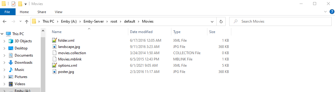

Happy2Play 9813 Posted September 8, 2021 Posted September 8, 2021 23 minutes ago, qrest said: For whatever reason, upgrading Emby (from 4.3.1.0 to 4.6.4.0 if that helps you) automatically (as in, without my input or direction) switched my libraries to "Mixed content" This could make since but not positive when the changed from this structure to only the options.xml with contenttype in the xml. But nfo setting is another story.
