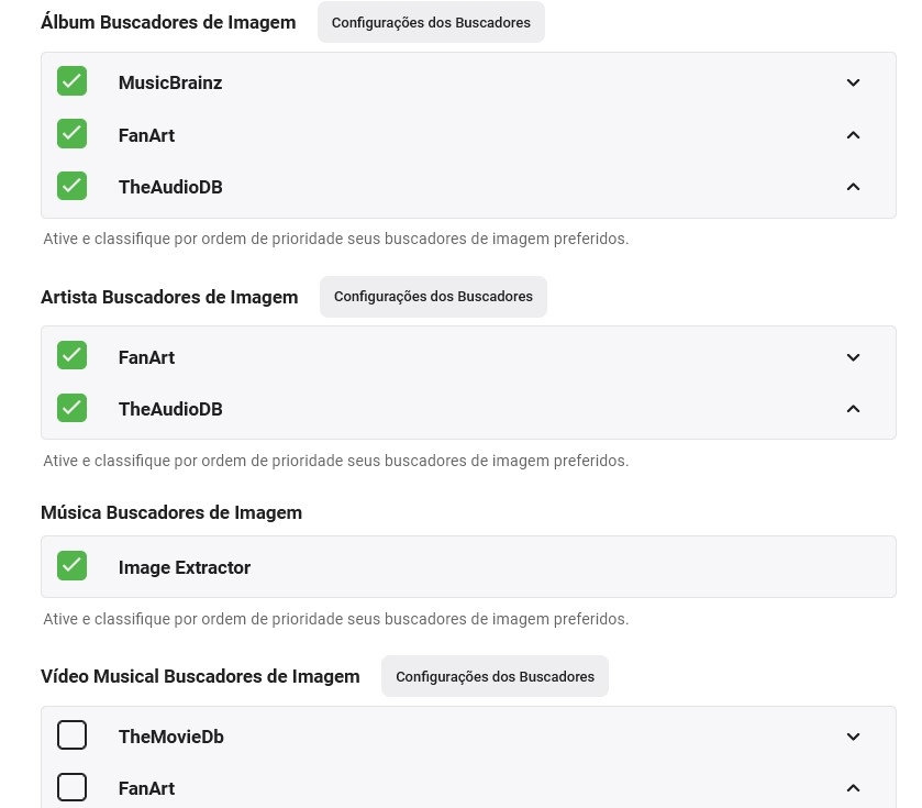

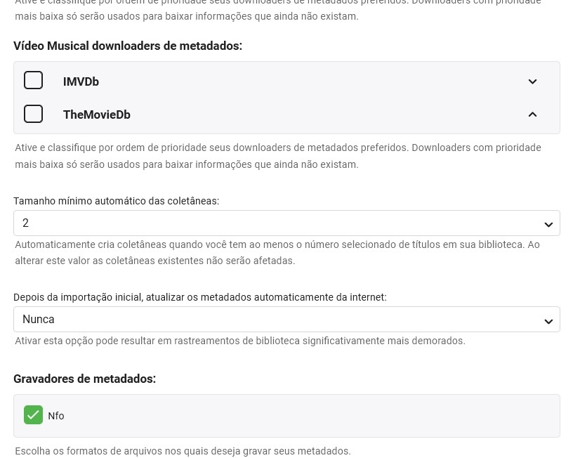

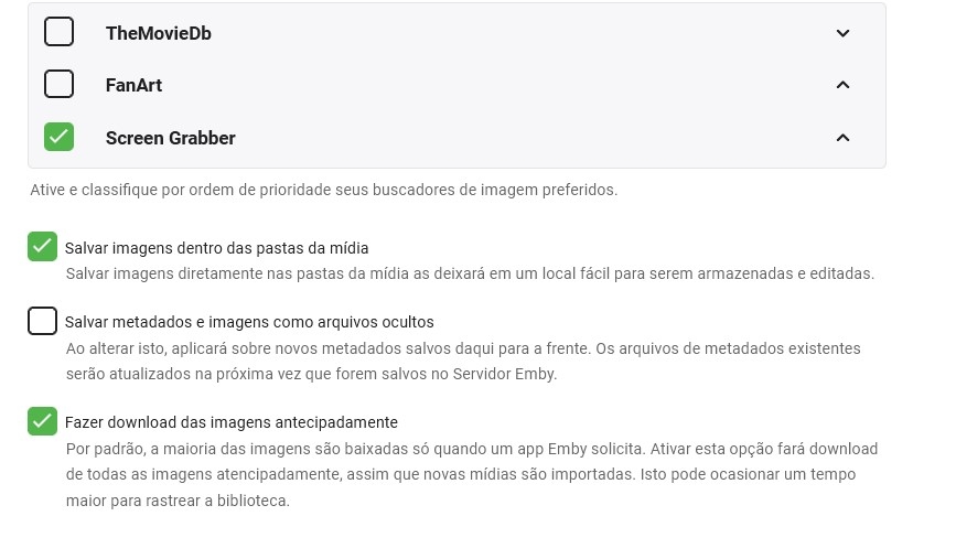

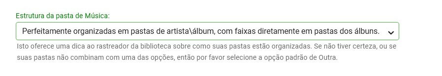

Luke 42288 Posted March 17, 2022 Posted March 17, 2022 14 hours ago, gsites said: Não fiz a respeito do VA, mas não corresponde a maioria dos artistas da musica. No Plex corresponde, mas no emby não HI there, how you have configured the metadata options in your music library?
gsites 14 Posted March 21, 2022 Posted March 21, 2022 On 3/17/2022 at 1:03 PM, Luke said: HI there, how you have configured the metadata options in your music library? Hello

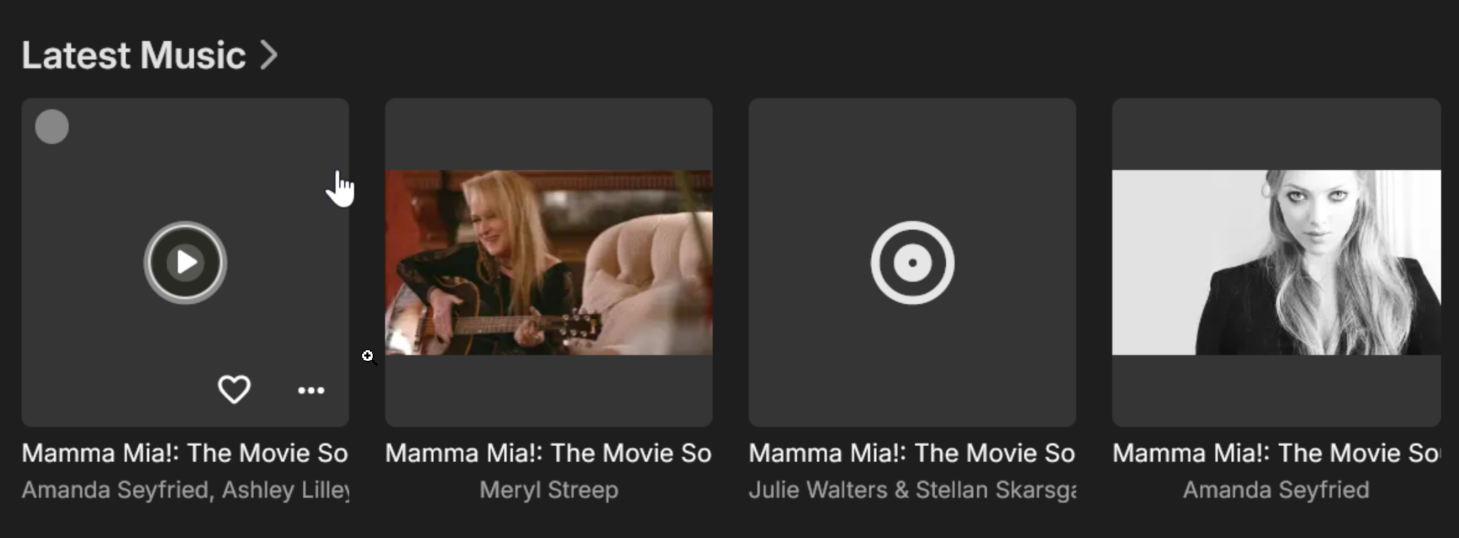

xe` 45 Posted June 9, 2024 Posted June 9, 2024 (edited) This is what it looks like without the musicbrainz tag. Notice it is splitting by Album and Artist even though all the AlbumArtist tags match If I add the musicbrainz tag it becomes as expected So here at least this doesnt work as I would expect with "combination of album and albumartist" not grouping correctly. Am I being stupid? Edit: I will find a new clean untouched example to test with and report back. Edited June 9, 2024 by xe` Talkign rubbish fixed with real data
Happy2Play 9814 Posted June 9, 2024 Posted June 9, 2024 11 minutes ago, xe` said: This is what it looks like without the musicbrainz tag. Notice it is splitting by Album and Artist even though all the AlbumArtist tags match If I add the musicbrainz tag it becomes as expected So here at least this doesnt work as I would expect with "combination of album and albumartist" not grouping correctly. Am I being stupid? Edit: I will find a new clean untouched example to test with and report back. I will have to try and test again with no provider data but should be just album and albumartist. But without seeing track tags before you added MBZ tags it really is hard to say.
Happy2Play 9814 Posted June 9, 2024 Posted June 9, 2024 17 minutes ago, xe` said: . Notice it is splitting by Album and Artist even though all the AlbumArtist tags match What is the matching AA? Quote For these types of compilation albums if you want all tracks to show up as a single entity you want to make sure both the "album" and "album artist" fields are the same for all tracks. Otherwise the album will be split up for the various artists listed.
Happy2Play 9814 Posted June 9, 2024 Posted June 9, 2024 Found no issue with compilation album with same album and AlbumArtist with no metadata ids But per the image above they appear to not have same AA.
xe` 45 Posted June 9, 2024 Posted June 9, 2024 I will get an identical set of FLACs to test with to reproduce the original condition. Thanks for the info and help. I will do the leg work here now that I understand how this works to find out what the issue is and report back if its an actual issue or PEBCAK.
Happy2Play 9814 Posted June 9, 2024 Posted June 9, 2024 3 minutes ago, xe` said: I will get an identical set of FLACs to test with to reproduce the original condition. Thanks for the info and help. I will do the leg work here now that I understand how this works to find out what the issue is and report back if its an actual issue or PEBCAK. Yes as this image suggest no AA. As it shows different Artists per track. 1
