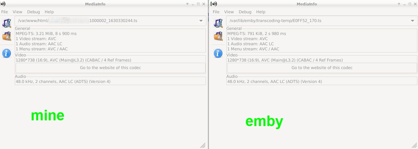

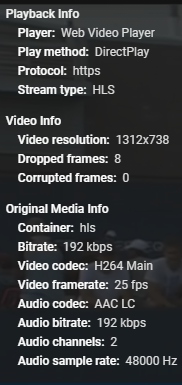

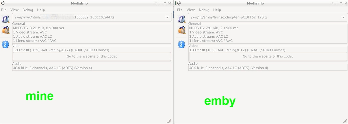

nunuxx 7 Posted September 5, 2021 Posted September 5, 2021 Hi, I'm using "Iptv 1.1.9.0" extension - I put playlist.m3u8 url then i choose name and picture - All is fine on PC/MAC/ANDROID Smartphone/Iphone/etc... - BUT not on Android TV : Android TV need "Transcoding option" enable (but I don't want it) Here is mediainfo with transcoding : On the left > my transcode On the right > emby transcode of my transcode (lol) It's clearly the SAME instead emby segment are 1 second, mine 8 seconds --- When I watch on browser here is nerd stats : As you can see it's "Directplay" (no need transcoding > option is turned OFF) --- Then I checked log : I tried to change the max bitrate without success (maybe you have solution for that?) --- I'm using 1000 devices subscription, I really need this working Note : It's working fine on "Jellyfin Android TV" app Note² : It's worked fine few month ago with Emby server 4.6.x and Android TV app 1.8.x I'm using Emby BETA version and all is uptodate I don't understand why it's working everywhere but not in Android TV ? --- Tell me more please? Regards

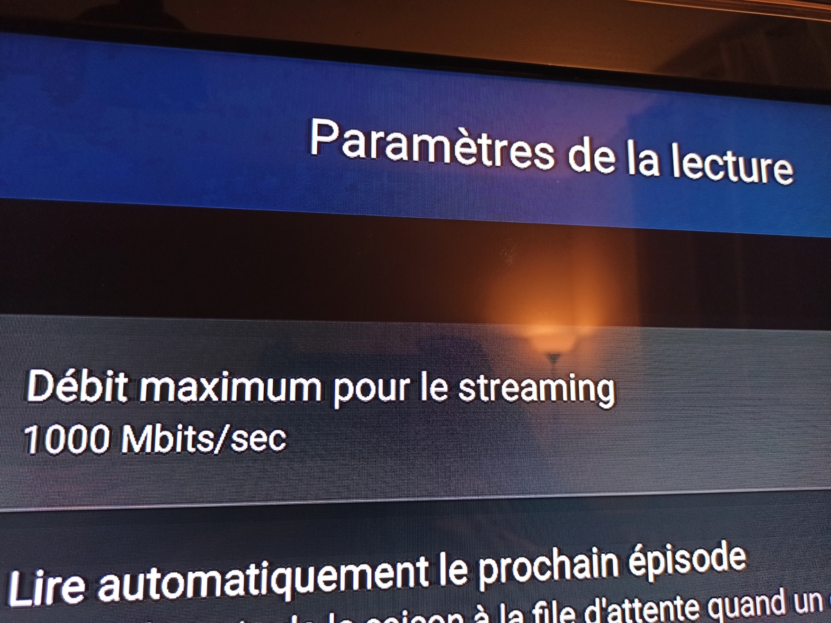

Luke 42246 Posted September 5, 2021 Posted September 5, 2021 Where did you set the bitrate limit? Try setting it higher than 40 mbps.
nunuxx 7 Posted September 5, 2021 Author Posted September 5, 2021 2 hours ago, Luke said: Where did you set the bitrate limit? Try setting it higher than 40 mbps. Please tell me the right way to set this bitrate limit? I found old post here and guy said into .js file (don't remember which one).. then into the settings android tv app : All of them didn't change anything... Really need this feature working again please help

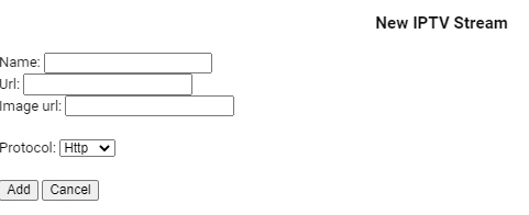

nunuxx 7 Posted September 7, 2021 Author Posted September 7, 2021 @cayarsAs I SAID : I'm USING IPTV 1.1.9.0 plugin from the "Extensions" field into Emby Panel I put NAME + URL (finishing with .m3u8) + image url Then protocol : HTTP Works fine on BROWSER (CHROME) DIRECTPLAY without transcoding : Works fine on Emby Smartphone app too without transcoding *BUT* NOT into Android TV App > Problem is : --- Then it's working FINE into JELLYFIN .. AND it's worked fine few weeks ago with EMBY 4.6.x and Android TV app 1.8.x without transcoding I'm using Emby BETA (now 4.7.0.9) : If i turn ON transcoding option : it's WORKING, BUT it's transcoding as the same I already do ! This is insane ? Why Transcoding WITH SAME format SAME options : All is same (AVC / AAC LC / all others things) ? Please help me
Carlo 4561 Posted September 7, 2021 Posted September 7, 2021 We understand this, but we're trying to tell you this is the wrong approach for setting up Live TV. IPTV plugin wasn't designed for Live TV but for single streams. If you want your clients to be able to direct play or direct stream Live TV vs always transcoding then you need to set this up using Live TV not IPTV plugin. If you follow our lead and set this up in Live TV it should work much better for you and give you the full TV experience as designed.
Carlo 4561 Posted September 7, 2021 Posted September 7, 2021 With that said, it appears on that specific Android client you have a bitrate limit set that is causing the transcode.
nunuxx 7 Posted September 7, 2021 Author Posted September 7, 2021 4 minutes ago, cayars said: We understand this, but we're trying to tell you this is the wrong approach for setting up Live TV. IPTV plugin wasn't designed for Live TV but for single streams. If you want your clients to be able to direct play or direct stream Live TV vs always transcoding then you need to set this up using Live TV not IPTV plugin. If you follow our lead and set this up in Live TV it should work much better for you and give you the full TV experience as designed. check this please https://emby.media/community/index.php?/topic/101400-live-tv-on-android-tv-need-transcoding-why/&do=findComment&comment=1064484 Message : Unable to tune to channel at this time.
nunuxx 7 Posted September 7, 2021 Author Posted September 7, 2021 Just now, cayars said: With that said, it appears on that specific Android client you have a bitrate limit set that is causing the transcode. Do you know HOW to remove it or to increase it ?
Carlo 4561 Posted September 7, 2021 Posted September 7, 2021 Check your user settings. I don't have the client in front of me to look but I think it's in the Playback menu.
nunuxx 7 Posted September 7, 2021 Author Posted September 7, 2021 Already done in the android TV client app doesn't change anything
