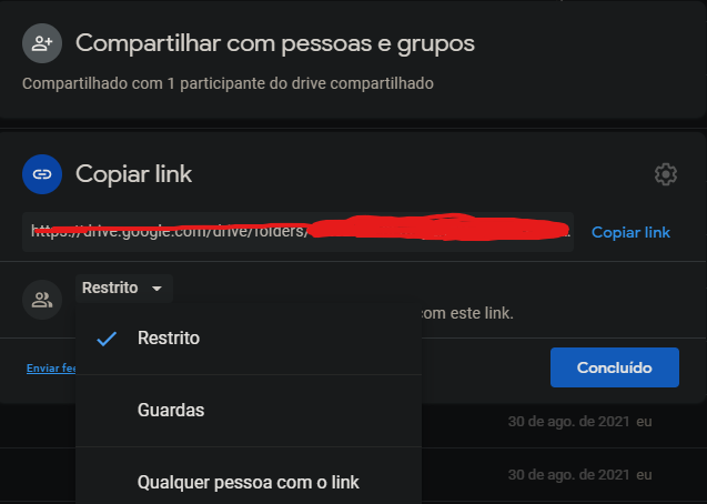

KoqueSilva 2 Posted September 5, 2021 Posted September 5, 2021 hello would it be possible to make an srtm file privately with google drive without sharing it to everyone?

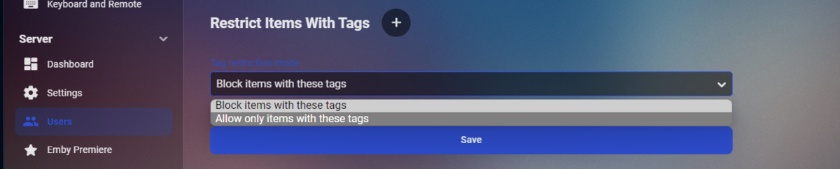

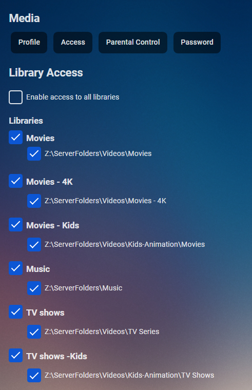

Happy2Play 9802 Posted September 5, 2021 Posted September 5, 2021 I guess you could possibly use allow access with Tags or create a new library and only all yourself access.
KoqueSilva 2 Posted September 5, 2021 Author Posted September 5, 2021 1 hour ago, Happy2Play said: Eu acho que você poderia usar permitir acesso com tags ou criar uma nova biblioteca e apenas o acesso você mesmo. Could you explain it to me better? I'm from Brazil, sorry for the translation.
Happy2Play 9802 Posted September 5, 2021 Posted September 5, 2021 You can put the strm file in its own library and only allow access to that library. Or allow/restrict tag But these will be setting you have to apply per user.
KoqueSilva 2 Posted September 5, 2021 Author Posted September 5, 2021 In Google Drive do I need to share a movie with everyone to create the strm file or can I do it privately?
rodainas 191 Posted September 5, 2021 Posted September 5, 2021 2 hours ago, KoqueSilva said: In Google Drive do I need to share a movie with everyone to create the strm file or can I do it privately? As emby is not a browser logged with your account details, you need to set the links to public in order to play it through emby, and that's why this method is not recommended.

KoqueSilva 2 Posted September 5, 2021 Author Posted September 5, 2021 (edited) So I've already used rclone and raidrive at the moment I'm using raidrive but I've noticed that with a strm file the movies start much faster, in a matter of seconds, but my fear is leaving the file public and someone using it to browse the movies, it would be too good if Emby implemented this authentication to work the strm files. That's why I want to see a way to make this work but in a private way. Edited September 5, 2021 by KoqueSilva
koopa8840 24 Posted September 5, 2021 Posted September 5, 2021 Have you tried using the option "Anyone with the link"? The file wouldn't be open to the public; just those with the link which you will have stored in a STRM file. Just a thought.
KoqueSilva 2 Posted September 6, 2021 Author Posted September 6, 2021 1 hour ago, koopa8840 said: Você já tentou usar a opção "Alguém com o link"? O arquivo não seria aberto ao público; apenas aqueles com o link que você terá armazenado em um arquivo STRM. Apenas um pensamento. But even with anyone with the link, whoever searches on Google can find my link I think?
