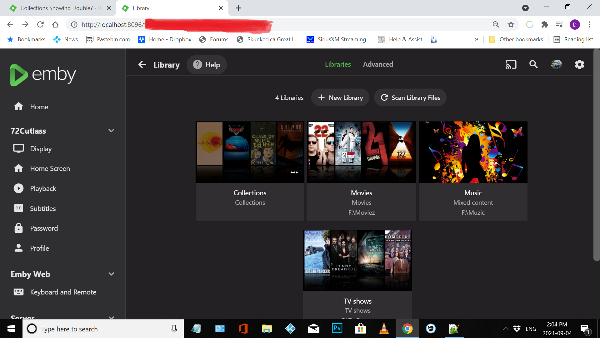

Happy2Play 9802 Posted September 4, 2021 Posted September 4, 2021 (edited) 2 minutes ago, Skyhigh69 said: Ok the delete and rescan worked, thanks ladies and germs much appreciated. Technically it did not as that is a Mixed Content library now. That was the step to allow you to delete the library on Dashboard-Library. What are inside those folders? Edited September 4, 2021 by Happy2Play
Carlo 4561 Posted September 4, 2021 Posted September 4, 2021 That does look like a mixed library. You want to go back to the admin Library menu and delete this Collection (will now have a delete option on the 3 dot menu). After removing this library you want to do a full library scan which will rebuild the Collection lib properly.

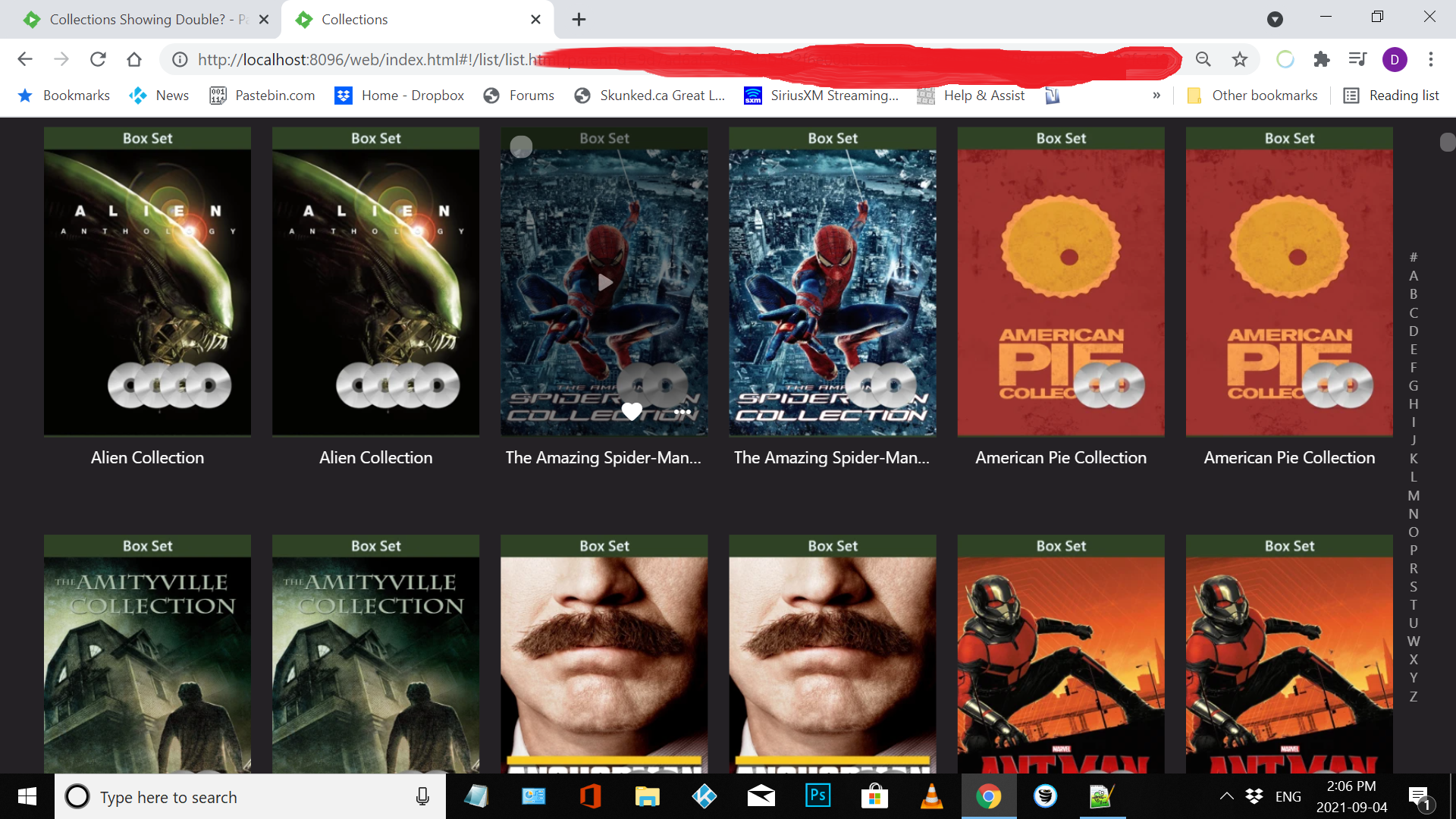

Skyhigh69 7 Posted September 4, 2021 Author Posted September 4, 2021 Ok I did all that, it fixed it to show collections, but its scanning in doubles again lol, vicious cycle?
Solution Happy2Play 9802 Posted September 4, 2021 Solution Posted September 4, 2021 Unfortunately I think you will have to delete each one as they are duplicated in the database. But suspect deleting one will remove both. Only other possible option would be removing the Movies library, scanning, then re-adding. As technically is should remove all items related to the library in the database.

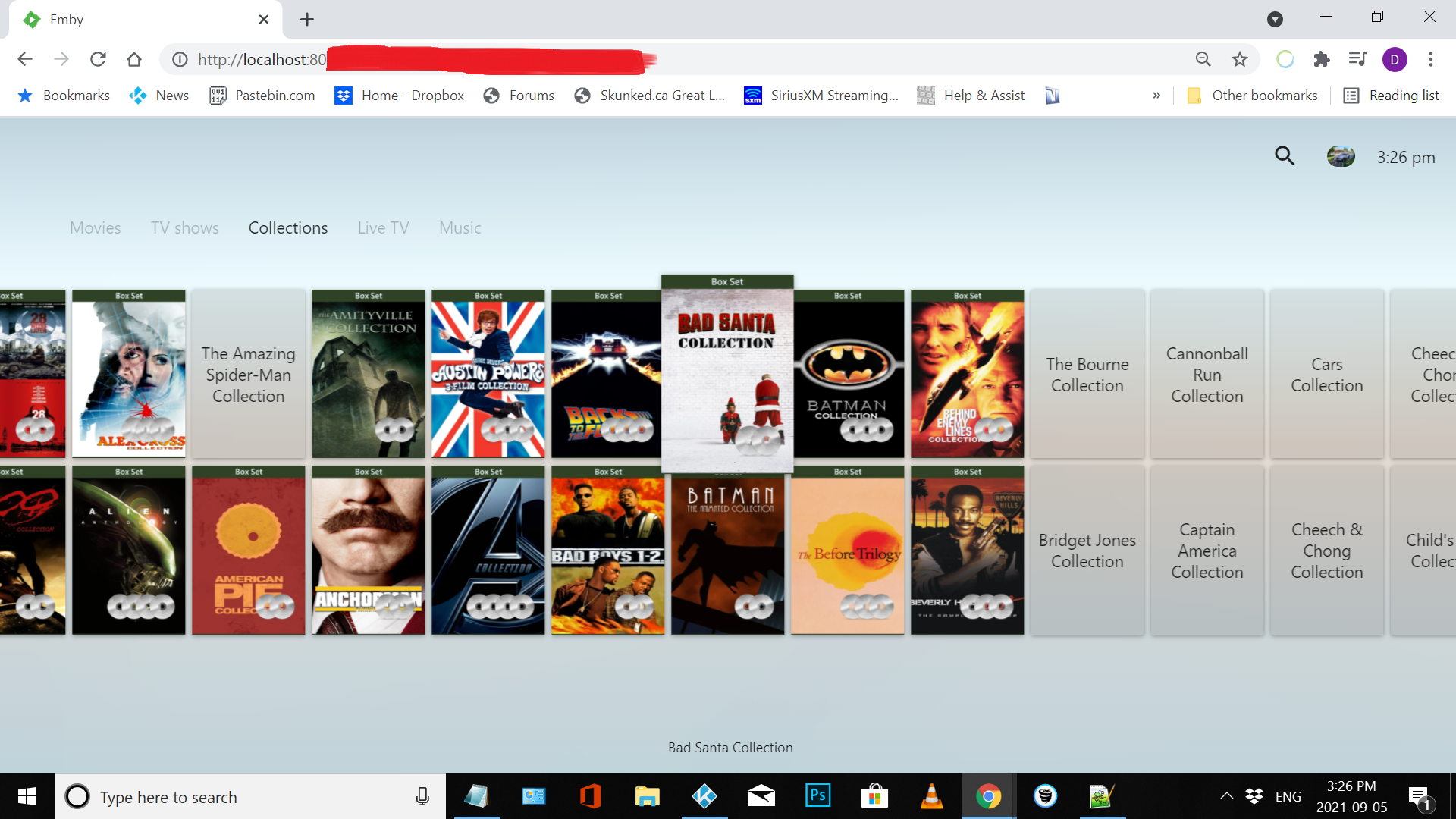

Skyhigh69 7 Posted September 5, 2021 Author Posted September 5, 2021 I posted that Happy's idea worked, I deleted the movies and collections, re scanned, and that fixed the doubles issues for now. Ok so here is a NFO file, I make them with tiny media manager. movie.nfo

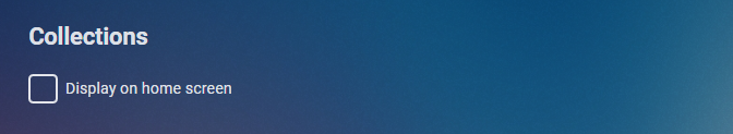

Skyhigh69 7 Posted September 5, 2021 Author Posted September 5, 2021 Looking into this more, while the doubles are gone, there are a ton that didn't get any art now so I really don't no what to do. Looking at some other threads, this seems to be a problem for years now, is it possible to remove collections from the main screen, same with recordings, these come back constantly after removing? I would like to remove them if they wont display properly thanks.
Happy2Play 9802 Posted September 5, 2021 Posted September 5, 2021 Has a library scan finished? But you can hide Collections from My Media, it is a per user option. User settings-Home Screen

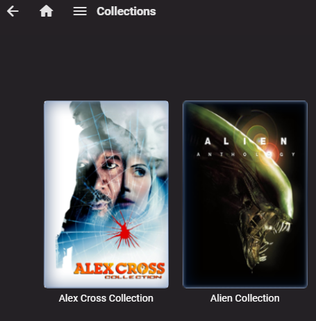

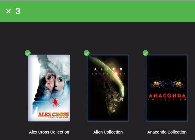

Carlo 4561 Posted September 5, 2021 Posted September 5, 2021 (edited) You can multi-select the collections without images and then use the 3 dot menu to refresh meta-data making sure to select replacing images. Try it on 5 or 6 multi-selected movies which shouldn't take to long to run. If you don't see a change go back to the main menu and then back to collections. Edited September 5, 2021 by cayars

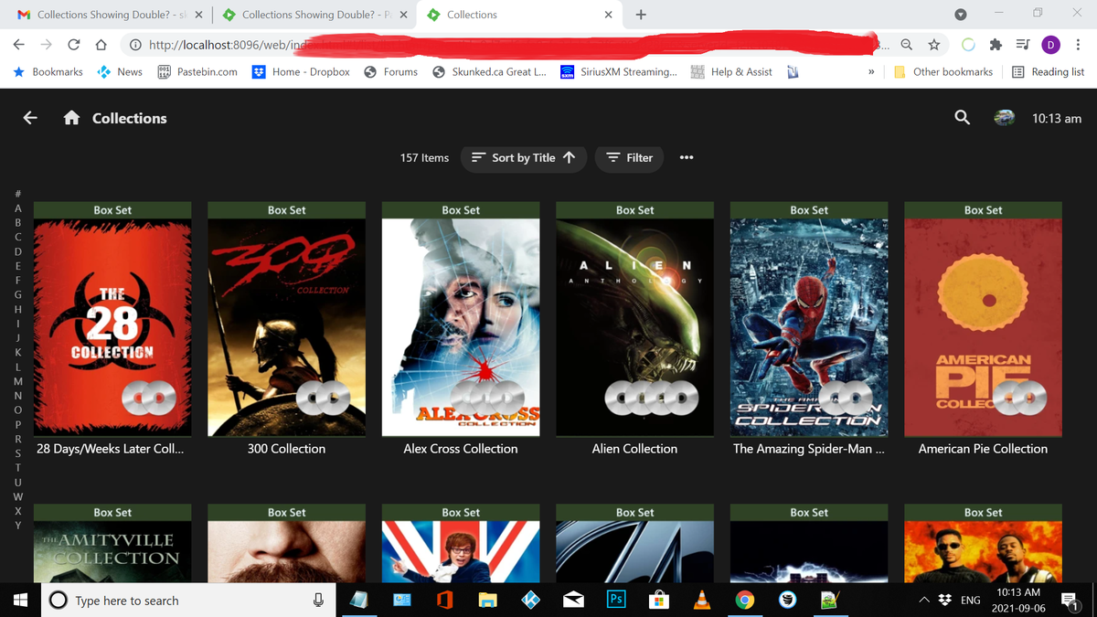

Skyhigh69 7 Posted September 6, 2021 Author Posted September 6, 2021 (edited) 14 hours ago, cayars said: You can multi-select the collections without images and then use the 3 dot menu to refresh meta-data making sure to select replacing images. Try it on 5 or 6 multi-selected movies which shouldn't take to long to run. If you don't see a change go back to the main menu and then back to collections. I noticed the replace meta, refresh meta will get the cover for missing ones, I haven't seen a way to multi select so I didn't bother to fix since that would take to long to do 1 at a time. Edited September 6, 2021 by Skyhigh69 spelling
koopa8840 24 Posted September 6, 2021 Posted September 6, 2021 1 hour ago, Skyhigh69 said: I haven't seen a way to multi select Click the circle, in the upper left corner, and then the 3 dots at the right end of the green banner. Banner will show when more than 1 title is selected.
Skyhigh69 7 Posted September 6, 2021 Author Posted September 6, 2021 I don't think you have windows server because mine dosen't have anything in the corner, anyways I have fixed it by painfully doing 1 at a time.

koopa8840 24 Posted September 6, 2021 Posted September 6, 2021 I have Windows. You have to move the cursor over the item and the circle appears.

Skyhigh69 7 Posted September 6, 2021 Author Posted September 6, 2021 Ok I got the covers to show where the check marks goes, If you have display set to tv rather than auto you will get no option to select. Like I said, I have this fixed for myself, one cover at a time. Whats the real root cause for doubles I cant say, its a pain in the butt of fix though, thanks for your time everyone, much appreciated. 1
