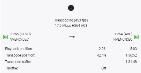

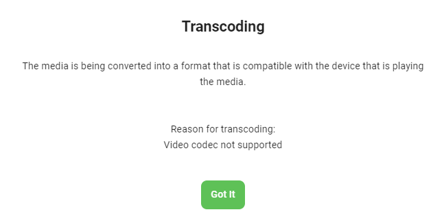

Dreamz2k 1 Posted September 2, 2021 Author Posted September 2, 2021 (edited) Erm no idea - this is from the Emby dashboard: States video codec not supported (hence transcoding) Edited September 2, 2021 by Dreamz2k
Carlo 4561 Posted September 2, 2021 Posted September 2, 2021 So that is transcoding and would not have HDR. What client was this?

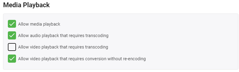

Guest Posted September 2, 2021 Posted September 2, 2021 (edited) In the user settings. Disallow it. Edited September 2, 2021 by generiq
Dreamz2k 1 Posted September 2, 2021 Author Posted September 2, 2021 You mean this? nothing plays if I set it as per the image.

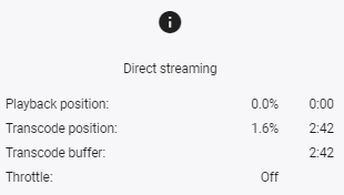

Dreamz2k 1 Posted September 2, 2021 Author Posted September 2, 2021 (edited) Managed to get a bit further, it shows direct streaming now but disappears after 1-2 secs: Edited September 2, 2021 by Dreamz2k
Guest Posted September 2, 2021 Posted September 2, 2021 9 minutes ago, Dreamz2k said: You mean this? nothing plays if I set it as per the image. That would be what is expected. The player doesn't support something. What you need to do is post the ffmpeg log. That will give you the reason for the transcoding.

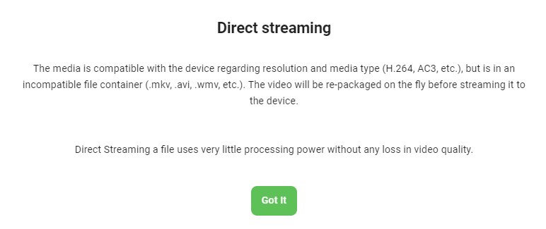

Dreamz2k 1 Posted September 2, 2021 Author Posted September 2, 2021 I'm just trying the conversion feature to see if repacking it in a different container will solve the issue...
Guest Posted September 2, 2021 Posted September 2, 2021 If the server is transcoding due to an unsupported container, then that needs to be fixed. That shouldn't be happening. I've had things fully transcode because of unsupported audio. That also shouldn't happen. I consider that an error.
