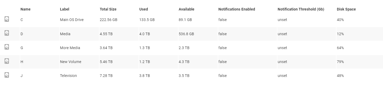

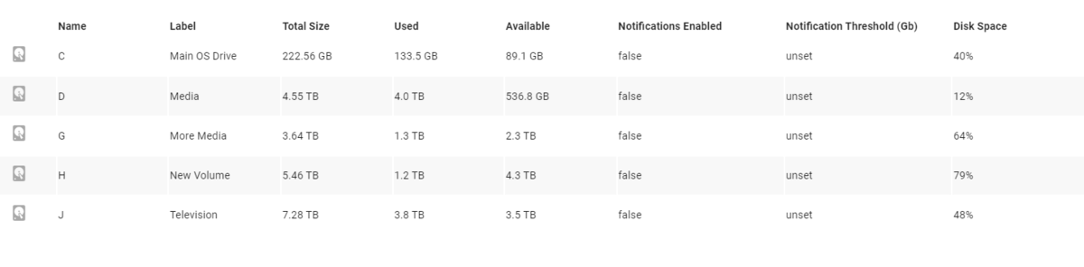

Carlo 4561 Posted September 1, 2021 Posted September 1, 2021 (edited) Hi, Go to Networks->Enable automatic port mapping and turn this off. That will stop the errors from showing up in the log as Emby will stop trying to automatically set port forwarding for you. You log file shows "Disk Space Almost Full Notification Completed after 0 minute(s) and 0 seconds" So the first thing to check would be the amount of free space you have for DVR recording and transcoding. How much free space do you have? Edited September 1, 2021 by cayars
interman 18 Posted September 1, 2021 Author Posted September 1, 2021 Thanks. I changed the setting on port mapping. Disks have more than enough space. listing attached. E drive is DVD. Transcoding in on G drive which is 64% available, over 2.3 TB/ DVR recording is also G. When complete, files are moved to J which is 58% available that is a very larger drive. I dont think space is the issue, but thanks for seeing that. Don
