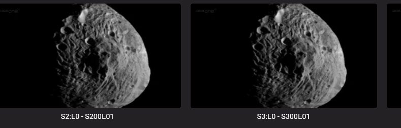

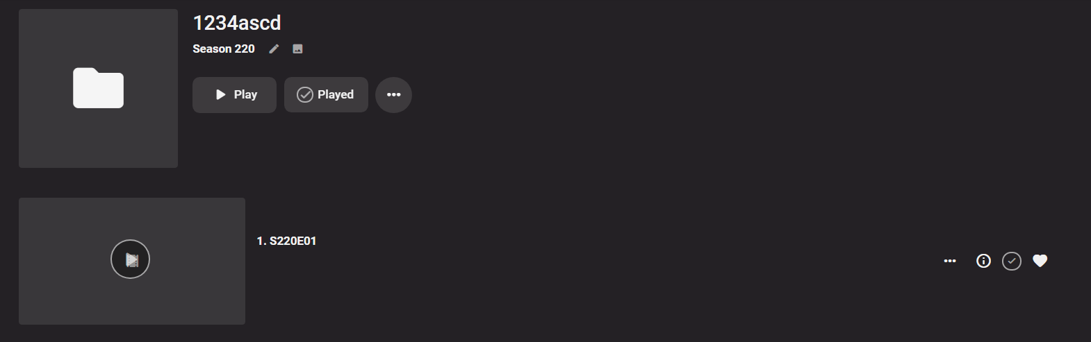

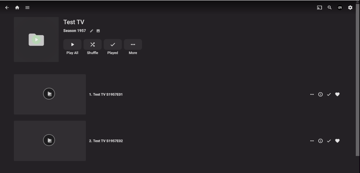

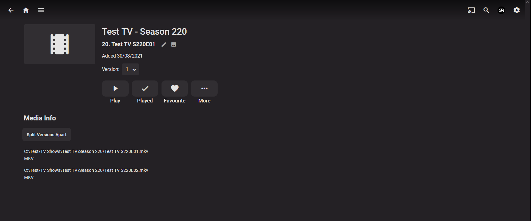

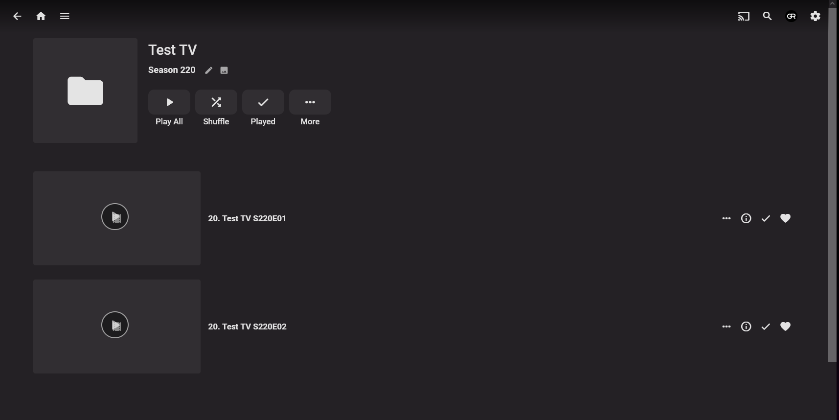

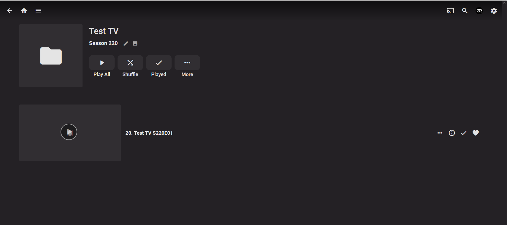

GrimReaper 4906 Posted August 30, 2021 Posted August 30, 2021 (edited) You're right, something strange DOES happen with Seasons 200+ : although Season folders do get recognized, episodes underneath are garbled and interpreted only by Sxyy while Exx gets disregarded (strangely enough, Season 1957 doesn't seem affected). Season 220 episodes even get merged together and don't show separately until unmerged, although they are clearly different episodes with no "space dash space" for multi-versioning. @Luke Edit: Although, on second look, this can actually work in your favor, as you will already have Level/Story division presented (with S for Level and E for Story) and upon unmerging they will be chronologically listed under same episode (in reality Story) number. But as per your folder structure, you cannot have S200 or S300 (as in your screenshot), as that would be Level 2 Story 0 (Level 3 Story 0)? Edited August 30, 2021 by GrimReaper Append

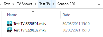

Happy2Play 9814 Posted August 30, 2021 Posted August 30, 2021 1 minute ago, GrimReaper said: I tend to disagree there, as there's nothing to guess: S220E01 has clear S/E identifier and it should not be misinterpreted or guessed, with the need for manual editing. If S110E01 is parsed correctly and S1957E01 is parsed correctly, then anything inbetween should also be. True there is a point where it doesn't work as year seasons have worked from the begin as I have many series in this format. But at the same time that is what the provider has also so there is really no guess work on Emby's part. But I would agree with that proper SxxxExx name it should be parsed properly. 1

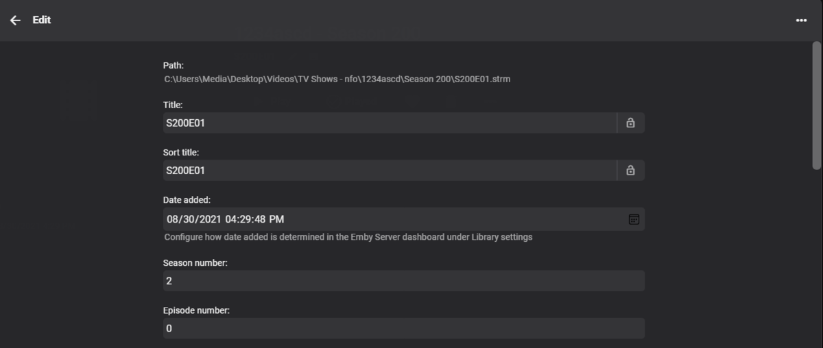

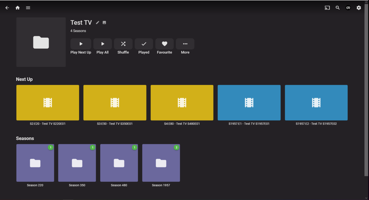

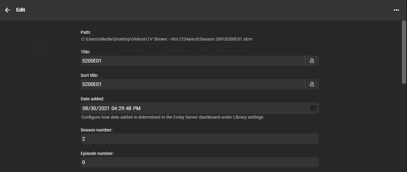

Happy2Play 9814 Posted August 30, 2021 Posted August 30, 2021 @Lukeis there something in the parser that would cause S110E01 to work but not S220E01? As it gets parsed S2E20 as shown in this image. At least from a non-provider metadata standpoint. As I don't know of any series with any seasons in the hundreds. Sure there are seasons with years but from a non-provider metadata standpoint you can get this same defect depending on value you use.
crusher11 1145 Posted August 31, 2021 Posted August 31, 2021 I do all my sports with the year as the season number and have never had an issue.
GrimReaper 4906 Posted August 31, 2021 Posted August 31, 2021 Year-seasons are not a problem. Lower values are.
Luke 42246 Posted August 31, 2021 Posted August 31, 2021 16 hours ago, Happy2Play said: @Lukeis there something in the parser that would cause S110E01 to work but not S220E01? As it gets parsed S2E20 as shown in this image. At least from a non-provider metadata standpoint. As I don't know of any series with any seasons in the hundreds. Sure there are seasons with years but from a non-provider metadata standpoint you can get this same defect depending on value you use. Yes I see the issue, thanks.

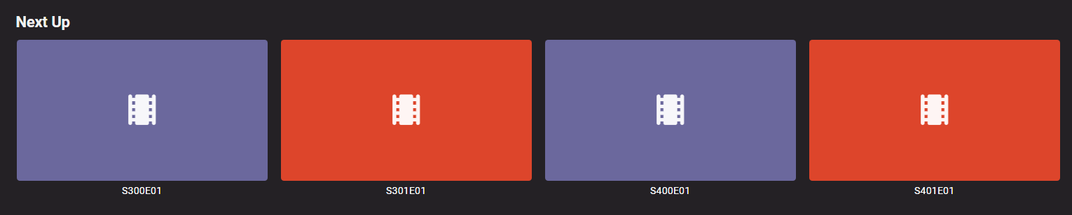

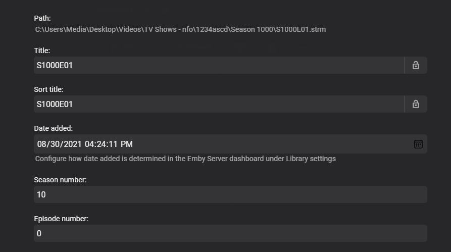

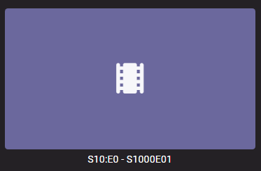

Happy2Play 9814 Posted September 9, 2021 Posted September 9, 2021 On 8/31/2021 at 9:36 AM, Luke said: Yes I see the issue, thanks. Fix episodes with season numbers greater than 200 (4.7.0.10) Slightly improved as S200 does work, but S300 thru S999 still have issues and S1000 get parsed to S10. No season/episode parsed S1000 as S10 1
