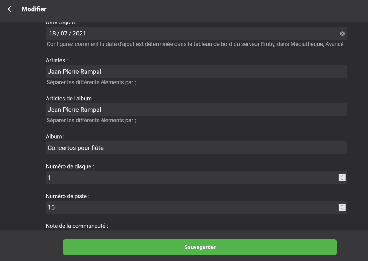

EtPvSyno 1 Posted August 27, 2021 Posted August 27, 2021 Hello, I couldn't find any information on this issue, so need your help (again). This is a bit strange but since this morning I can't save any changes in any media metadata . The "Save" Button is inactive. (it was ok yesterday) There is no error message, only the button stay frozen. I've tried several things: restarting Emby Server, then both my Synology and the Emby Server. The user's rights R/W are ok, there were no changes on the DSM recently. Version : EMBY 4.6.4.0 Synology DSM 7.0 using boh Chrome or Firefox. Log file attached. thank you for any help embyserver-etpv-24.07.txt

EtPvSyno 1 Posted August 29, 2021 Author Posted August 29, 2021 Hi @Luke have a good sunday my issue: still can't save metadata (save button is inactive/frozen) following @Happy2Play, I've created a task in my synology. Still have this in the server log : System.IO.IOException: System.IO.IOException: The configured user limit (8192) on the number of inotify watches has been reached, or the operating system failed to allocate a required resource. I've tried to excecute the same command line in SSH (root access), without success. I probably make a mystake somewhere.. sh -c '(sleep 90 && echo 204800 > /proc/sys/fs/inotify/max_user_watches)&' when i call "cat.... max_user_watches" .. still have 8192 as a reply. Please excuse me if not clear because of lack of coding kwnoledge or approximative english.

EtPvSyno 1 Posted August 31, 2021 Author Posted August 31, 2021 Here is the log from Google Chrome This appears when I click on 'save' changes on metadata : "An invalid form control with name='' is not focusable." I also copy/paste issues from the console in any case. app.emby.media-1630388034079.log Chrome issues.txt
