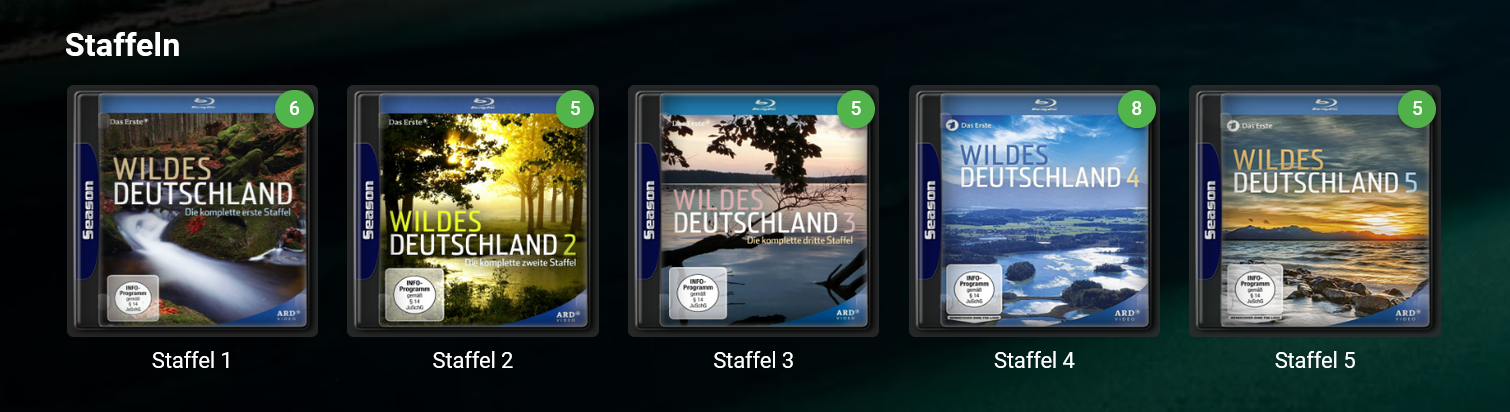

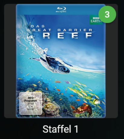

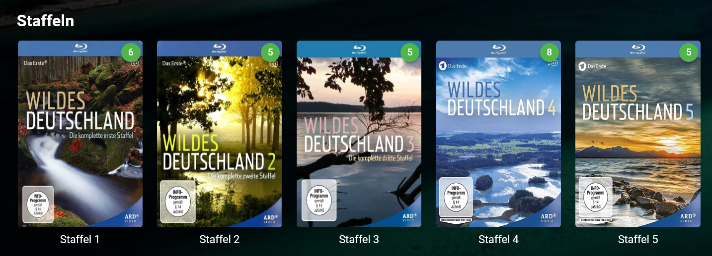

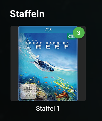

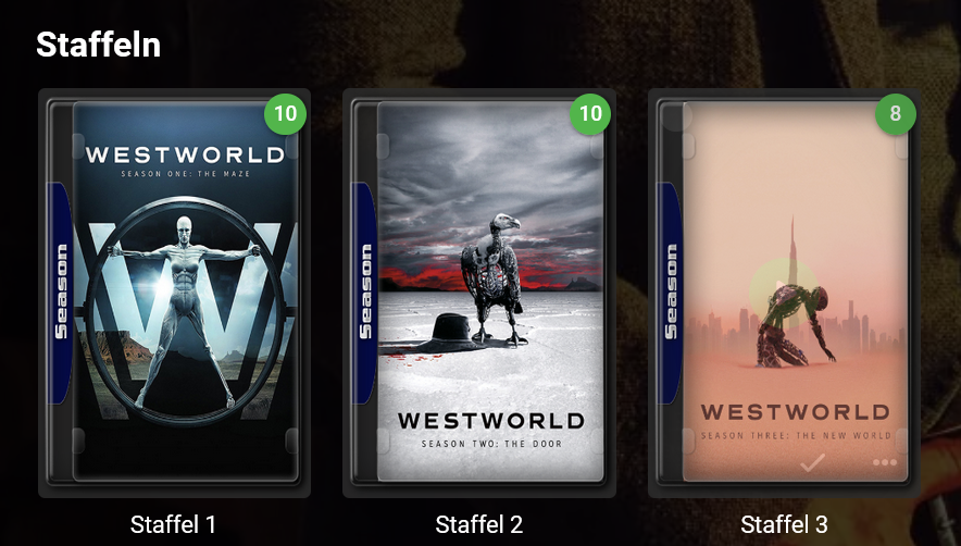

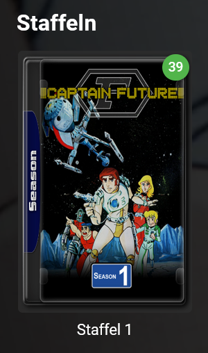

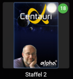

MatthiasM 6 Posted August 25, 2021 Posted August 25, 2021 Hello community I have 3 libraries active with my emby instance - 1 series for kids, 1 series for adults and 1 series documentation. With the 2 libraries for kids and adults the CA images looks cool with DVD and Blue Ray covers - like this: and but the documentation series looks different: DVD Blue Ray 4k Can someone tell me where the format of the images are triggered? The 3 libraries are set up the same way: Thanks Matthias

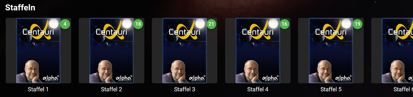

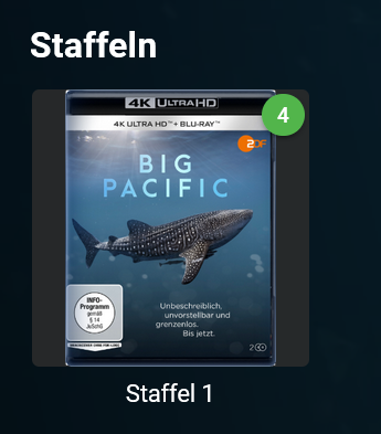

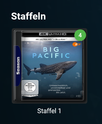

MatthiasM 6 Posted August 25, 2021 Author Posted August 25, 2021 Thx for the response but I think my english is to bad to describe my problem. Please let me make a reset and try an other perspective The graphically look of CA is different with my 3 libraries. 2 looks good in aspect ratio and transperancy of the corners of the cover art. (please ignore the scale of my screengrabb) 1 library has a different behavior with CA. the aspect ratio is sometimes right but there is a grey border with the cover art or the edges looks good but the aspect ratio is wrong. My question is what is wrong with this 3rd library? Why are the CA looks so bad compared to the other 2 libraries. Thx for your patience. Matthias
Happy2Play 9814 Posted August 25, 2021 Posted August 25, 2021 (edited) 25 minutes ago, MatthiasM said: 1 library has a different behavior with CA. the aspect ratio is sometimes right but there is a grey border with the cover art or the edges looks good but the aspect ratio is wrong. My question is what is wrong with this 3rd library? Why are the CA looks so bad compared to the other 2 libraries. Okay you are talking about a Series that does not have a Season image so it is inheriting the Series image, correct? So the same/similar happens without CoverArt plugin. Edited August 25, 2021 by Happy2Play
MatthiasM 6 Posted August 25, 2021 Author Posted August 25, 2021 @Happy2Playthat is not correct. some of the series in documentation habe season images but the negative look. I deinstall CA and take this screen shot as example with and without CA Thx Matthias

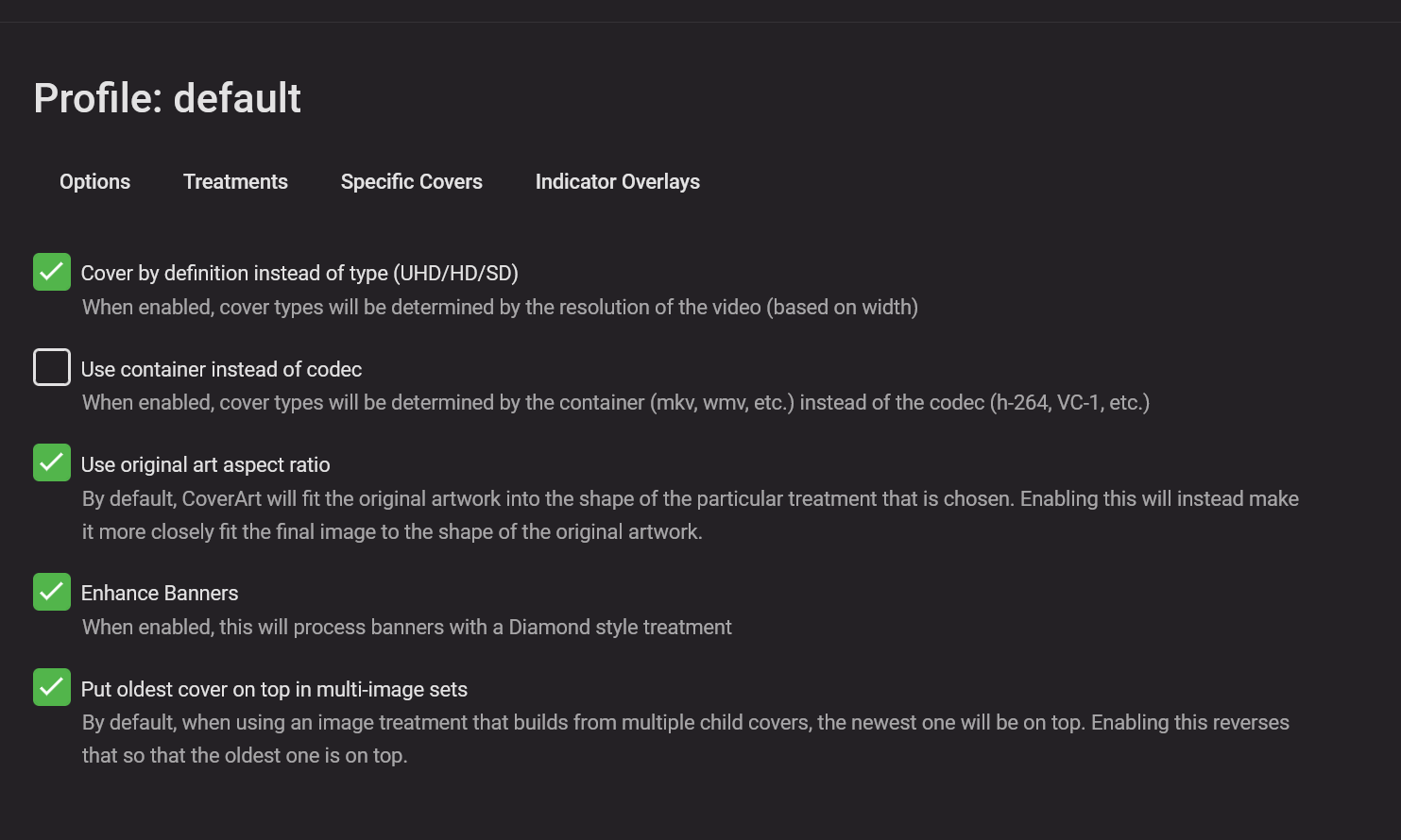

Happy2Play 9814 Posted August 25, 2021 Posted August 25, 2021 And what size is the image and as each treatment will act differently along with the "Use original art aspect ratio" option. Use original art aspect ratio By default, CoverArt will fit the original artwork into the shape of the particular treatment that is chosen. Enabling this will instead make it more closely fit the final image to the shape of the original artwork. But this image with the grey background showing should mean there is no Season image and this is the inherited Series image.

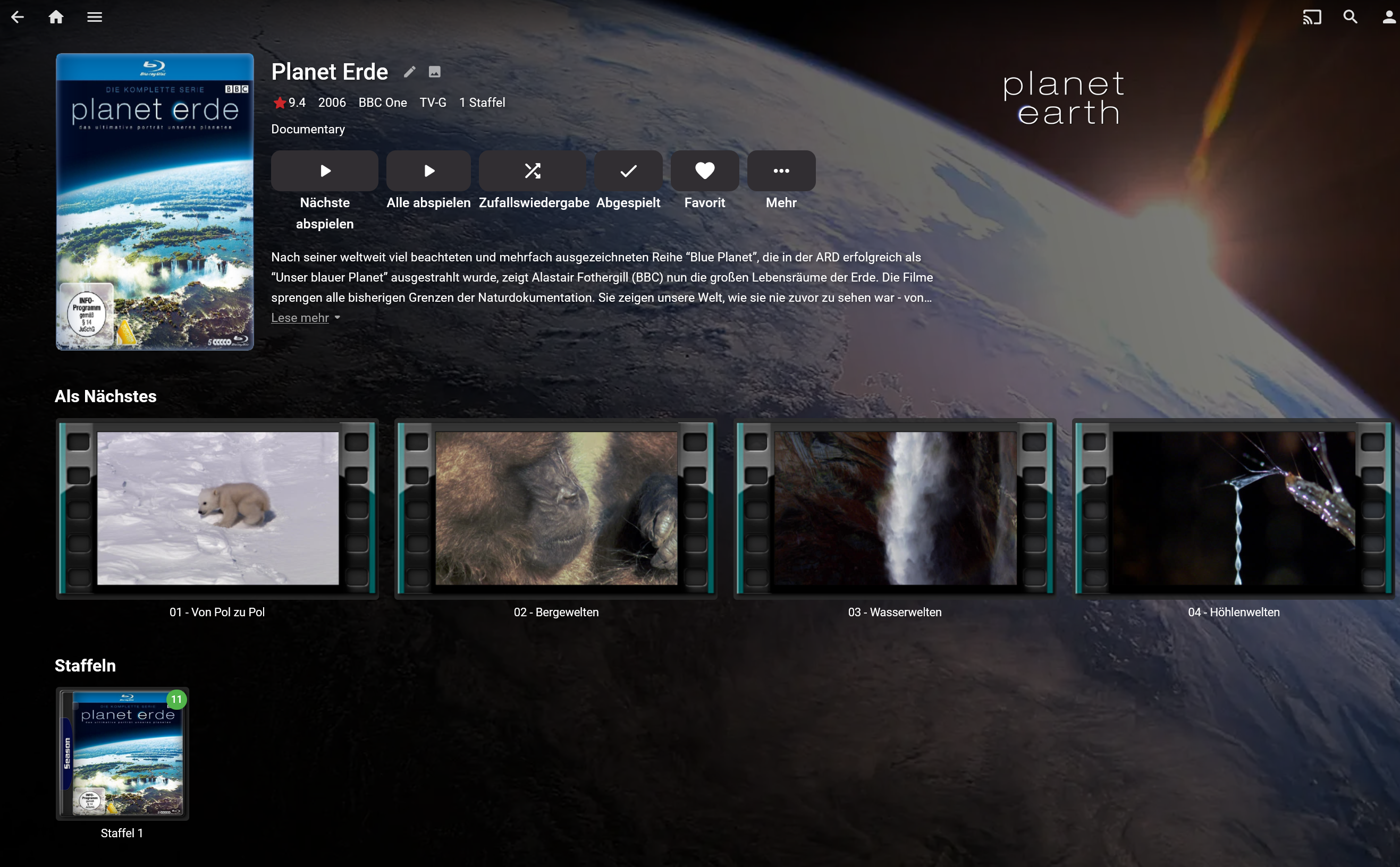

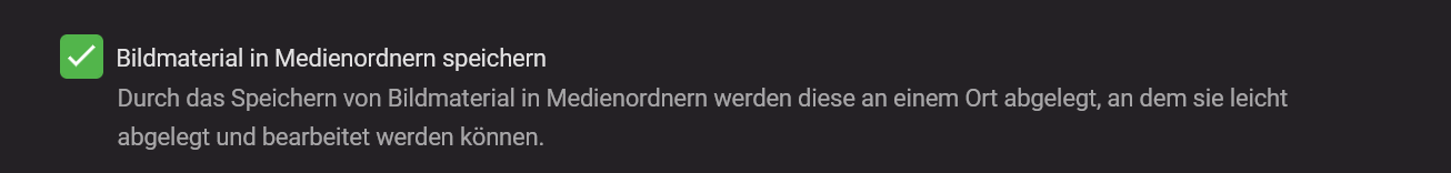

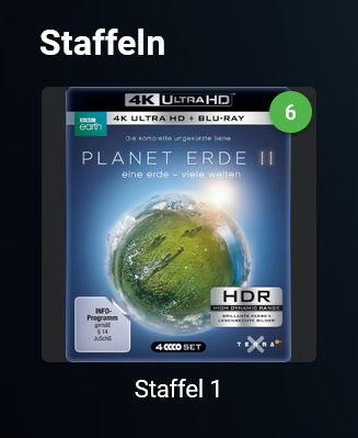

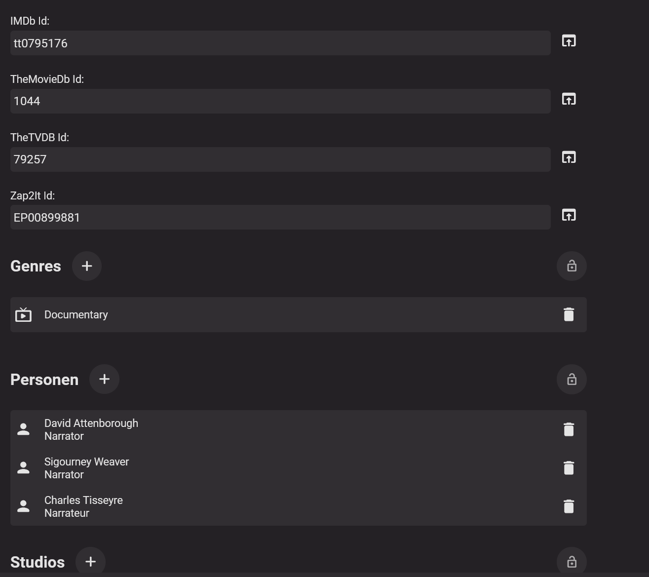

MatthiasM 6 Posted August 26, 2021 Author Posted August 26, 2021 (edited) Thx @ebr and yes, I'm sure that are real series indetified and have still this dissortion effect the the aspect ratio. This example is Planet Earth by Studio BBC One - 1 Season - and IDs in the emby DB I put a seasonal image in the folder as @Happy2Play mentioned but the Season Cover Art is still wrong displayed (aspect ratio). In That case I disover that emby didnt save such season images into the filesystem if I upload a .JPG with the web-interface. The image is only store in the emby DB. You have to put those images to the filesystem by yourself! @Luke this should be done by emby automaticly if the settings within the library are set to "place images into media folders". Thanks for your support gentlemen! Best reagrds Matthias Edited August 26, 2021 by MatthiasM
ebr 16346 Posted August 26, 2021 Posted August 26, 2021 It looks like those season posters are being double-treated. What do the original images look like? Also, did you check the option to "Use original art aspect ratio" in CA?
MatthiasM 6 Posted August 26, 2021 Author Posted August 26, 2021 The setting was already set to this option: and the origin image looks like thx Matthias

ebr 16346 Posted August 26, 2021 Posted August 26, 2021 That option exists for folks who want the treated image to stay the same shape as the original. The default should be "off" so that things like this don't happen and CA will normalize all the images to fit the treatment shape.
MatthiasM 6 Posted August 27, 2021 Author Posted August 27, 2021 thx for the explanaition @ebr but this function don't work as it sould as you can see with this example: -> CA do change the aspect ration of the cover art image depending on the aspect ratio of the orinal image. In this case to CD format. The setting "Use original art aspect ratio" is set to on. thx Matthias
ebr 16346 Posted August 27, 2021 Posted August 27, 2021 4 hours ago, MatthiasM said: CA do change the aspect ration of the cover art image depending on the aspect ratio of the orinal image Hi. Yes, because that's exactly what you told it to do: 4 hours ago, MatthiasM said: The setting "Use original art aspect ratio" is set to on. If you don't want that behavior, uncheck that option.
MatthiasM 6 Posted August 27, 2021 Author Posted August 27, 2021 thx @ebr I find a setting that works for me - "Use original art aspect ratio" set to off. While set to "on" CA don't represent the aspect ration of the original image. In my last post the y achsle of the cover art is compressed by factor 2. The left image is the original image stored in the filesystem, right is what CA build out of it. Sorry if I did a lot confusion whith this topic. Best regards Matthias
