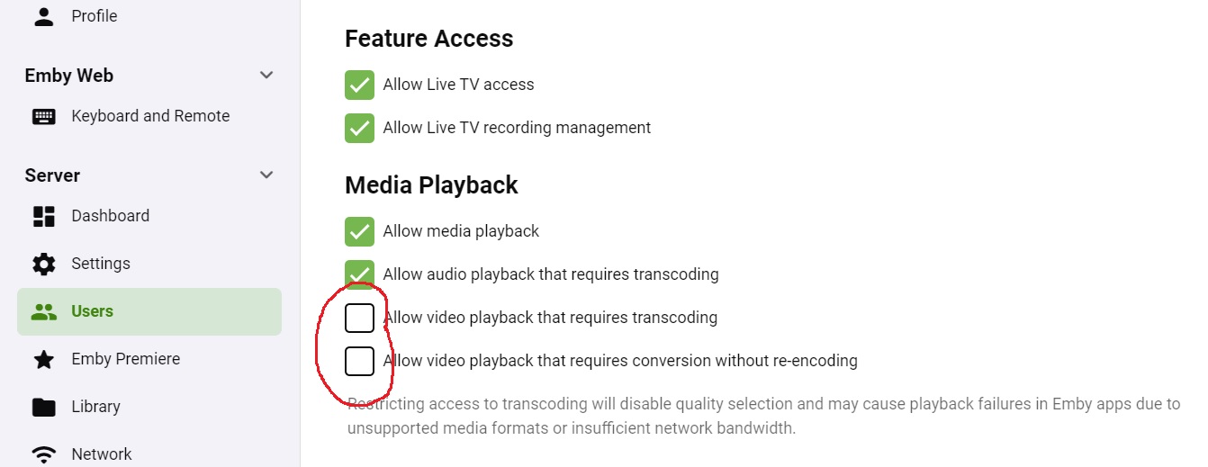

rodainas 191 Posted August 26, 2021 Posted August 26, 2021 36 minutes ago, Chenc033 said: Go to server settings, users, select user, go to media playback section, disable allow video playback that requires transcoding. 1
FrostByte 5454 Posted August 26, 2021 Posted August 26, 2021 The first one circled will stop transcoding video, the second will stop remuxing because of unsupported audio, etc.
