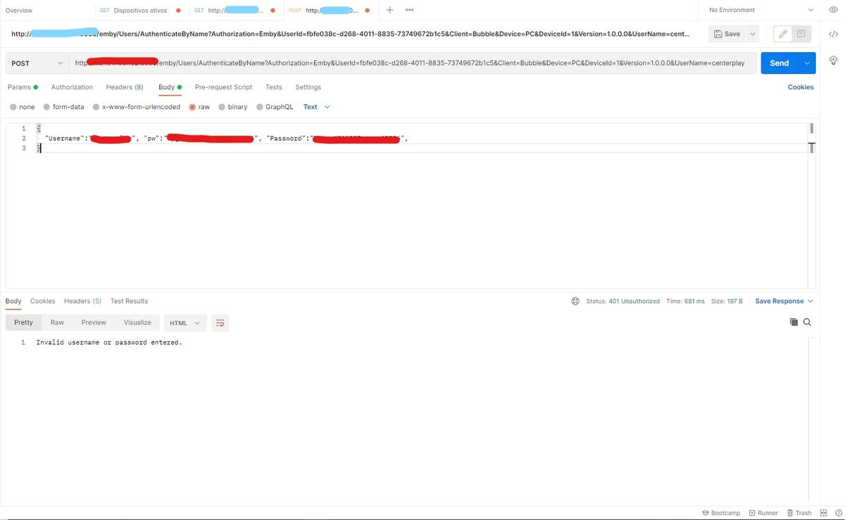

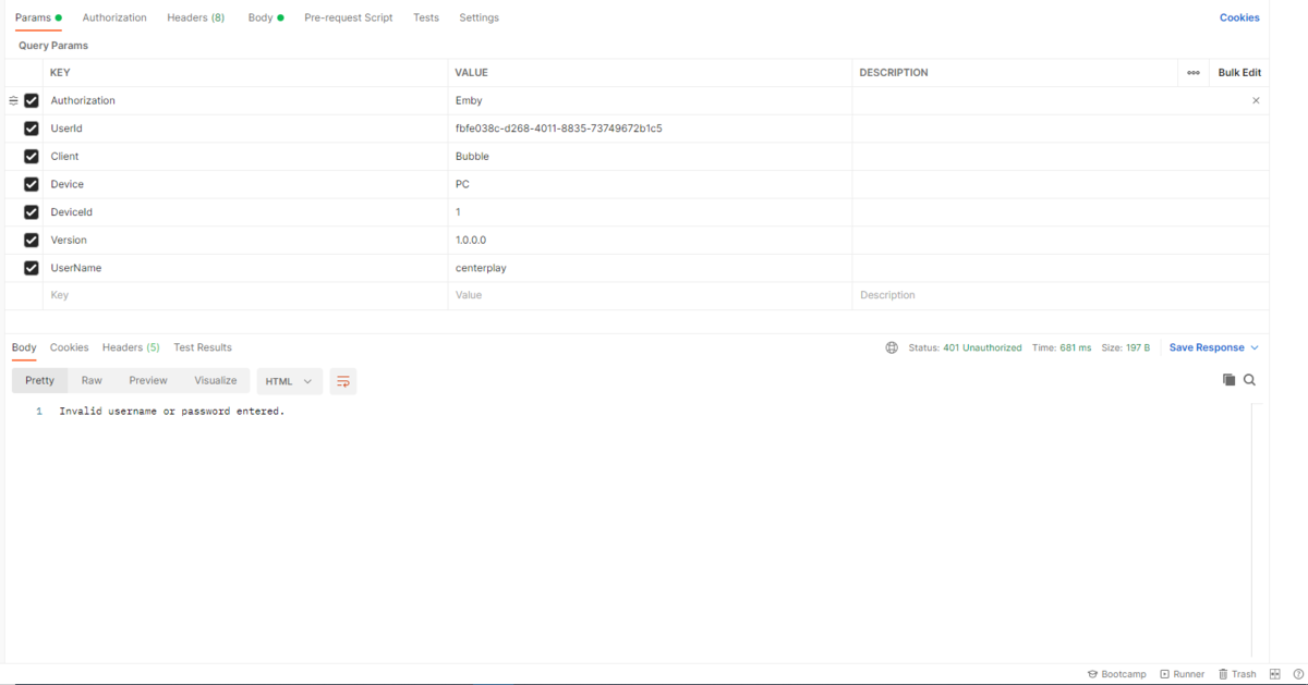

it seems to me that everything tends to go wrong hahaha, I want you to help me figure this out, I'm trying to get the answer from the call /user_usage_stats/session_list for that I have to have the authorization key. I need to post to /emby/Users/AuthenticateByName to get this key. I think I'm doing everything right, but now my return is "Invalid username or password entered." and not! the username and password are not wrong, I also tried to get the correct userid. can you help me point out what's wrong? I'm using postman and below are the images with everything as it was done

I just found this in the log, what can I be doing?
The authorization param that you have in the query string needs to be in the header.
The wiki I've linked you to in other topics goes over all of this.
