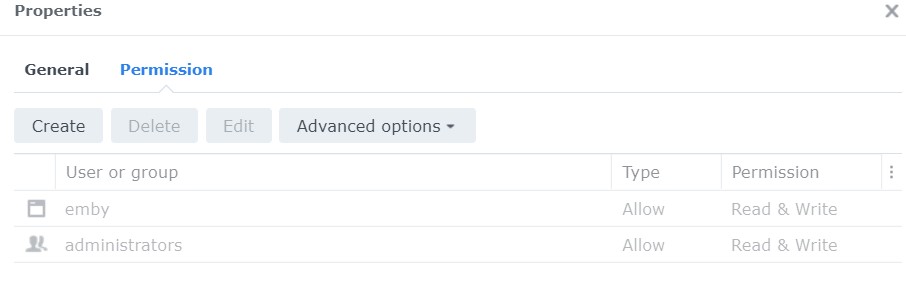

jonwolds 3 Posted August 24, 2021 Posted August 24, 2021 (edited) Hi, All permissions for emby are working fine except for open subtitles which cannot write to my movie folder. If i download subtitles through the meta data manager they work. 1) the emby user has full control of the movie folder this is also inherited to all subfolders Im totally out of ideas and am now working on the basis that maybe because the emby service account is called "emby" and not "embysvr" open subtitles has an issue with that. Screenshots below. I've been digging into this for hours so would really appreciate some support. Thanks Edited August 24, 2021 by jonwolds
Carlo 4561 Posted August 24, 2021 Posted August 24, 2021 DSM 7 doesn't use those permissions. You need to modify the system internal emby user and give it read/write access to the share. 1
jonwolds 3 Posted August 24, 2021 Author Posted August 24, 2021 Apologies, I forgot to include that screengrab. It is already set. Thanks
Carlo 4561 Posted August 24, 2021 Posted August 24, 2021 Can you try it again and post a new log? You may need to check to make sure permissions are inherited.

jonwolds 3 Posted August 25, 2021 Author Posted August 25, 2021 (edited) Thanks for the offer of a remote session but if it's ok I'd like to check a few more things first. I'm confident the permissions are set correctly on the system internal user account "emby" and all other functionality is working apart from opensubtitles. There are no issues with subtitle downloads when done from meta data manager. Attached is the view of the folder permissions in WinSCP in case that sheds any light. In Synology the "admin" account is disabled and no permissions are assigned to the guest account. Apart from the emby internal user, permissions are granted via the administrators group (i.e. full permissions). No permissions are granted or denied to the "users" group. Edited August 25, 2021 by jonwolds
Carlo 4561 Posted August 25, 2021 Posted August 25, 2021 I would look at this with File Station on the media folder that would hold the subtitle.
jonwolds 3 Posted August 25, 2021 Author Posted August 25, 2021 (edited) That's included in the screenshots earlier in the thread. Granting the emby internal account share permissions means the permissions show in file station as inherited right down into the movie name folder (where the Emby logs a permissions error when trying to write a subtitle). On the assumption I have the permissions set correctly is what would be the next step - backup, uninstall, reinstall, restore? It seems very weird that emby adds the subtitle successfully via metadata manager but gets a permissions error using the scheduled task. Edited August 25, 2021 by jonwolds
