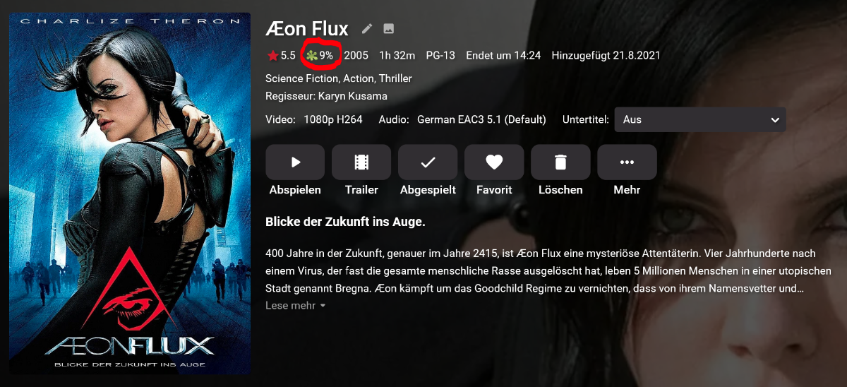

Florian2000 17 Posted August 21, 2021 Posted August 21, 2021 Hi, die Kritikerbewertung (im Bild unten rot markiert) ist seit der Umstellung auf die DSM 7 bei den neuen Filmen ersichtlich...bei allen älteren Filmen, die davor eingespielt wurden, ist keine Kritikerbewertung ersichtlich. Wovon hängt diese Darstellung ab und lässt es sich für die früher eingespielten Filme ebenfalls aktivieren? Oder ist das von etwas anderem abhängig? Vielen Dank! Schöne Grüße Florian
ebr 16334 Posted August 21, 2021 Posted August 21, 2021 Hi. That is the Rotten Tomatoes rating and, I believe, it comes from the OMDb metadata provider.
Florian2000 17 Posted August 21, 2021 Author Posted August 21, 2021 well, thing is...it is only shown by movies which are added since I'm on DSM 7...all the other movies which I added with DSM 6.x don't have this "critics rating" <-- question is: why is this so? Do I have to re-initialize anything so that the "older" movies also show the "critics rating"?
Solution Carlo 4561 Posted August 22, 2021 Solution Posted August 22, 2021 I would try a meta-data refresh on a couple of these movies to see if that pulls in the info. If that works you could do a library refresh of meta-data from the 3 dot menu of the library.
Florian2000 17 Posted August 23, 2021 Author Posted August 23, 2021 (edited) yes, this has helped. I tried to refresh the metadata of some movies and yes, the missing "critics rating" was shown after the refreshment. So I would assume when I do perform a refresh of the whole library it will be done for almost every movie where a critics rating is available. Thx! Edited August 23, 2021 by Florian2000 1
Carlo 4561 Posted August 23, 2021 Posted August 23, 2021 Great, let us know when you try this library wide. Do note depending on size of your library it will take a while. Perfect job to start before you go to bed.
