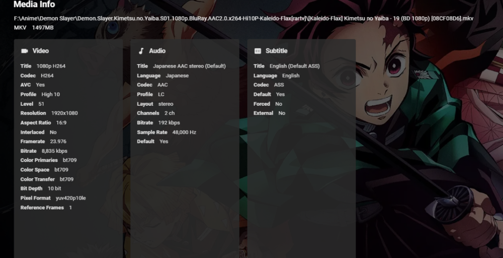

Riptide126 24 Posted August 18, 2021 Posted August 18, 2021 Direct play Demon Slayer S1 E19 Hinokami playing it in google chrome embyserver.txt

RanmaCanada 501 Posted August 18, 2021 Posted August 18, 2021 I would just like to add that this is a hi10p file which NOTHING can do in hardware, so the file will have to be transcoded. If you are trying to play it back on a device that will play h264 files in hardware, the server will be "stupid" and think that the device can play it back properly and it will cause it to stutter, lag and just become a horrible mess. Stop using hi10p, period, 3
rbjtech 5337 Posted August 18, 2021 Posted August 18, 2021 5 minutes ago, RanmaCanada said: I would just like to add that this is a hi10p file which NOTHING can do in hardware, so the file will have to be transcoded. If you are trying to play it back on a device that will play h264 files in hardware, the server will be "stupid" and think that the device can play it back properly and it will cause it to stutter, lag and just become a horrible mess. Stop using hi10p, period, Agreed - Level 5.1 is also completely unnecessary for a 1080p/23.976 file (4 or 4.1 should be used) - a lot of players will reject it on this fact alone ... 2
