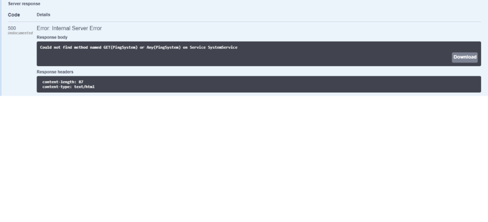

hygorfragas 5 Posted August 15, 2021 Posted August 15, 2021 Hello sorry for the translated english. i'm trying to capture a ping response via api and my response is always an error. everything is fine with the other calls! all working! only the ping returns me error 500 and I don't understand why! even inside the swagger UI i got error 500 as an answer! my intention is to capture a ping to validate that the server is online, and also validate that the api connection was successful, do you have another option to do this? or how to solve the 500 error in the ping capture. Thank you all, a great job.

hygorfragas 5 Posted August 15, 2021 Author Posted August 15, 2021 Think it might be something with the server?
Luke 42237 Posted August 16, 2021 Posted August 16, 2021 Hi, yes I see the issue. It will be resolved for the next release. In the meantime, try sending a post to that endpoint instead of get. 1
