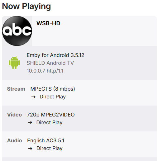

Tigga5 39 Posted October 31, 2025 Posted October 31, 2025 (edited) On 5/27/2025 at 11:57 PM, Luke said: Hi, if you go into the app's playback settings and you force a conversion on mpegts, then this will give you the behavior that you want. This will change the way the server packages the live stream and will make it more seekable. Please let us know if this helps. Thanks. It's hard to believe that such a fundamental live TV feature depends on a workaround most users would never stumble across or associate together. It’d make a big difference if this behavior were just built in or exposed as a clear “Enable Time Shifting” setting somewhere in playback options rather than this obscure work-around. Logically it seems like the existing "Prefer direct streaming of Live TV" setting should already do this if it's disabled. I've disabled that, but the dashboard still shows Direct Play, so it’s unclear what that setting actually does, if anything. I also tested forcing conversion on mpegts as suggested. It technically works, but it’s unstable and playback freezes easily if you fast forward too much, and the whole experience just seems janky compared to the old app. None of this is an issue with the Emby for Android TV app, Plex, or Channels DVR, so it does seem specific to the Universal app’s handling of live streams. Edited October 31, 2025 by Tigga5

Tigga5 39 Posted October 31, 2025 Posted October 31, 2025 14 minutes ago, Luke said: The latest version of the app has a dedicated direct stream live TV setting that you can use instead so that you don’t have to force conversion on all mpegts. Is there a different setting besides the one I originally mentioned? Quote Logically it seems like the existing "Prefer direct streaming of Live TV" setting should already do this if it's disabled. I've disabled that, but the dashboard still shows Direct Play, so it’s unclear what that setting actually does, if anything.
