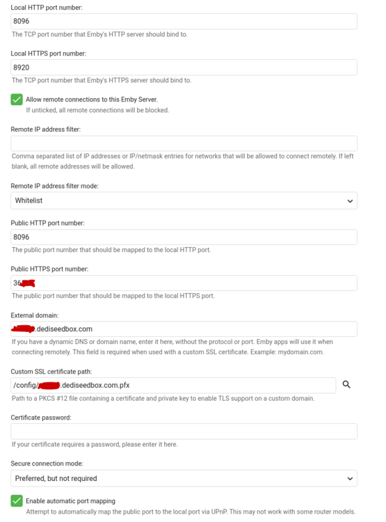

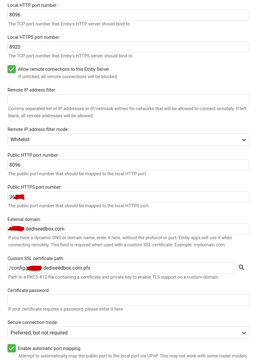

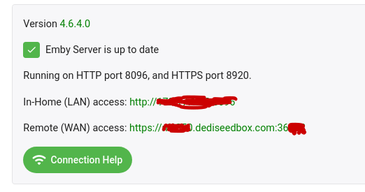

thenoog85 0 Posted August 15, 2021 Author Posted August 15, 2021 I'm adding some screenshots to try and make it a bit clearer. So Dediseedbox gave me this URL to access my Emby Server install from a browser. I've blanked out any particularly sensitive info, but this is where I first come across this 36xxx port number. I assume this is the public https port which is mapped to 8920 on their end. This is how my dashboard looks. The LAN IP address supplied is different from the IP address I was supplied by Dediseedbox to access my content. Is that normal? I assume so, because the IP address they have given me to access my content is a public one, but Emby is seeing the local one assigned where Dediseedbox has been installed? Secondly, the WAN port number is showing as 36xxx only because I have made that change in the settings from the default of 8920 which you can see in the third photo below. Here you can see the change I've made in the public https. However, even when left as 8920 I'm getting exactly the same problem. These settings can't be far wrong if I'm able to connect from some devices and not others. Am I to assume this will be an SSL issue at this stage or is there something I'm definitely doing wrong from what you can see? I can only assume local port 8920 is open/forwarded at Dediseedbox's end seeing as I can connect from some devices. If I use a port checker tool online with the domain https://xxxxx.dediseedbox.com and port 36xxx it reports it as opened. If i replace 36xxx with either 8920 or 8096 it reports "blocked". Not sure if that's any indication. It looks like the only public port they have opened for me is 36xxx.
