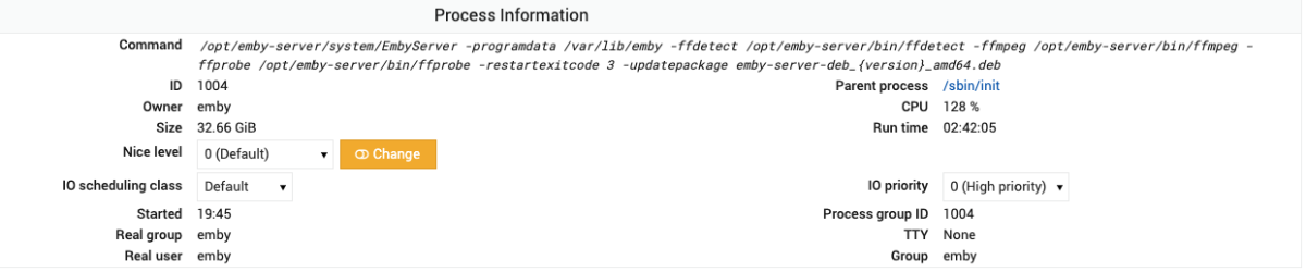

iBoss 31 Posted August 14, 2021 Posted August 14, 2021 Hi all Suddenly my emby server start to consume the RAM without anybody use it. I have restarted the server but still, after some time of starting emby the use of RAM increasing dramatically. And because of this I can not use emby, it became very slow or hung. OS: Ubuntu Linux 16.04.7 emby server: 4.6.4.0 The screenshots and log are attached Thanks hardware_detection-63764567156.txt embyserver.txt

Happy2Play 9813 Posted August 17, 2021 Posted August 17, 2021 (edited) Don't use this platform but how are those stats not wrong, how do you use 798.3% of a CPU? Where in the first image show 274% then the image below it say Emby is using 128%. So something does not add up to me. Edited August 17, 2021 by Happy2Play
iBoss 31 Posted August 17, 2021 Author Posted August 17, 2021 1 minute ago, Happy2Play said: Don't use this platform but how are those stats not wrong, how do you use 798.3% of a CPU? I dont now why is 798.3% ... but not always the cup is very high like this; the most issue with RAM. what do you mean by "Don't use this platform"? thanks
Happy2Play 9813 Posted August 17, 2021 Posted August 17, 2021 2 minutes ago, iBoss said: what do you mean by "Don't use this platform"? I am a Windows users so some of this is just a foreign language to me. But most stuff is really platform irrelevant. So a fellow platform user would have to comment as those number would be totally wrong in my eyes.
iBoss 31 Posted August 17, 2021 Author Posted August 17, 2021 @Happy2Play the attached screenshot from webmin is 94.7%
iBoss 31 Posted August 17, 2021 Author Posted August 17, 2021 Even this percentage not accurate/wrong but all leads to one thing, the usage of RAM and CUP is definitely very high and make whole the OS hung
