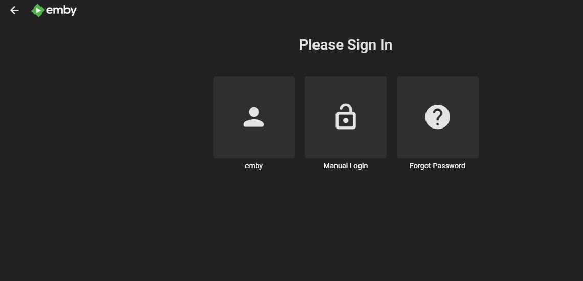

HiloGuy1971 0 Posted August 14, 2021 Posted August 14, 2021 Emby installs on my DS216J but the wizard not working to configure emby i have uninstalled and installed several times and still no dice'here is a screenshot none of the tabs are working for me please help
Luke 42243 Posted August 14, 2021 Posted August 14, 2021 Hi there @HiloGuy1971, what exactly is not working? Can you please describe the issue in more detail? Thanks.
HiloGuy1971 0 Posted August 14, 2021 Author Posted August 14, 2021 after i install Emby then i go to local it auto goes to that screen i posted earlier and i cant not configure the emby server
Happy2Play 9812 Posted August 14, 2021 Posted August 14, 2021 3 minutes ago, HiloGuy1971 said: after i install Emby then i go to local it auto goes to that screen i posted earlier and i cant not configure the emby server But that image would suggest the wizard has already been run. Can't you login to do any additional configuration? But I guess you could run it again. http://{LANIP}:8096/web/index.html?start=wizard#!/wizard/wizardstart.html 1
Luke 42243 Posted August 14, 2021 Posted August 14, 2021 Right, it looks like you've already completed the wizard.

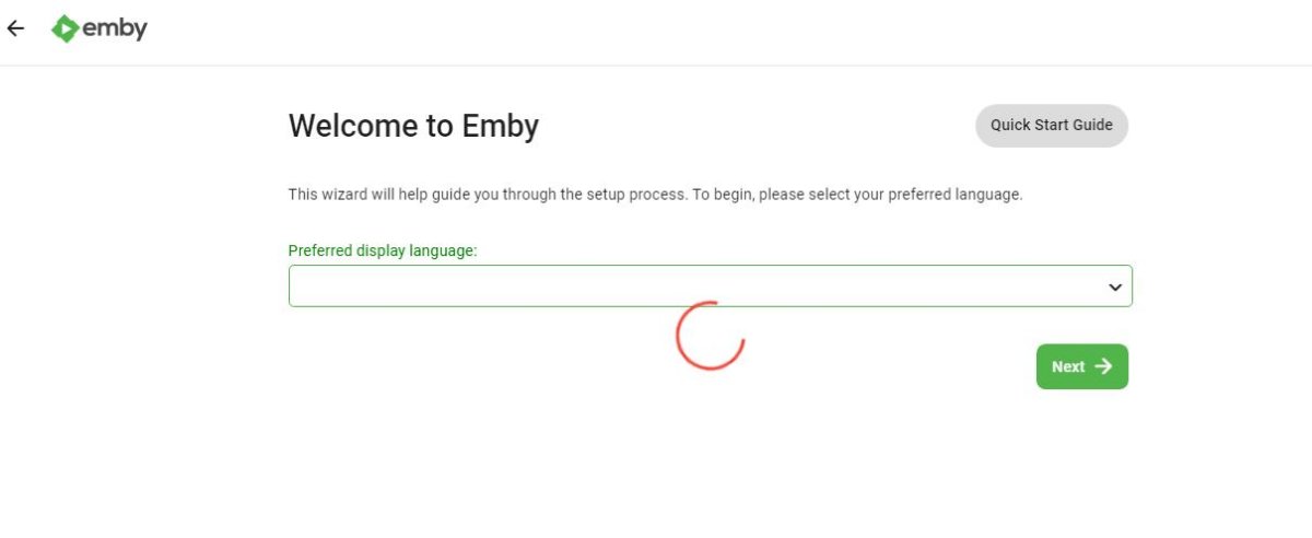

HiloGuy1971 0 Posted August 14, 2021 Author Posted August 14, 2021 thats the problem thats what comes up i dont even get to the wizard my Emby server works on my 2019 server but not on my Synology but im gonna try ur link and i will put in my ip i tried youre theory didnt work all i get is a spinning circle and i cant even select the language will post picture as well and when i install emby this link is already there and i never done anything to the wizard it dont let me get to that point

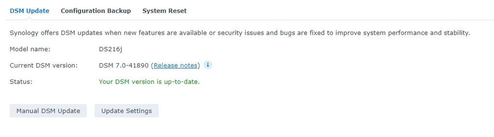

Carlo 4561 Posted August 14, 2021 Posted August 14, 2021 You may want to remove the config folders and then reinstall 4.6.4 version of the Server. What version of DSM are you running?

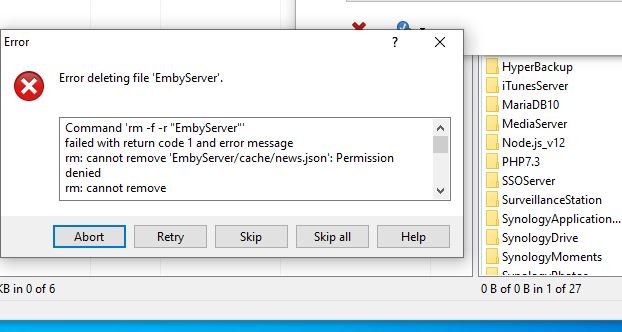

HiloGuy1971 0 Posted August 15, 2021 Author Posted August 15, 2021 uninstalled from the package manager but when i ssh in to remove /volume1/@appdata/EmbyServer i get this wished you could remote in Spoiler
Carlo 4561 Posted August 15, 2021 Posted August 15, 2021 You need to SSH into the NAS then go root with sudo -i then remove the folder

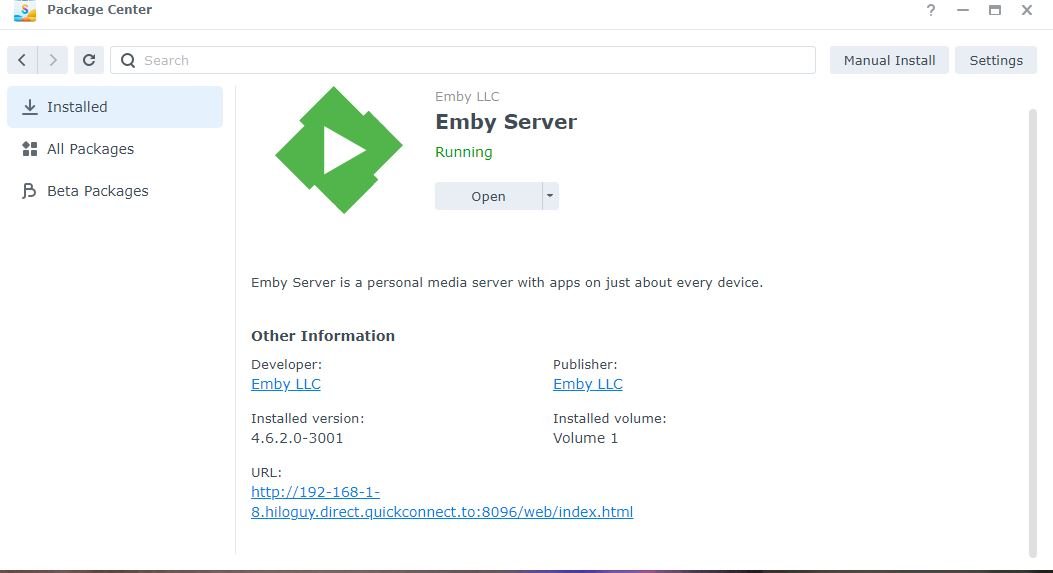

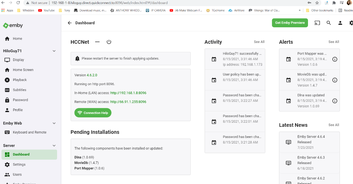

HiloGuy1971 0 Posted August 15, 2021 Author Posted August 15, 2021 @Cayars,@Luke,@Happy2play the last post Cayars gave me did the trick its up and running here is a screen shot
Carlo 4561 Posted August 15, 2021 Posted August 15, 2021 9 minutes ago, HiloGuy1971 said: @Cayars,@Luke,@Happy2play the last post Cayars gave me did the trick its up and running here is a screen shot Nicely done. Glad you got this working again!
