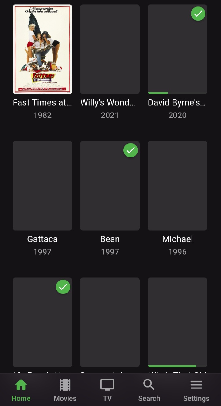

ebr 16338 Posted September 2, 2021 Posted September 2, 2021 18 hours ago, Scott310 said: I dont know if my issue is related but I am seeing this too. Hi. Please cause the issue and then send a log from the app. Thanks.
Scott310 137 Posted September 2, 2021 Posted September 2, 2021 Ok I caused the issue and sent logs at 6:33 central time. Thanks for your help.
ebr 16338 Posted September 3, 2021 Posted September 3, 2021 14 hours ago, Scott310 said: Ok I caused the issue and sent logs at 6:33 central time. Can you please post the server log that corresponds with that? Thanks.
Scott310 137 Posted September 3, 2021 Posted September 3, 2021 (edited) embyserver-63766110009.txt This log file was from around the time I sent the logs. Let me know if you need a different one. Edited September 3, 2021 by Scott310
Scott310 137 Posted September 3, 2021 Posted September 3, 2021 I just noticed that if I go to the server and do a replace all Metadata including images it gets fixed on the fire tv app. Maybe I'll have to go through the whole library fixing the ones that are having issues on fire tv.
ebr 16338 Posted September 3, 2021 Posted September 3, 2021 1 hour ago, Scott310 said: embyserver-63766110009.txt 2.72 MB · 0 downloads This log file was from around the time I sent the logs. Let me know if you need a different one. The app log was sent on Sep 2nd and this log is from Sep 1st. The app log is showing a weird error related to the format of the image and also an error on some basic operations with your server so I'd like to see if I can tie those back to the server log. Thanks.
Scott310 137 Posted September 3, 2021 Posted September 3, 2021 (edited) Oh my bad I tried to send two logs and one of them (the one from the day I sent app logs) exceeded the file size to upload. Do you want me to send a new log? I'm curious about the "basic functions of your server error" I had some startup issues with windows 10 and had to do a startup repair. But then I was having issues with my the emby beta software. So I decided to scrap everything and do a fresh install of the emby stable release. All of my library is on an external drive with the Metadata and images. Edited September 3, 2021 by Scott310
ebr 16338 Posted September 4, 2021 Posted September 4, 2021 Hi. I was hoping to see a specific error that was in that app log (server threw a 500 error trying to retrieve the user list) and then also to possibly tie back any image errors. But, it sounds like maybe there is possibly a corruption issue with your images. 18 hours ago, Scott310 said: I just noticed that if I go to the server and do a replace all Metadata including images it gets fixed on the fire tv app It may be that the images in your server image cache are corrupted somehow and the above procedure invalidates them causing them to be recreated. The reason you would only see this in the one app is that images are cached on the server at the display resolution and that may be slightly different in this app from others - therefore, different image in the cache.
Scott310 137 Posted September 4, 2021 Posted September 4, 2021 The images were all fine when I was on beta but this only happened when I uninstalled beta and switched back to stable. When I uninstalled the beta I didnt do a complete uninstall. Maybe that is the issue? Should I just recreate all the images or do a complete uninstall and do a fresh install of the stable server you think?
Carlo 4561 Posted September 4, 2021 Posted September 4, 2021 You could try deleting the cache and allowing it to be recreated.
Scott310 137 Posted September 5, 2021 Posted September 5, 2021 6 hours ago, cayars said: You could try deleting the cache and allowing it to be recreated. Sadly I already tried that and uninstalled the app as well.
Carlo 4561 Posted September 5, 2021 Posted September 5, 2021 I'm referring to the server cache not the app cache in case that wasn't clear.
Scott310 137 Posted September 5, 2021 Posted September 5, 2021 16 hours ago, cayars said: I'm referring to the server cache not the app cache in case that wasn't clear. Oh my bad. I will try that. That would definitely be easier than manually recreating the images.
Happy2Play 9813 Posted September 5, 2021 Posted September 5, 2021 If it is a corrupt cache on the server, you would delete "C:\Users\username\AppData\Roaming\Emby-Server\programdata\cache\images".
Scott310 137 Posted September 7, 2021 Posted September 7, 2021 (edited) So I deleted the image cache and it did not resolve the issue. I did a refresh Metadata (replace all images) at I'm still getting missing posters. Not sure what is causing this. Now I'm seeing the issue on the web client too for Android. But every single poster shows up correctly in my android app. Edited September 7, 2021 by Scott310
ebr 16338 Posted September 7, 2021 Posted September 7, 2021 25 minutes ago, Scott310 said: Now I'm seeing the issue on the web client too for Android. But every single poster shows up correctly in my android app. So maybe this is a more systemic issue and the ones that are working are being pulled from a local cache...
Scott310 137 Posted September 7, 2021 Posted September 7, 2021 I'm wondering if at this point I should just completely uninstsll and start over from scratch. At least I can backup my settings.
Luke 42246 Posted September 8, 2021 Posted September 8, 2021 9 hours ago, Scott310 said: So I deleted the image cache and it did not resolve the issue. I did a refresh Metadata (replace all images) at I'm still getting missing posters. Not sure what is causing this. Now I'm seeing the issue on the web client too for Android. But every single poster shows up correctly in my android app. Please attach the emby server log from this time. Thanks.
Scott310 137 Posted September 13, 2021 Posted September 13, 2021 (edited) sorry I've been busy the last few days and haven't been able to sit down and do this. It looks like the furthest back log I have is 9/9. If you need updated logs let me know. I'm starting to see other issues pop up and and considering wiping everything from the machine and starting over with a completely fresh install. IMGLOG.txt Edited September 13, 2021 by Scott310
Scott310 137 Posted September 14, 2021 Posted September 14, 2021 Ok so I just ended up wiping the machine of all traces of emby and installed fresh. Restored from my configuration backup and did a library scan. So far this seems to have fixed the issue. Thanks again for the help. 1
