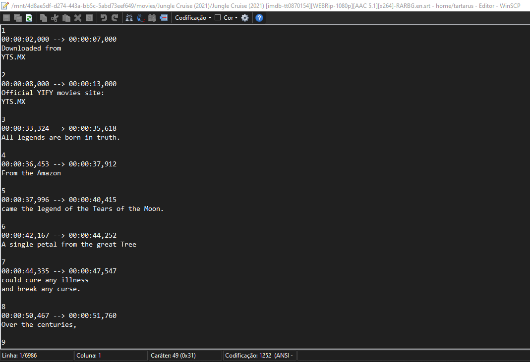

Carlo 4561 Posted August 10, 2021 Posted August 10, 2021 Hi, Have you checked to make sure the SRT files have content in them and not zero size files?
gulyfmg 3 Posted August 10, 2021 Author Posted August 10, 2021 Hi @cayars, Just did that. The strange thing is if i cast the same movie with the same SRT from my phone i don't have this problem.
Carlo 4561 Posted August 10, 2021 Posted August 10, 2021 Hi, so what happens if you playback in the web app and show stats for nerds? What is shown?

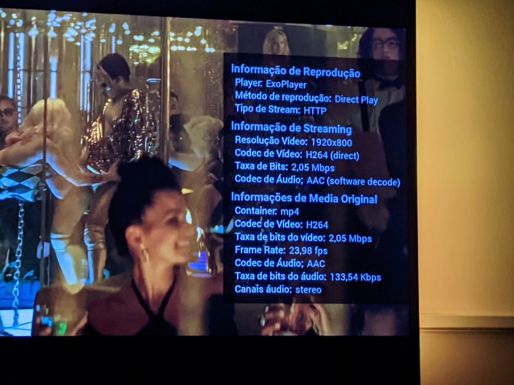

gulyfmg 3 Posted August 11, 2021 Author Posted August 11, 2021 (edited) Hello again sorry for the late reply... @cayars I did a couple more test always the same behaviour. If I play directly from the box the subtitles are not displayed. I then use the emby app to cast to the mi box and the subs were shown as expected. This was my stats for nerds. @ebr the subs were not working... Those logs were from the browser because it was showing the same behaviour, and it was easy to respond and extract the logs. The new logs I'm attaching are fresh I reboot the server play a movie and no subs were displayed... I then used the emby app on the box to download and still no subs. I then used my phone to cast to the box and the subs were displayed correctly. embyserver.txt Edited August 11, 2021 by gulyfmg Typos
