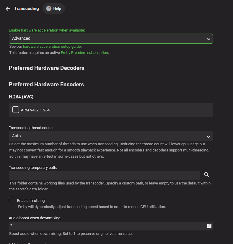

griam01 14 Posted August 11, 2021 Author Posted August 11, 2021 I just re-enabled the hardware acceleration and here are the two new log files generated after I tried to play the show again. It seemed a few seconds faster this time. ffmpeg-transcode-b12a3357-7dab-483f-afbf-b1b70d22438f_1.txt embyserver(2).txt
Carlo 4561 Posted August 11, 2021 Posted August 11, 2021 That didn't use any hardware transcoding. Can you show us what your Transcoding menu looks like? Change the first option to Advanced.
griam01 14 Posted August 11, 2021 Author Posted August 11, 2021 Here are the menu options when set to advanced
Carlo 4561 Posted August 11, 2021 Posted August 11, 2021 You could try and enable the ARM H.264 option shown above but it really looks like your NAS doesn't really have the power to transcode via hardware or software. In situations like this it's probably best to make sure all your media is in a format that can direct play around the house/LAN and to be careful with remote sharing as they too will need to direct play all files as well.
