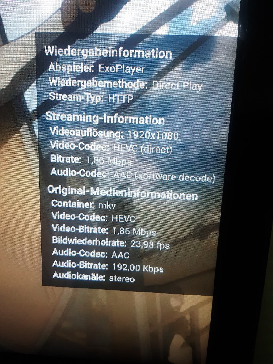

Deathmo 4 Posted August 14, 2021 Posted August 14, 2021 (edited) On 8/6/2021 at 8:19 PM, herki said: Don't have the logs yet - but users have been increasingly getting black screen with just audio. Try to tell them to trancode down to 2/1Mbps - no help, and usually playback error Everytime I check the filetype its HEVC and its non 4k sticks. Anybody else seeing this? Same Problem. Got an update from Amazon App store to 2.0.33 and since then I have this problem. I than side loaded 2.0.36 but still same Problem. Before the Amazon Store update everything played just fine. I have also a non 4K Stick 2 gen. ffmpeg-transcode-6091636d-d4c1-406e-80f0-cc1ea94bf295_1.txt ffmpeg-transcode-2b65a6f3-40d2-4a02-ba9c-10abcbe0a658_1.txt Edited August 14, 2021 by Deathmo

Deathmo 4 Posted August 14, 2021 Posted August 14, 2021 (edited) Ok now I got one This is without Hardware decoding and subs off, like you requested ffmpeg-directstream-3848f105-0257-4770-8151-506a532da3e3_1.txt Edited August 14, 2021 by Deathmo
