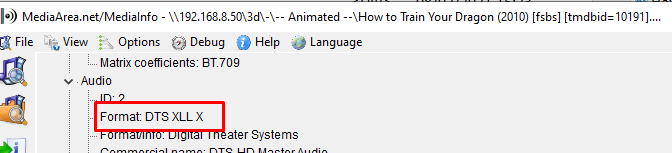

Miggies 0 Posted August 5, 2021 Posted August 5, 2021 Hi IT appears Emby Server doesn't pick up DTS:X in the metadata As you can see below MediaInfo see the DTS:X ( I've tested numerous movies and the format is DTS XLL X ) And the movie selection shows it as DTSHDMA

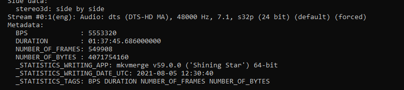

Happy2Play 9802 Posted August 5, 2021 Posted August 5, 2021 You can not really compare to what mediainfo sees as we use ffmpeg/ffprobe. Isn't this a limitation of what ffmpeg/ffprobe is seeing? Quote Stream #0:1(eng): Audio: truehd, 48000 Hz, 7.1, s32 (24 bit) (default) Metadata: title : Dolby TrueHD/Atmos Audio / 7.1 / 48 kHz / 3312 kbps / 16-bit BPS-eng : 3312566 DURATION-eng : 01:44:04.072000000 NUMBER_OF_FRAMES-eng: 7492886 NUMBER_OF_BYTES-eng: 2585487690 Stream #0:2(eng): Audio: ac3, 48000 Hz, 5.1(side), fltp, 448 kb/s Metadata: title : Compatibility Track / Dolby Digital Audio / 5.1 / 48 kHz / 448 kbps BPS-eng : 448000 DURATION-eng : 01:44:04.096000000 NUMBER_OF_FRAMES-eng: 195128 NUMBER_OF_BYTES-eng: 349669376 Quote Audio #1 ID : 2 Format : MLP FBA 16-ch Format/Info : Meridian Lossless Packing FBA with 16-channel presentation Commercial name : Dolby TrueHD with Dolby Atmos Codec ID : A_TRUEHD Duration : 1 h 44 min Bit rate mode : Variable Bit rate : 3 313 kb/s Maximum bit rate : 5 016 kb/s Channel(s) : 8 channels Channel layout : L R C LFE Ls Rs Lb Rb Sampling rate : 48.0 kHz Frame rate : 1 200.000 FPS (40 SPF) Compression mode : Lossless Stream size : 2.41 GiB (20%) Title : Dolby TrueHD/Atmos Audio / 7.1 / 48 kHz / 3312 kbps / 16-bit Language : English Default : Yes Forced : No Number of dynamic objects : 11 Bed channel count : 1 channel Bed channel configuration : LFE Audio #2 ID : 3 Format : AC-3 Format/Info : Audio Coding 3 Commercial name : Dolby Digital Codec ID : A_AC3 Duration : 1 h 44 min Bit rate mode : Constant Bit rate : 448 kb/s Channel(s) : 6 channels Channel layout : L R C LFE Ls Rs Sampling rate : 48.0 kHz Frame rate : 31.250 FPS (1536 SPF) Compression mode : Lossy Stream size : 333 MiB (3%) Title : Compatibility Track / Dolby Digital Audio / 5.1 / 48 kHz / 448 kbps Language : English Service kind : Complete Main Default : No Forced : No 1
Luke 42200 Posted August 6, 2021 Posted August 6, 2021 We'll have to look into whether or not ffprobe can give us this information. It will not affect playback though, only the information display.

Miggies 0 Posted August 11, 2021 Author Posted August 11, 2021 Thanks for the feedback guys Correct, it's a FFPROBE error Someone asked about it playing properly and I find that FullSBS (video file is 4K rez) with DTS-X plays out of sync - if a use PotPlayer it plays perfectly. Should I log this as a seperate issue?
Luke 42200 Posted August 11, 2021 Posted August 11, 2021 I think ffprobe just hasn't added support for it yet but we'll look into it. Thanks
