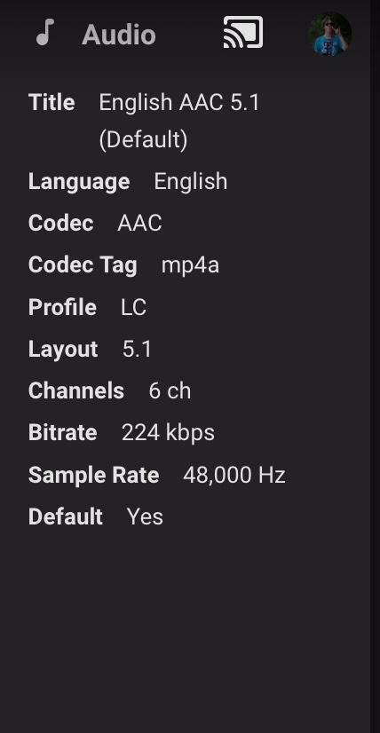

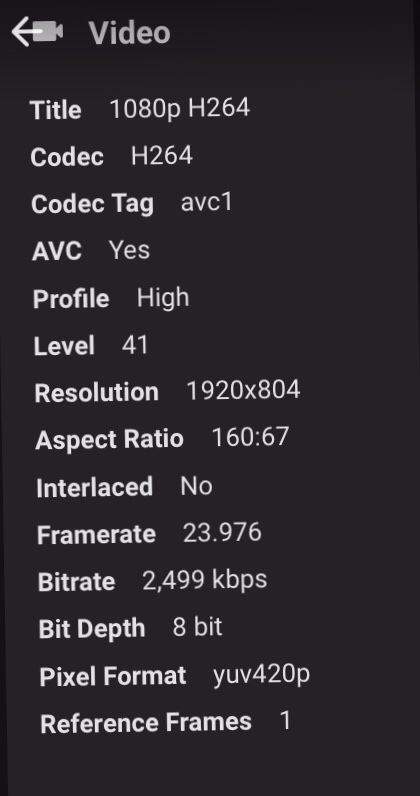

Carlo 4561 Posted August 6, 2021 Posted August 6, 2021 What does the whole media section look like for this at the bottom of the detail screen?
DSlacky 5 Posted August 6, 2021 Posted August 6, 2021 For the video I’m trying to play? Like the formatting? This?
DSlacky 5 Posted August 6, 2021 Posted August 6, 2021 (edited) All the containers I have are mkv and never been an issue before Edited August 6, 2021 by DSlacky
