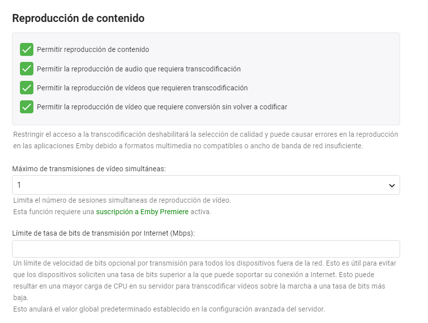

N0X 6 Posted August 5, 2021 Posted August 5, 2021 (edited) Saludos comunidad, tengo la siguiente problemática, tengo asignada 1 sola transmisión de vídeo simultáneas para las cuentas creadas y aun así me siguen reproduciendo con la misma cuenta mas de una. Edited August 5, 2021 by N0X

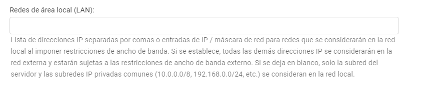

Carlo 4561 Posted August 5, 2021 Posted August 5, 2021 Not sure, but I think that's the key. It seems like this setting applies to external users that have an IP not in the local LAN.
N0X 6 Posted August 5, 2021 Author Posted August 5, 2021 In any case I do not think it matters if they are local or remote, the limitation of how many simultaneous reproductions you can have is in the account and it is not working correctly for me, there are two users that I see reproduced in two devices at the same time with limitation to one

N0X 6 Posted August 5, 2021 Author Posted August 5, 2021 3 minutes ago, cayars said: If you're the admin and the only local user why would you need this to work for local IPs? I never said that ... my problem is that some accounts are playing on two devices simultaneously when I have one assigned to them
N0X 6 Posted August 5, 2021 Author Posted August 5, 2021 It is a Premiere option and it is not working for me as it should

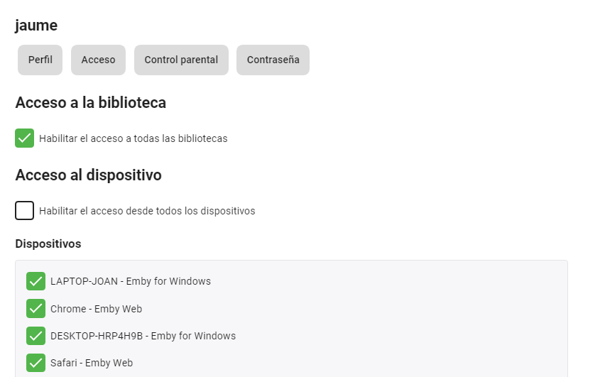

vdatanet 1619 Posted August 5, 2021 Posted August 5, 2021 (edited) Quote my problem is that some accounts are playing on two devices simultaneously when I have one assigned to them Can a user who is authorized on a single device log in on another? This should not be possible. Edited August 5, 2021 by vdatanet
Carlo 4561 Posted August 5, 2021 Posted August 5, 2021 You can set the user to only allow them to login on a specific device. You have to allow them to login 1 time first on the device, then you can lock them to just that device.

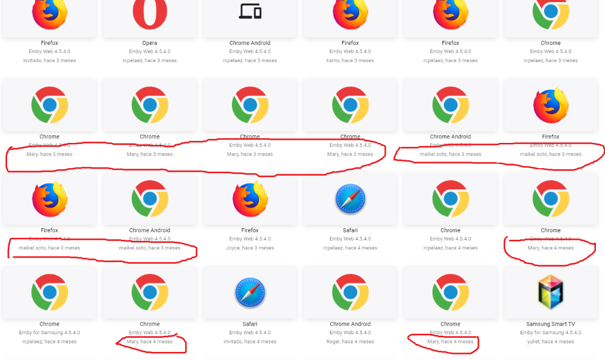

N0X 6 Posted August 5, 2021 Author Posted August 5, 2021 (edited) 8 minutes ago, cayars said: You can set the user to only allow them to login on a specific device. You have to allow them to login 1 time first on the device, then you can lock them to just that device. I can't do it ... the same account connects from the same device but on the emby server it comes out as several devices ... that's why I'm using the limitation of a single playback at a time Edited August 5, 2021 by N0X
N0X 6 Posted August 5, 2021 Author Posted August 5, 2021 (edited) blocking the account to a device is not an option for me The problem is the following: Why “Maximum simultaneous video transmissions” does not work at 100% that restriction is supposed to apply to the account Edited August 5, 2021 by N0X

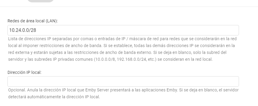

vdatanet 1619 Posted August 5, 2021 Posted August 5, 2021 (edited) 16 hours ago, N0X said: Saludos comunidad, tengo la siguiente problemática, tengo asignada 1 sola transmisión de vídeo simultáneas para las cuentas creadas y aun así me siguen reproduciendo con la misma cuenta mas de una. Quizás esta restricción, es como el limite de ancho de banda, solo se aplica a conexiones remotas. No se si podemos engañar al servidor para que considere todas la conexiones remotas con esta configuración de red. Suponiendo que tu red sea 192.168.1.x, quizás poniendo 192.168.1.5 en este campo, al dispositivo con IP 192.168.1.5 se le aplican las restricciones de conexiones remotas. No lo he usado nunca, pero quizás merece la pena experimentar. Edited August 5, 2021 by vdatanet
N0X 6 Posted August 5, 2021 Author Posted August 5, 2021 (edited) 9 minutes ago, vdatanet said: Quizás esta restricción, es como el limite de ancho de banda, solo se aplica a conexiones remotas. No se si podemos engañar al servidor para que considere todas la conexiones remotas con esta configuración de red. Suponiendo que tu red sea 192.168.1.x, quizás poniendo 192.168.1.5 en este campo, al dispositivo con IP 192.168.1.5 se le aplican las restricciones de conexiones remotas. No lo he usado nunca, pero quizás merece la pena experimentar. Lo tengo aplicado así ... pero como trato explicar mas arriba reiteradas veces ... esta restricción de la reproducción simultanea se aplica a la cuenta ... no se que tiene que ver con los ip ... se supone que limite la cantidad de reproducciones en los dispositivos que usen esa cuenta a la vez ... o sea ... dispositivos/cuenta ... no direcciones ... y aun asi ... ambos dispositivos vienen del mismo ip ... en uno de los dos casos que he notado esto tienen una laptop, en el otro es un router Edited August 5, 2021 by N0X
