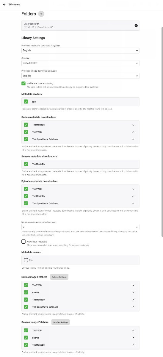

Happy2Play 9802 Posted August 5, 2021 Posted August 5, 2021 4 hours ago, Luke said: That naming should work. @Happy2Play are you able to reproduce? Worked fine in my test. Could this be a provider order? 12 hours ago, Samkook said: does emby keep logs for longer than a week? No Emby clears logs older then 3 day. This is configured in your system.xml. <LogFileRetentionDays>3</LogFileRetentionDays> What is the configuration of that library, enabled providers and provider order? 1

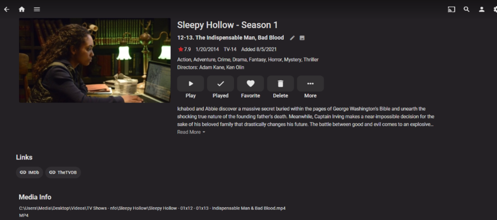

Samkook 18 Posted August 5, 2021 Author Posted August 5, 2021 Here are the settings for that library: I didn't think to test it before, but if I rename the files back to the 01x12 - 01x13 format, they are still detected properly so it looks like it was only the initial scan that had issue with those for some reason but I can't think of something I would have changed that could cause this.

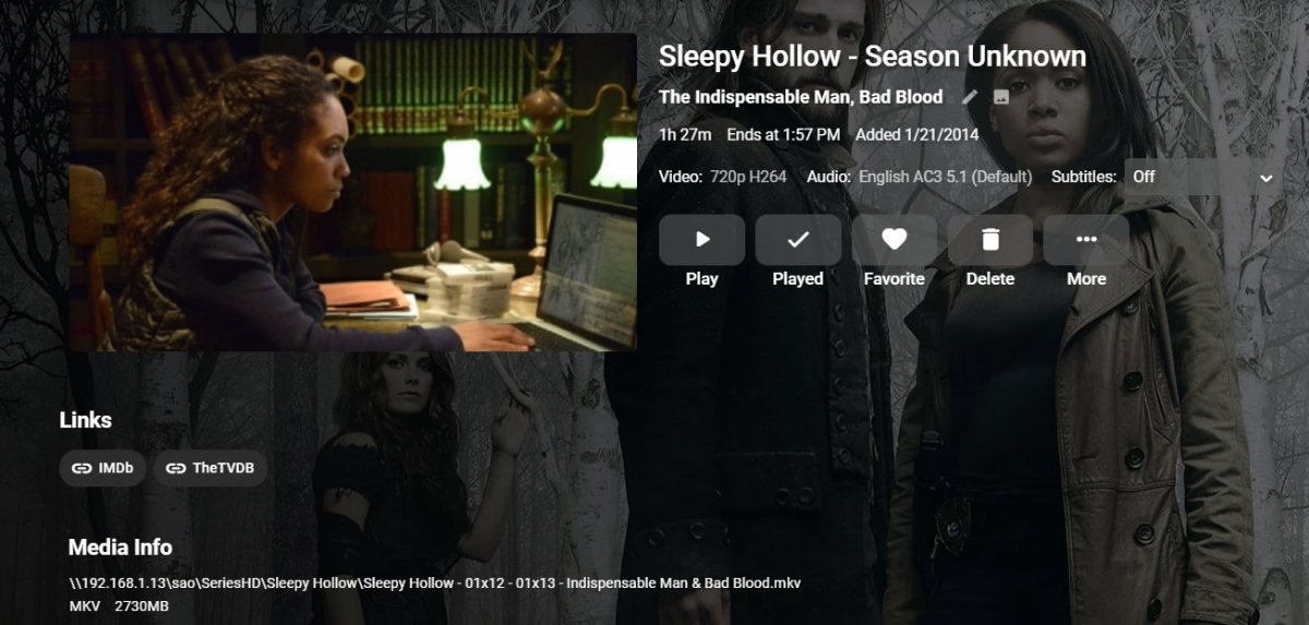

Samkook 18 Posted August 5, 2021 Author Posted August 5, 2021 Here's the infos for one that is still failed to be detected properly:
Happy2Play 9802 Posted August 5, 2021 Posted August 5, 2021 43 minutes ago, Samkook said: Here's the infos for one that is still failed to be detected properly: Is Emby providing metadata or is there existing metadata? From the image suggest missing metadata. But I had no issue using the same library settings and getting correct results.
