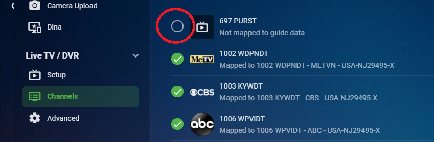

Carlo 4564 Posted August 3, 2021 Posted August 3, 2021 Remove the green check mark here to deactivate the channel.
Solution Chris442 3 Posted August 3, 2021 Author Solution Posted August 3, 2021 Ok, I see. I was on the Server Dashboard and didn't realize we could just "uncheck" a channel. I did that and then waited for the guide to refresh (watched the progress on the server dashboard) and then the upcoming recording schedule was updated and didn't show any upcoming recordings. I rechecked the channel and they didn't come back either! Great tip. Thank you!
