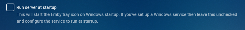

MBSki 1114 Posted August 2, 2021 Posted August 2, 2021 21 minutes ago, JustEric78 said: Unfortunately the service method does not work as this is what I see after a few minutes after the service starts, meaning it has no status. I think it just starts up the executable and that is it. Actually, as I just typed that it dawned on me that I bet I can just killed the executable. The button on the UI has worked for years though. Edit: Yeah killing the executable worked, but that is obviously not ideal. It's possible the executable was running, in which case the service wouldn't start. Do you have "Run at Server Startup" unchecked? Make sure that's unchecked and then start the service.
JustEric78 24 Posted August 2, 2021 Author Posted August 2, 2021 (edited) 3 minutes ago, mbarylski said: It's possible the executable was running, in which case the service wouldn't start. Do you have "Run at Server Startup" unchecked? Make sure that's unchecked and then start the service. Edit: writing that first line again as it could have been confusing. No, I do not have that checked, I have had this setup for years. There is nothing in the in the tray like showing the server is running, this is in the task manager. The EmbyServer executable is what the service starts up there. Edited August 2, 2021 by JustEric78
