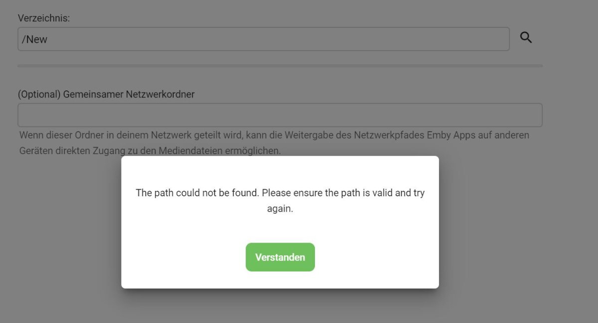

Kandidat1999 35 Posted August 1, 2021 Posted August 1, 2021 (edited) Hi, since space is slowly becoming an issue for my DS918+, I added a 5TB WD Hard Disk via USB on the NAS /usbshare1, I made it a shared Folder called /New, which is recognized easy via Plex or Infuse, but when I want to add the path of USB/Drive or now Folder New to an existing Library with /New , it says path is not recognized, but like I said Plex is finding it and Infuse as well, Emby is activated via Systemuser, which is now a new thing you have to do in DSM7, so I don´t find the error unless USB Mapping is not supported, but I can´t imagine this since it´s working in Plex and Infuse. Anybody with a solution ? all others 11 Libraries I use work fine and I already compared all the Settings from the Libraries that are recognized with the one /New Folder, they are all the same. Edited August 1, 2021 by Kandidat1999

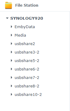

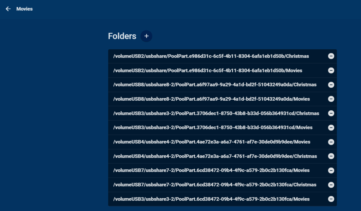

Carlo 4561 Posted August 1, 2021 Posted August 1, 2021 Hi, when you add the USB3 drives to Synology they should show up like this Then in Emby Server you can add them to a library like this You can ignore the "Poolpart" folder in each of the above folders as these drives were originally being used on Windows running Stablebit DrivePool. Does this help?

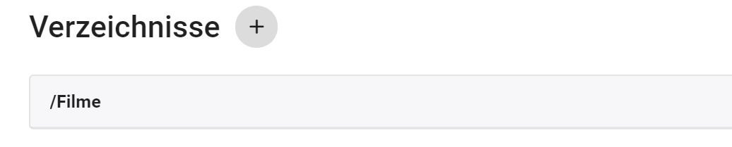

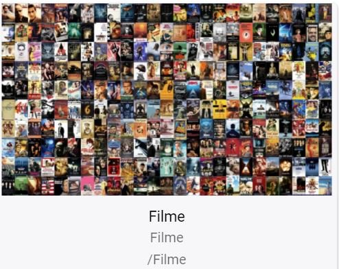

Kandidat1999 35 Posted August 1, 2021 Author Posted August 1, 2021 (edited) So this is the Library I already have , it´s Called "Filme" and is located under my NAS at /Filme this is the USB Share on my File Station Called "New" and 2 Subfolders "Film" and "Serie" This is inside the Library where I want to add the /New Folder and this is the error I get when I try to add /New to the "Filme Library Edited August 1, 2021 by Kandidat1999

Carlo 4561 Posted August 1, 2021 Posted August 1, 2021 It looks like you aren't selecting the volume "New" is associated with in the above pic. How many libraries do you have setup?

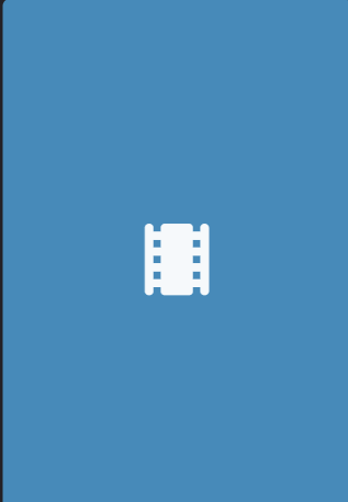

Kandidat1999 35 Posted August 1, 2021 Author Posted August 1, 2021 Ok I tried it again directly with the emby server app and this time it worked, took me forever to set it all up again ,but now I have it clean, I also had no problem adding the usb share this time one last thing though, I have a folder with my own homemade videos and for this videos, of course there will be no covers found, but what do I have to do to just see the the video thumbnail of each videos, all these videos look like this, but at least I would jsut see the plain look of the video thumbnail
Carlo 4561 Posted August 1, 2021 Posted August 1, 2021 Hi, is Screen Grabber enabled for this library?
Kandidat1999 35 Posted August 1, 2021 Author Posted August 1, 2021 No it wasn´t but now it is and now they are starting to show up, thanks for your quick help all day !!! 1
