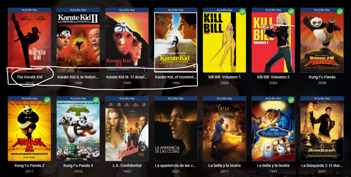

LeidenSpain 33 Posted August 1, 2021 Posted August 1, 2021 (edited) Hello again, I am finding that the movies are shown ordered by name, but "THE" is not taken into account when ordering them. It doesn't always happen to me, for example the "THE" in Spanish are sorted out well for me. I have not been able to find a pattern I am using Linux version 4.6.4.0. Regards Edited August 1, 2021 by LeidenSpain
Happy2Play 9802 Posted August 1, 2021 Posted August 1, 2021 The system.xml has SortRemoveWords. <SortRemoveWords> <string>the</string> <string>a</string> <string>an</string> <string>das</string> <string>der</string> <string>el</string> <string>la</string> </SortRemoveWords> You can shutdown Emby and make adjustments if you like, then start Emby and Refresh your Libraries reprocess the sort order. 2

LeidenSpain 33 Posted August 1, 2021 Author Posted August 1, 2021 3 minutes ago, Happy2Play said: The system.xml has SortRemoveWords. <SortRemoveWords> <string>the</string> <string>a</string> <string>an</string> <string>das</string> <string>der</string> <string>el</string> <string>la</string> </SortRemoveWords> You can shutdown Emby and make adjustments if you like, then start Emby and Refresh your Libraries reprocess the sort order. Thank you very much, this was just what I was looking for
