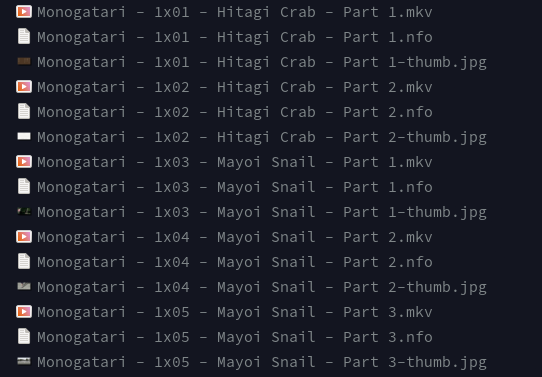

Meltx103 3 Posted July 28, 2021 Author Posted July 28, 2021 Thanks Luke. It seems to have worked for the most part, however, the order Emby plays the files in is wrong. It seems to pull this from another source rather than the local episode title names. For example, it wants to start the series with an episode from season 03 rather than S01E01. I have named each episode using this structure: Monogatari - 1x01 - Hitagi Crab - Part 1. For some reason Emby wants to start with Monogatari - 3x02 - Karen Bee - Part 2. Can I force it to use the local file names/order instead of other sources?

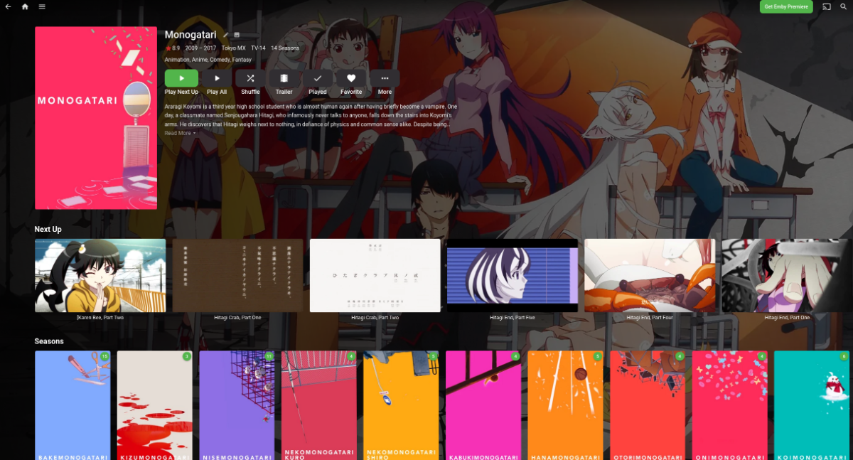

Meltx103 3 Posted July 28, 2021 Author Posted July 28, 2021 (edited) 13 minutes ago, cayars said: How/where are you trying to start playback? From the show's main page. Marking all episodes as seen/unseen does not alter it. Furthermore, going into each season there are episodes which are out of order. Edited July 28, 2021 by Meltx103

Meltx103 3 Posted July 28, 2021 Author Posted July 28, 2021 3 minutes ago, cayars said: What links are shown on the Series home screen for the meta-providers? I'm not sure what you're asking for. Could you be more specific? TVDB is the #1 for the library so presumably that is what it has used as a provider.

Meltx103 3 Posted July 28, 2021 Author Posted July 28, 2021 It is worth pointing out that I do not follow the order found on tvdb when naming the files. I have a preferable order which I created using the same naming scheme as you can see above and was hoping Emby would order them by this rather than matching with an online source.

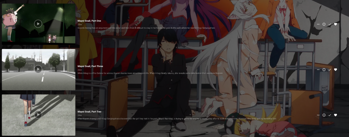

Carlo 4561 Posted July 28, 2021 Posted July 28, 2021 This pic is from The Simpsons on my system at the bottom of the series screen Do you have anything like that for this series?
Meltx103 3 Posted July 28, 2021 Author Posted July 28, 2021 Nothing like that exists in the web browser version for me (on this show).
