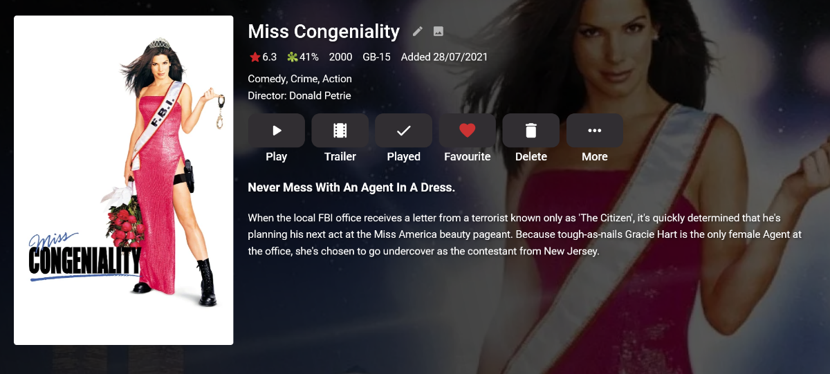

aptalca 71 Posted July 28, 2021 Posted July 28, 2021 Hi, I've been noticing a strange issue with most of the metadata missing when new movies are added to the database, but only on some items. I haven't been able to pinpoint the exact issue but it may have something to do with subtitles added by bazarr and the metadata being refreshed by emby's watcher. Here is all the info I have so far. 1. Yesterday at 6pm, movie added by Radarr, and a local nfo containing just the imdb and tmdb links present in the movie folder (generated by Radarr). 2. Scan triggered by the "real time monitoring". Log entries from initial scan below: 2021-07-27 17:59:38.245 Info LibraryMonitor: Movies (/crypt/Movies) will be refreshed. 2021-07-27 18:00:02.099 Info MediaProbeManager: ProcessRun 'ffprobe' Execute: /app/emby/ffprobe -i file:"/crypt/Movies/The Birthday Cake (2021)/The Birthday Cake (2021) Bluray-720p (the.birthday.cake.2021.720p.bluray.x264-woat).mkv" -threads 0 -v info -print_format json -show_streams -show_chapters -show_format -show_data 2021-07-27 18:00:03.707 Info MediaProbeManager: ProcessRun 'ffprobe' Process exited with code 0 2021-07-27 18:00:04.082 Info HttpClient: GET https://api.themoviedb.org/3/movie/tt10719958?api_key=f6bd687ffa63cd282b6ff2c6877f2669&append_to_response=casts,releases,images,keywords,trailers&language=en&include_image_language=en,null 2021-07-27 18:00:04.251 Info HttpClient: GET https://private.omdbapi.com?apikey=fe53f97e&i=tt10719958&plot=short&tomatoes=true&r=json 2021-07-27 18:00:04.380 Info HttpClient: GET https://api.themoviedb.org/3/movie/624481?api_key=f6bd687ffa63cd282b6ff2c6877f2669&append_to_response=casts,releases,images,keywords,trailers 2021-07-27 18:00:04.447 Info HttpClient: GET https://image.tmdb.org/t/p/original/kI3lTv3f24Fzl2kD0sYVCvCOZh2.jpg 2021-07-27 18:00:04.703 Info HttpClient: GET https://image.tmdb.org/t/p/original/f2EBHHOJs1eJJqR9sYYDhhB97gd.jpg 2021-07-27 18:00:04.794 Info HttpClient: GET https://webservice.fanart.tv/v3/movies/624481?api_key=5c6b04c68e904cfed1e6cbc9a9e683d4 2021-07-27 18:00:08.408 Info Trakt: Timer elapsed - Processing queued items 2021-07-27 18:00:08.408 Info Trakt: No events... Stopping queue timer 2021-07-27 18:00:11.583 Info HttpClient: GET https://raw.github.com/MediaBrowser/MediaBrowser.Resources/master/images/imagesbyname/studioposters.txt 2021-07-27 18:00:11.894 Info HttpClient: GET https://raw.github.com/MediaBrowser/MediaBrowser.Resources/master/images/imagesbyname/studiothumbs.txt 3. An hour later at around 7pm, Bazarr downloads a subtitle into the movie folder, which triggers a new scan by real time monitoring. Logs below: 2021-07-27 19:06:10.744 Info LibraryMonitor: Movies (/crypt/Movies) will be refreshed. 2021-07-27 19:06:43.525 Info MediaProbeManager: ProcessRun 'ffprobe' Execute: /app/emby/ffprobe -i file:"/crypt/Movies/The Birthday Cake (2021)/The Birthday Cake (2021) Bluray-720p (the.birthday.cake.2021.720p.bluray.x264-woat).mkv" -threads 0 -v info -print_format json -show_streams -show_chapters -show_format -show_data 2021-07-27 19:06:44.607 Info MediaProbeManager: ProcessRun 'ffprobe' Process exited with code 0 4. When I check Emby later, I noticed that the Movie name, the thumb, the fanart and the 3 external links (imdb, tmdb and trakt) are in there. However, everything else is missing. No actors, rating, studios, genre, overview, year, etc. When I click on "edit metadata", the only things populated are: title, original title, date added, and external ids (imdb and tmdb). If I do "refresh metadata", everything gets populated just fine. This happened a few times recently. It may have seemed to me like after the initial scan everything gets populated, but after a rescan triggered by an external subtitle addition later may cause most things to get reset (although I can't be sure, my memory isn't as good as it used to be). It's possible that even after the initial scan, most things are missing. I need to watch it closely next time to confirm. Any ideas? I'm on the latest stable Emby running in a docker container: 2021-07-28 00:00:00.015 Info App: Application version: 4.6.4.0 2021-07-28 00:00:00.017 Info App: Emby Command line: /app/emby/EmbyServer.dll -programdata /config -ffdetect /app/emby/ffdetect -ffmpeg /app/emby/ffmpeg -ffprobe /app/emby/ffprobe -restartexitcode 3 Operating system: Linux version 5.4.0-80-generic (buildd@lcy01-amd64-030) (gcc version 9.3.0 (Ubuntu 9.3.0-17ubuntu1~20.04)) #90-Ubuntu SMP Fri Jul 9 22:49:44 UTC 2021 Framework: .NET Core 3.1.13 OS/Process: x64/x64 Runtime: app/emby/System.Private.CoreLib.dll Processor count: 4 Data path: /config Application path: /app/emby 2021-07-28 00:00:00.017 Info App: Plugins: Bluray Folder Support 1.0.0.0 Cinema Intros 1.0.38.0 Dlna 1.0.69.0 Dvd Folder Support 1.0.0.0 Fanart.tv 1.0.13.0 MovieDb 1.4.7.0 MusicBrainz 1.0.17.0 Nfo Metadata 1.0.56.0 OMDb 1.0.14.0 Open Subtitles 1.0.28.0 Port Mapper 1.0.6.0 Studio Images 1.0.3.0 TheAudioDb 1.0.14.0 TheTVDB 1.0.41.0 Trakt 3.5.1.0 Webhooks 1.0.15.0 Thanks

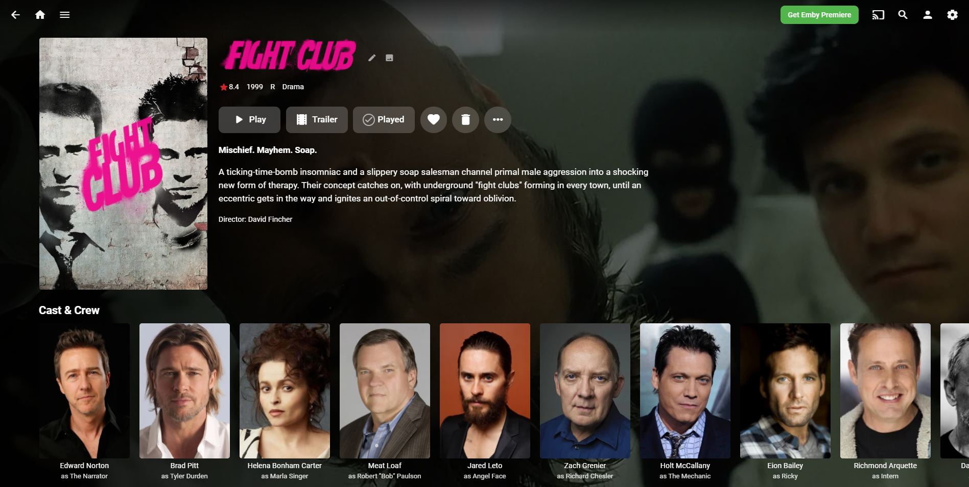

aptalca 71 Posted July 29, 2021 Author Posted July 29, 2021 (edited) @LukeGood news, I've been able to reproduce the issue with a lot more accuracy. Here are the steps: 1. Add a movie to library with a url only nfo (in my case 2 urls, one for imdb and one for tmdb) 2. Auto scan picks it up correctly and retrieves all metadata correctly (confirmed in the gui) 3. Add an external srt file 4. Auto scan picks it up and refreshes, most of the metadata disappears. Only the title, images and the external links remain. The only files in the media folder are the mkv, url only nfo and the newly added srt subtitle. $ ls -al total 3886350 -rw-rw-r-- 1 aptalca aptalca 82887 Jul 29 12:06 'Happily (2021) Bluray-720p (Happily.2021.720p.BluRay.x264-JustWatch).en.srt' -rw-rw-r-- 1 aptalca aptalca 3979538800 Jul 29 08:47 'Happily (2021) Bluray-720p (Happily.2021.720p.BluRay.x264-JustWatch).mkv' -rw-rw-r-- 1 aptalca aptalca 76 Jul 29 08:58 'Happily (2021) Bluray-720p (Happily.2021.720p.BluRay.x264-JustWatch).nfo' $ cat Happily\ \(2021\)\ Bluray-720p\ \(Happily.2021.720p.BluRay.x264-JustWatch\).nfo https://www.themoviedb.org/movie/673319 https://www.imdb.com/title/tt9849004 I hope this is enough info for you guys to reproduce as well. EDIT: Just confirmed with two more movies. Initial scan, all is well. After external sub is added, auto scan removes most of the metadata. FINAL EDIT: I can also repeatedly reproduce it by adding more external subtitles. Each time I add a new subtitle to an existing movie, metadata disappears and a manual metadata refresh brings it back. Edited July 30, 2021 by aptalca 1

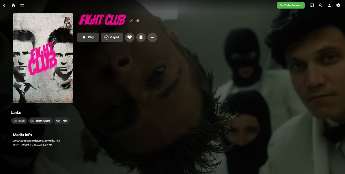

aptalca 71 Posted November 7, 2021 Author Posted November 7, 2021 @Luke Sorry to be a pest, but was this ever confirmed as a bug? I can confirm it is still happening on the latest beta every time an external subtitle is added to a movie with a url only nfo. Here's the easiest way to reproduce (via docker, all sandboxed in a test environment), just a quick few steps: 1. Create a docker container and exec into it: docker run -d --rm --name emby -p 8096:8096 emby/embyserver:beta docker exec -it emby sh 2. Create fake movie folders and files, and create a url only nfo with an imdb link: mkdir -p /test/testmoviefolder touch /test/testmoviefolder/testmoviefile.mkv echo "https://www.imdb.com/title/tt0137523/" > /test/testmoviefolder/testmoviefile.nfo 3. Open the gui on port 8096, go through the wizard, add a movie library with the folder "/test" added, don't change any other library settings. Leave everything default. 4. Log in and see "Fight Club" with all the metadata: 5. Go back to docker container shell and create a fake external subtitle: touch /test/testmoviefolder/testmoviefile.en.srt 6. Wait a couple of minutes for emby to pick it up and watch most metadata vanish: Thanks
