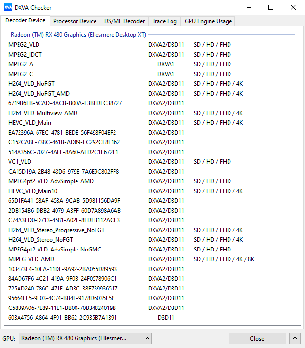

ProudlyTM 0 Posted July 29, 2021 Author Posted July 29, 2021 2 hours ago, softworkz said: OK, thanks (as Nvidia has started to use those 'RX' letters, I had assumed that RX 480 was just a typo.. ) Next steps: Please download DxvaChecker from here: https://bluesky-soft.com/en/DXVAChecker.html Run it Check whether it crashes or shows some useful information . Please activate debug logging in Emby server Restart Re-Activate your GPU and reproduce the error (now with a much bigger log) Thanks, softworkz I ran DXVA Checker and it didn't crash. I'm not sure if it will be useful info for you, but I've attached a screenshot of the default tab that the app starts with (Decoder Device). I've also attached the new log with debug logging enabled from the server settings. embyserver.txt
softworkz 5129 Posted July 29, 2021 Posted July 29, 2021 Thanks for your results. I had forgotten that the debug information from codec detection doesn't got into the main log, it goes into the hw detection log which never gets written due to the app crash. Let's try something else. Could you please take a look into the Application and System event logs and see whether there are entries about the app crash? Please collect all information you can find and to which the even log entry might link to. You can also send it to me via PM instead of posting publicly. Open the Emby cache folder. You can see the path to it on the server dashboard main page In the subfolder 'ffmpeg' and there should be a file named 'hwaccels_4.6.0.4.txt' Open the file, remove the line containing 'd3d11va' and save Start Emby Server This time, it should skip D3D11VA detection
ProudlyTM 0 Posted July 29, 2021 Author Posted July 29, 2021 2 hours ago, softworkz said: Open the Emby cache folder. You can see the path to it on the server dashboard main page In the subfolder 'ffmpeg' and there should be a file named 'hwaccels_4.6.0.4.txt' Open the file, remove the line containing 'd3d11va' and save Start Emby Server This time, it should skip D3D11VA detection Hmm.. That seems to have fixed it
