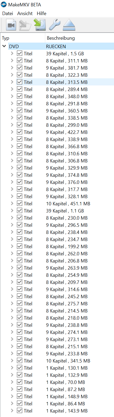

Florian2000 17 Posted September 10, 2021 Posted September 10, 2021 1 hour ago, rbjtech said: The conversion tools (makemkv etc) will import any defined chapters - and emby will present these to you. The conversions may alternatively create x number of separate files. It depends how the DVD/BR was created. As an example - if the dvd/BR had 7 chapters to select via the menu - then emby may show this as one 'show' with 7 chapters - OR it may show it as 7 files instead which is a bit more tricky for emby to 'show' in a 'menu' but depending on file naming, can be easily achieved as 7 'episodes'. I just tried "makemkv" for movie dvds/blue-ray. I think it is a quite good solution. And the main film is still there with all languages and subtitles. So this is really fine. Now I have to try it for a workout dvd with lot's of chapters if this is kind of useably in the end. Will tell you later.

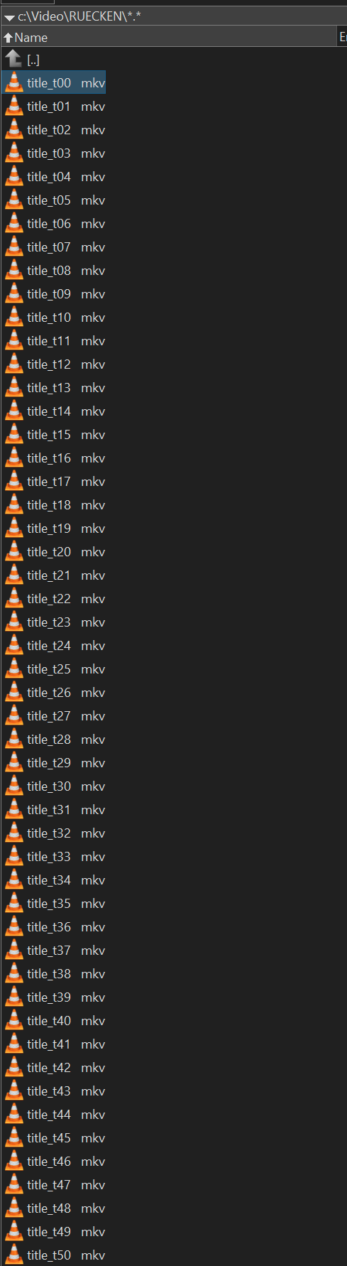

Florian2000 17 Posted September 10, 2021 Posted September 10, 2021 ok, let's say DVDs with structures were a lot of small video files are included (and also sub-menues and so on)...it's pretty not possible to get it transfered in a nice way.
rbjtech 5335 Posted September 10, 2021 Posted September 10, 2021 It may need manual work - on that I agree - but all 'jump' points on DVD/BR's are defined chapters - so it's just a matter of understanding what 'make mkv' did and picking the correct items. If you have an example (maybe take a screen shot from what makemkv lists?) then we may be able to give examples of how best to name that for emby to give a 'menu like' view.

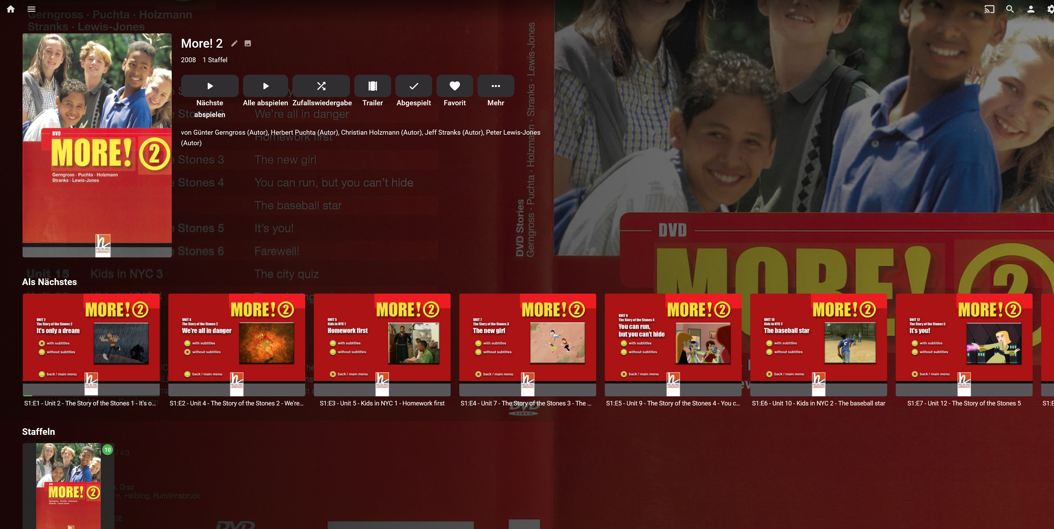

rbjtech 5335 Posted September 10, 2021 Posted September 10, 2021 (edited) oh wow ok - a lot of small videos. So on the DVD/BR menu - you could select any one of these 'videos' and play it yes ? The only way emby is going to be able to reproduce that - is to rename those files into something more meaningful (using a Bulk rename app) and then let emby pick them up as 'episodes' as part of a TV series 'folder'. (rename the tXX as eXX for episode). What you can't automatically do is create meta-data for each one - and with 50 of them, manually doing that it is going to be intensive. The thumbail will be auto generated for you. I guess you need to decide if it's worth the effort - but unfortunately, this is probably the worst type of DVD/BR you can get for reproduction in Emby If the disk had 1 or 2 MKV's - but then split into 50 'chapters' - with names - then it would have been MUCH easier. Edited September 10, 2021 by rbjtech

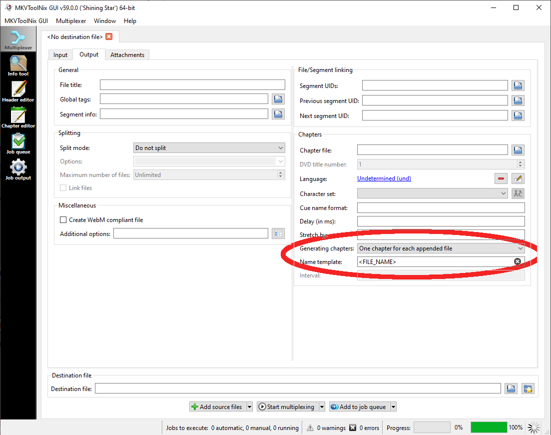

roaku 842 Posted September 10, 2021 Posted September 10, 2021 For a lot of these types of short videos that are related, I've used MKVToolNix to combine them into one long video, and used its chapter capabilities to give each chapter the title from its original short video. I can then use Emby's chapter list under the movie view to select the chapter to start playback from. For a P90x type workout disc set, I've used the TV series approach like rbjtech mentioned above. 1
rbjtech 5335 Posted September 10, 2021 Posted September 10, 2021 23 minutes ago, roaku said: For a lot of these types of short videos that are related, I've used MKVToolNix to combine them into one long video, and used its chapter capabilities to give each chapter the title from its original short video. I can then use Emby's chapter list under the movie view to select the chapter to start playback from. For a P90x type workout disc set, I've used the TV series approach like rbjtech mentioned above. Nice ! - Does mkvtoolnix do anything flash like auto generate the chapter timings for you ?
roaku 842 Posted September 10, 2021 Posted September 10, 2021 (edited) 19 minutes ago, rbjtech said: Nice ! - Does mkvtoolnix do anything flash like auto generate the chapter timings for you ? Yep. Name the individual files with the desired title for each one, then set the Output tab to have the circled chapter settings. toolnix will turn each filename (without extension) into a chapter title with the correct timeline for its spot in the aggregated video. Edited September 10, 2021 by roaku 1
rbjtech 5335 Posted September 10, 2021 Posted September 10, 2021 Awesome @roaku - I never knew that function was there ! So the OP has a couple of options here, but I think as the individual small MKV's already have multiple chapters (according the screen shot above) - then it's probably best to go with the 'episode' approach. If they didn't, then the combine and chapter approach is now certainly much easier. Nice !
