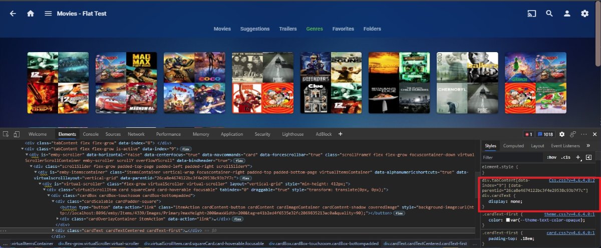

Guest Posted July 26, 2021 Posted July 26, 2021 Hi, This is complex to explain, but I'll try. I have EmbyServer Beta testing installed on a local pc. In it, your code worked perfectly. I have EmbyServer Stable installed on a VPS. In it, the same code did not work. I leave the images to try to help solve this mystery. Thank you from now on.
Happy2Play 9811 Posted July 26, 2021 Posted July 26, 2021 4 minutes ago, CarlosLima said: Hi, This is complex to explain, but I'll try. I have EmbyServer Beta testing installed on a local pc. In it, your code worked perfectly. I have EmbyServer Stable installed on a VPS. In it, the same code did not work. I leave the images to try to help solve this mystery. Thank you from now on. Did you change the "data-parentid=xxxxxxxxxxx" on the VPS server as the library id is unique per server?
Happy2Play 9811 Posted July 26, 2021 Posted July 26, 2021 4 minutes ago, CarlosLima said: Yes, of course. Minus code errors it is hard to say. What does the console show?

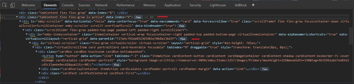

Guest Posted July 26, 2021 Posted July 26, 2021 Now it got more sinister. See the elements of my server on the VPS, greatly reduced compared to yours.
Guest Posted July 26, 2021 Posted July 26, 2021 (edited) And more curious now. When logging into vps and opening Emby, the code works. If I log into Emby remotely from my local pc, the code doesn't work. I cleaned only navigation data on the VPS and on the local pc and the same result. Edited July 26, 2021 by CarlosLima
Happy2Play 9811 Posted July 26, 2021 Posted July 26, 2021 3 minutes ago, CarlosLima said: Now it got more sinister. See the elements of my server on the VPS, greatly reduced compared to yours. You just haven't selected a specific element as I did. I am in the expanded "mainAnimationPages" section vs you just opening the console. Don't know anything about VPS but would not think it is any different then a any other server.
Happy2Play 9811 Posted July 26, 2021 Posted July 26, 2021 10 minutes ago, CarlosLima said: Is this expanded area you referred to? Yes that would tell me data-index=4 with a data-parentid= 73a784e72cb318e2fdaaf86447fc673d, but you need to go down a little further to the cardtext section.
