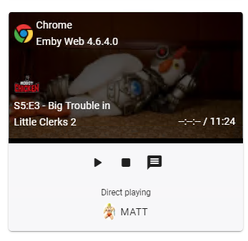

rexerm 36 Posted July 22, 2021 Posted July 22, 2021 Some -- but not all -- video files with VC-1 streams seem to cause transcoding to crash if I have hardware acceleration turned on. You can see in the attached log that even writing to the log stops mid-sentence. On the dashboard, I will see what's pictured in screenshot below. In Task Manager, I see that it will consecutively spawn 3 ffmpeg processes. Eventually, Emby will give up and report a "No compatible streams available" error. However, the 3 ffmpeg process will remain. Even if I reboot Emby, they remain and need to be manually ended (or the server completely rebooted). If I don't do this and continue to play affected VC-1 videos, it will continue to spawn these processes and eventually eat up 100% of the CPU. No GPU installed, just a Intel UHD Graphics 630, so I'm wondering if that is the main problem. My solution is to turn off HA for VC-1 codecs in the advanced transcoding menu, which seems to completely fix the issue. Running a test right now to see if the slowdown from turning this off with affect a longer movie. I'm not sure if this affected prior versions, as I never played these particular files until recently. Files were ripped from my own blu-ray and are in a standard MKV container. ffmpeg-transcode-04e67547-4a6c-43f8-bef5-1aa1ae26ef97_1.txt
