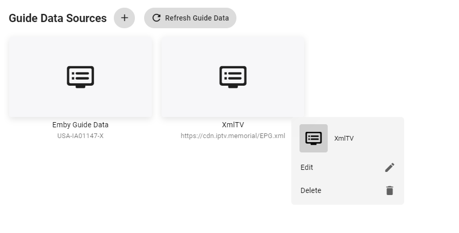

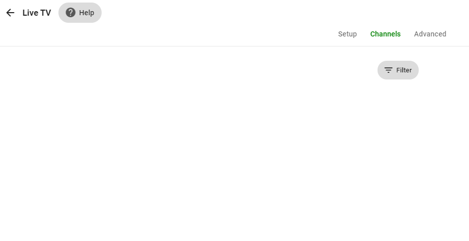

pinkfamily7 3 Posted July 21, 2021 Posted July 21, 2021 In server config, it appears that my "Channels" tab is empty: I've tried mapping channels (I've done this before, but I added some new channels, so wanted to add them to the mapping), but it appears that there is no longer a "Map Channels" option in 4.7.0.3 beta-- not on the Guide Data Sources nor the Tuners themselves. If I click "edit" there is no option there to map channels either, that I can see. I've removed my iptv source and re-added it to no avail. I guess I should also point out that my cable guide (USA-IA01147-X) does appear to be mapping correctly (although I also can't map that source either.)
Luke 43428 Posted July 21, 2021 Posted July 21, 2021 Hi, channel mapping happens in the channels tab, so it looks like your channel sources don't have any channels. Please check on that.
pinkfamily7 3 Posted July 21, 2021 Author Posted July 21, 2021 My Channels tab (in Emby proper, not settings) shows the Live TV channels: The Channels tab in settings is blank:
Carlo 4563 Posted July 21, 2021 Posted July 21, 2021 Hi, That's very strange. Could we do a remote session to allow us to take a look at this for you?
pinkfamily7 3 Posted July 21, 2021 Author Posted July 21, 2021 Issue was caused by the XMLTv URL link expiring/going to a 404. Cayars helped me work around that. That said, it should probably be considered a bug that the entire channels tab breaks if one of your guide sources is invalid. (The other source was valid, yet still not showing up on the channels tab.)
Carlo 4563 Posted July 21, 2021 Posted July 21, 2021 Agree, @Luke can you take a look at this. Try testing with any type of tuner but then put in a XML guide that returns a 404 error. In this case the setup Channel List vanished but the channels still work from the main UI.
